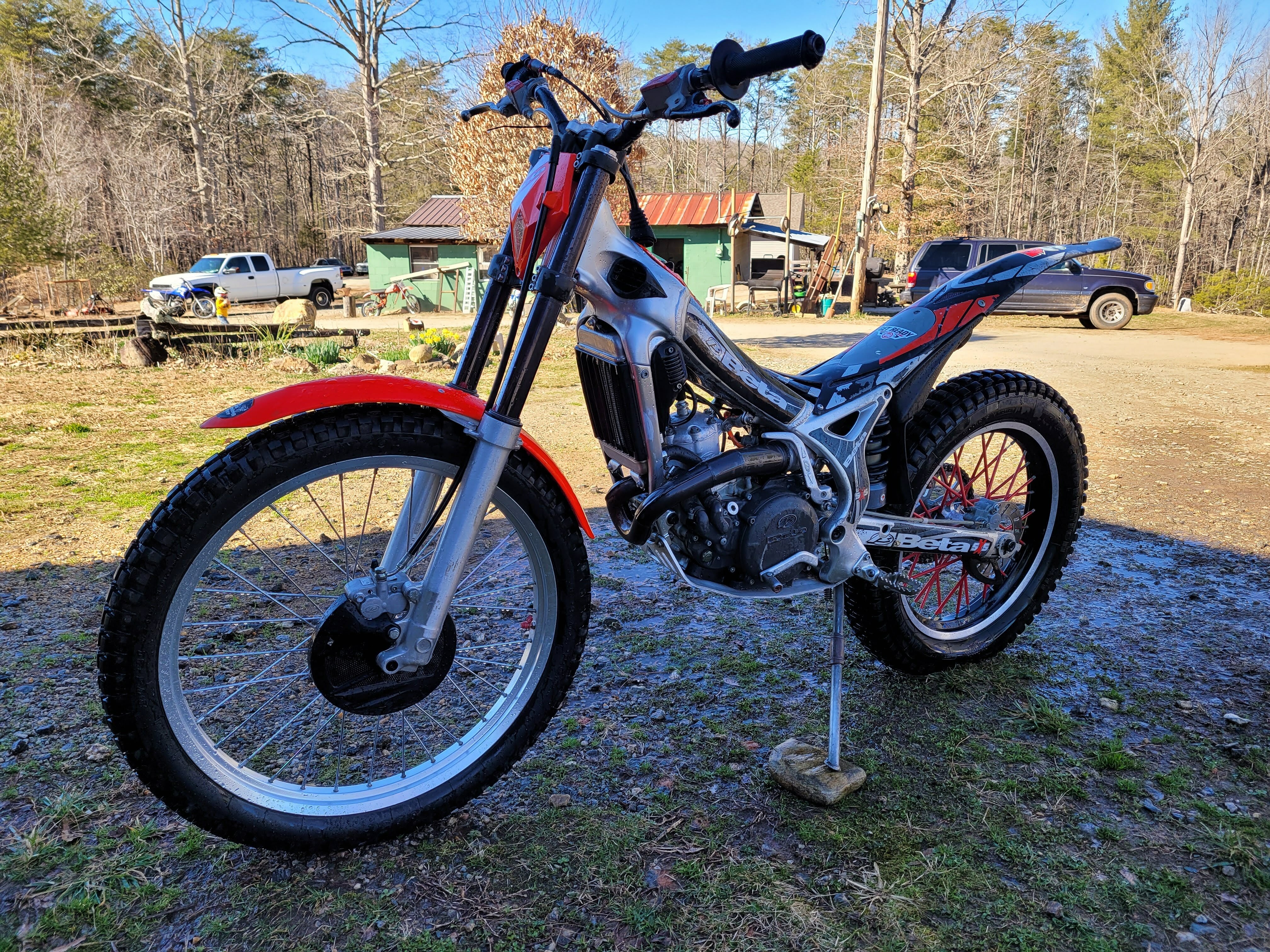

I have a 08 Beta 125. Runs perfect... untill you put it nose down or nose up. It then changes idle and fouls a plug. Within a matter of seconds. Any ideas?

I'd check the float height
Yes, that is on my to do list today. Someone else looked at it and said it was okay, but ill look for myself.
Wasn't the float.
I adjusted it to spec and it still fouled.
I think it has something to do with there being a breather hole in the float chamber, which lets neat fuel into the engine, when the angle of the carb is tilted forwards.   Maybe this could be modified, or blocked up, but the float chamber still needs to be ventilated somehow.
