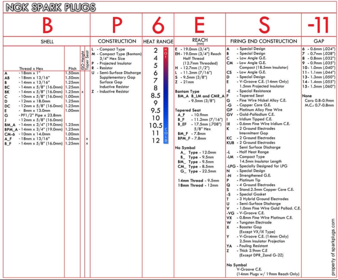

Hi, I have bought a NGK BPR6EIX-11 as a spare for my 2017 TXT250 I think I made an error as I needed BPR6EIX, that's what is in the bike now. The 11 I believe relates to the electrode gap being 1.1mm where as if there is no number after the X it relates to a 0.7-0.8mm gap, see attached. My question is, can I not just adjust the gap myself?  0.3-0.4mm is not much to move the end tab earth that the spark jumps across to.
Having just checked the manual 0.6-0.7mm is the gap required for my model.
Thanks for your help.
Edited by CJS
Better picture
yep, get some feeler gauges, and tap that electrode on something solid.
I always check the gap of my plugs and adjust as necessary.
Great, thanks 👍
