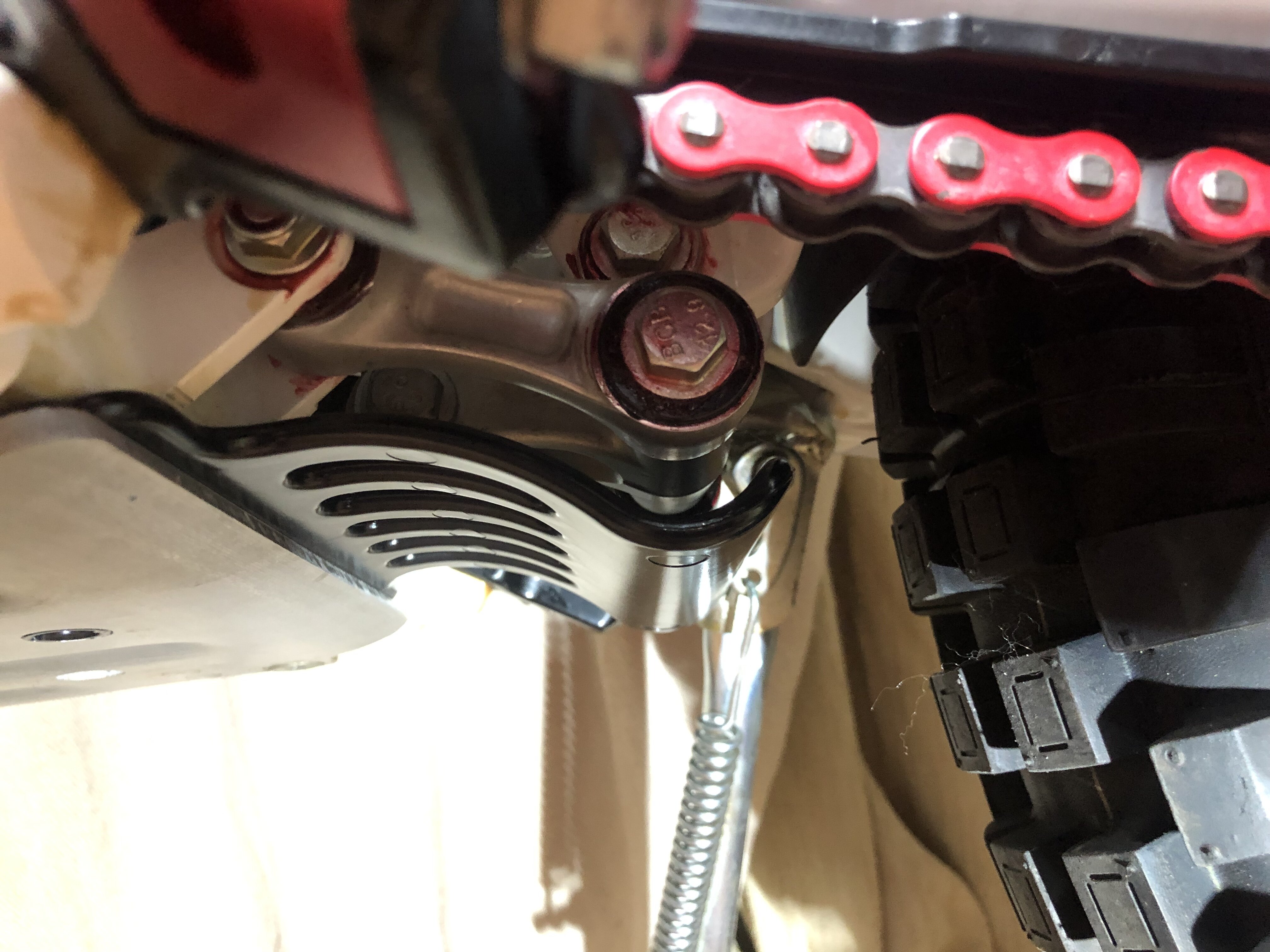

Has anyone fitted one of these Jitsie rear suspension linkage guards?  What does it attach to - rear engine bolt? and under sumpguard? and has anyone fitted one to a newer Evo (2020 4T)

I just had a look under my 2010 evo 4t 250.... I can't see any obvious place except perhaps onto the linkage bolts themselves - not sure how far between the sides of the bracket on your guard, but they look quite large diameter holes, so maybe?
Gas gas one goes between sump guard and frame if that helps

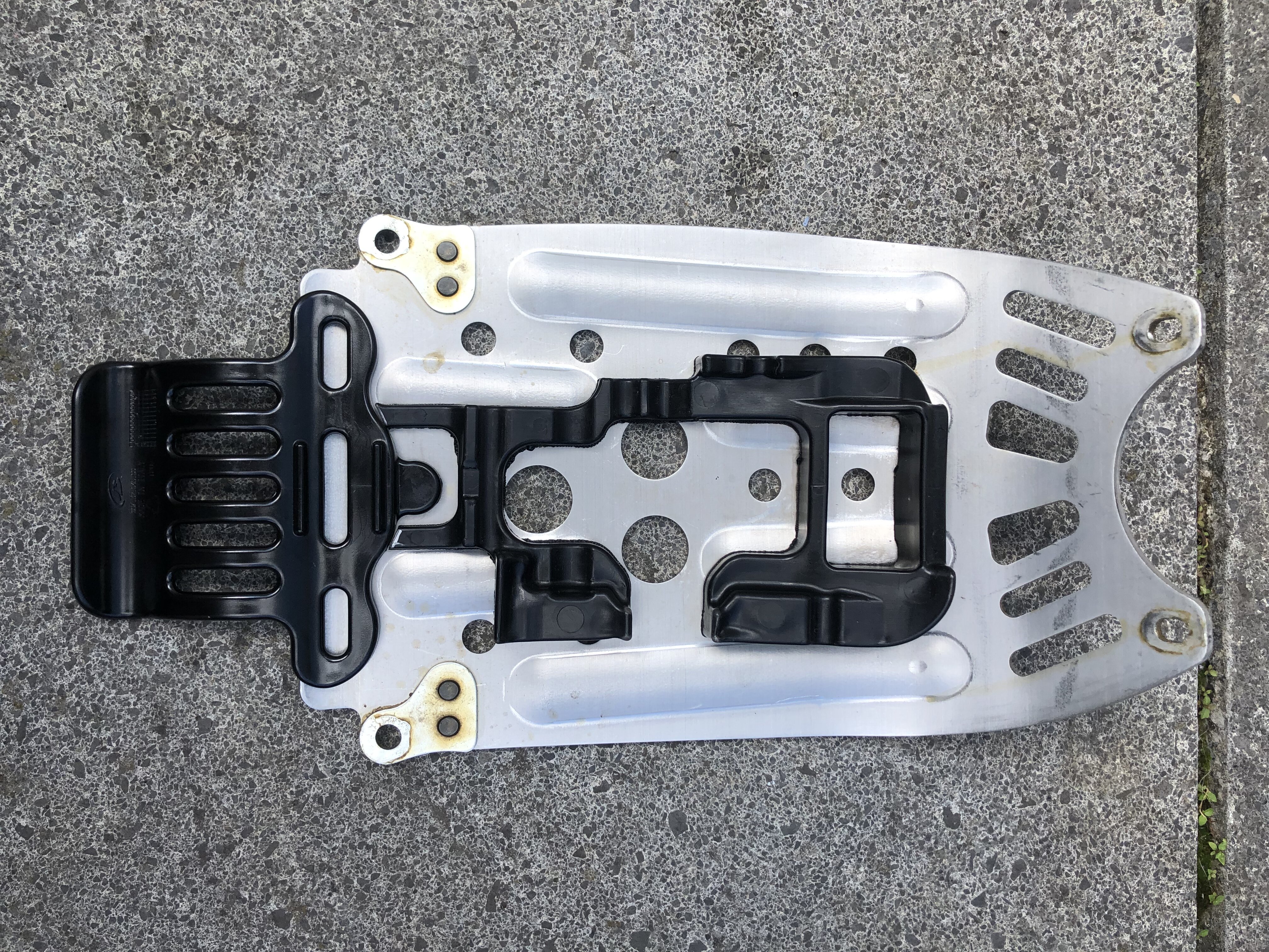

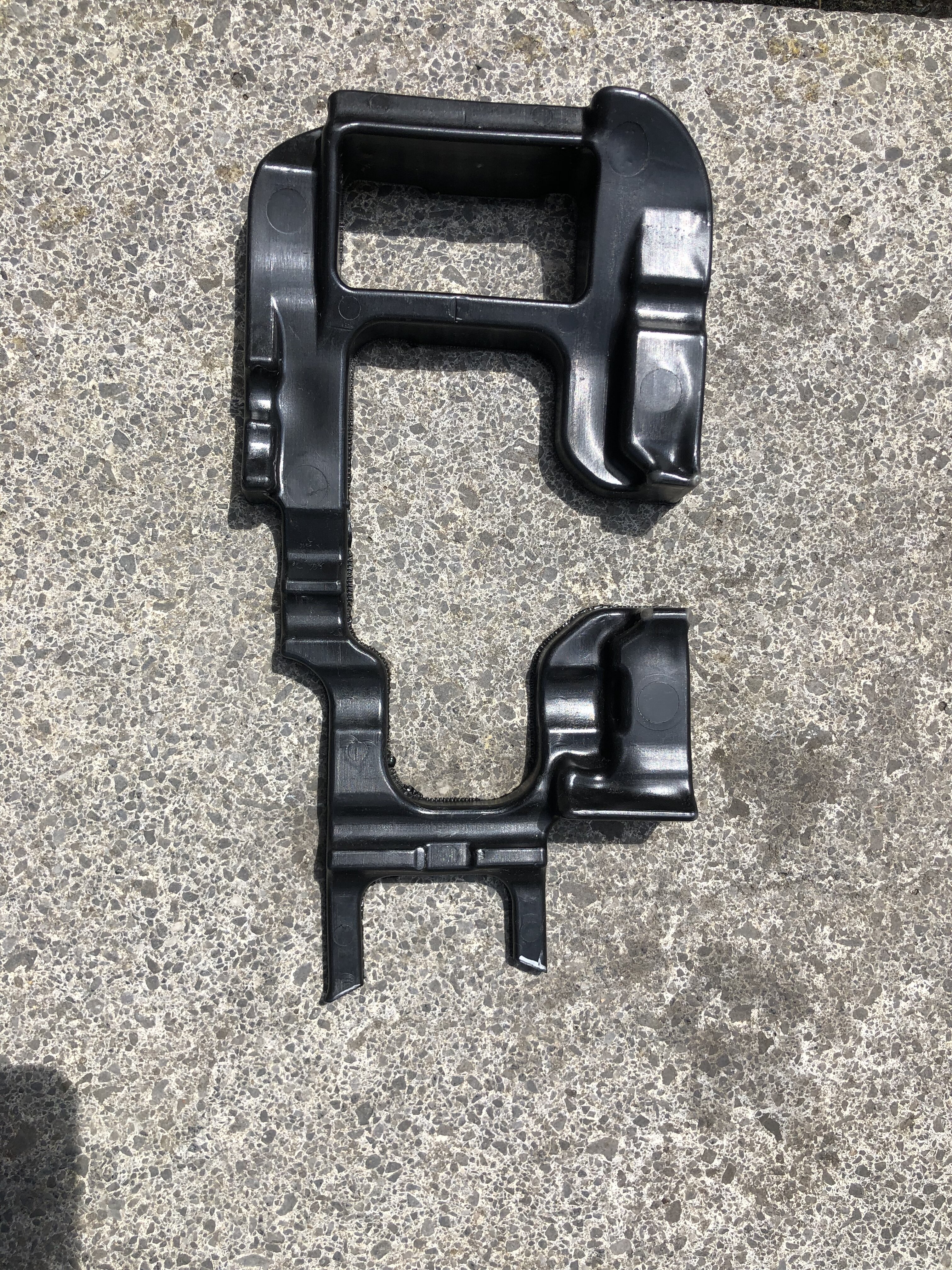

Good old cable ties. I gave up in the end and bought a genuine Beta one (£9.75) that’s for 2T but fits straight onto 4T only had to trim a piece off rear of rubber cushion between sumpguard and engine.
