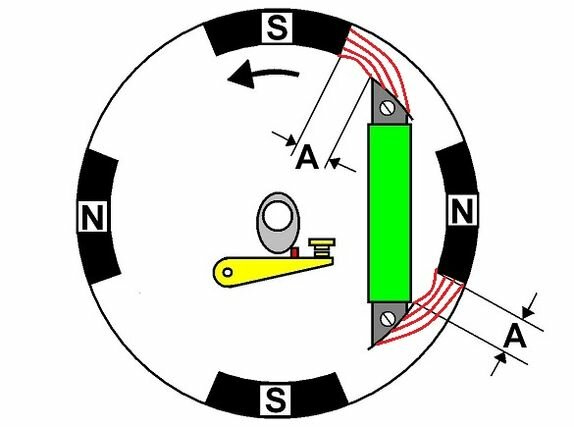

Not only points gap and timing must be correct, also distance A in picture must be correct. If points for some reason not is correctly made for the engine/flywheel you may end up with a weak spark or no spark at all. Make sure points are within original manufacturers spec.
When I ordered the points for this bike, I think they had to substitute part numbers to get anything.  So I will be doing my best to match up old to new.   And thanks for the nice diagram, although I do have good spark, just not exactly at the right instant in time.

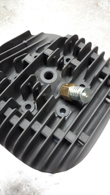

If its kicking back the timing is too advanced. They are not the easiest bike to start because the kickstart shaft is so high up. I'm only 56 but my right knee is not too good, fitting a decompressor into the cylinder head has helped me starting mine mine a great deal.
Edited by jon v8
Jon v8- I could do that with what I have in the shop. I guess there is a cable up to the handlebars?  And where did you find this part?  - Luckily I now own a new 14mm x 1.25 tap so it should be pretty easy to fit if everything else is available.  Thanks very much for the idea anyway!    BTW- with the timing as it is right now it will just kick back maybe once before it decides to start up, so since the new shouldered washer was installed, the timing is much closer to being right.
