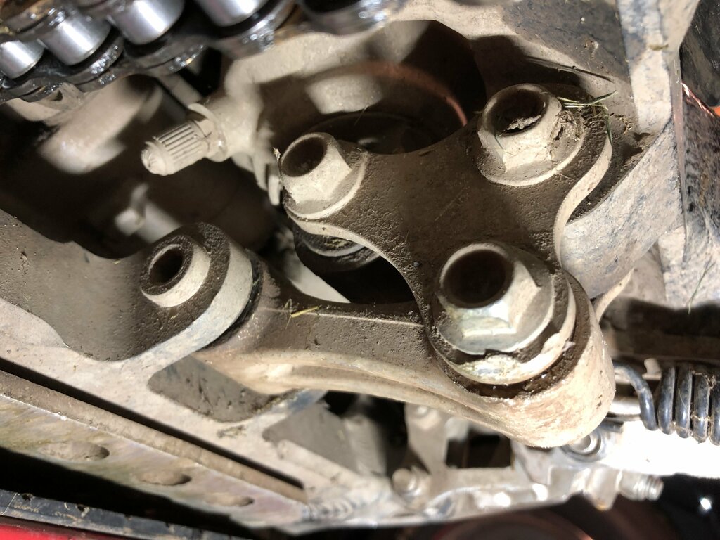

September 14, 20215 yr Hello all, ive got some play at the rear dogbone bearing/ bushing (lower right on the picture) ive ordered a rear swinging arm bushing / bearing kit. ive not done this before - has anyone got a few minutes to outline the steps involved. once the dogbone out - I have a socket / bearing puller set to get the old bearings out. am I aiming to just remove the suspension gear with the swinging arm in situ? Or does the whole swinging arm come off. And are there tips and suggestions to make it easier ? thanks in advance !

September 21, 20215 yr Author In the end I did eveything. Swinging arm out and regreased etc. The Bungies trick to carry the arm was a neat one. was quite a bit of forward a bit back a bit with the new bearings to make the same gap either end for the dust seals (prob a suitably sized washer would’ve helped) but got there in the end.
