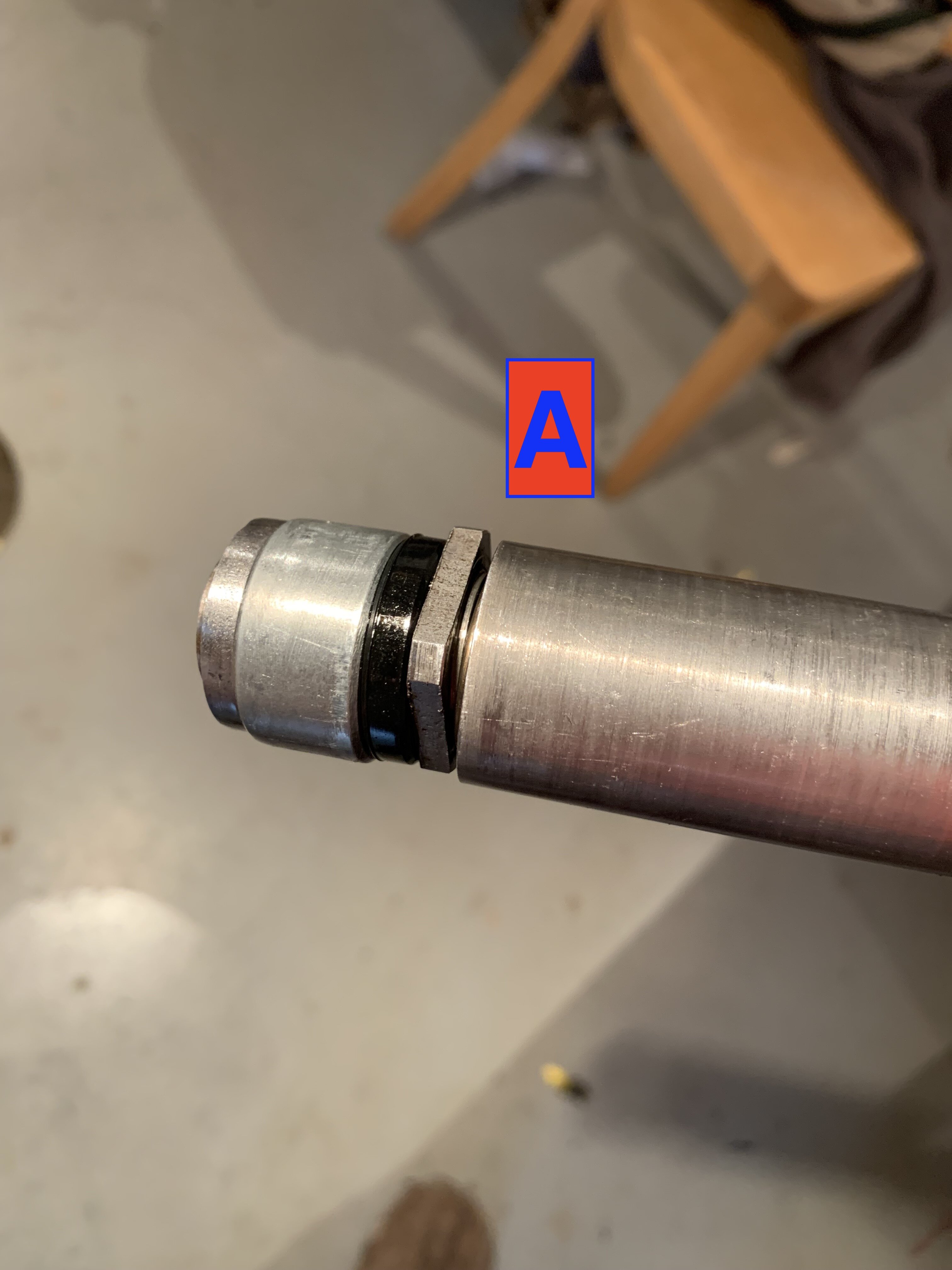

In photo A the internal spacer cover the small spring, and therefor the spring can't compress.

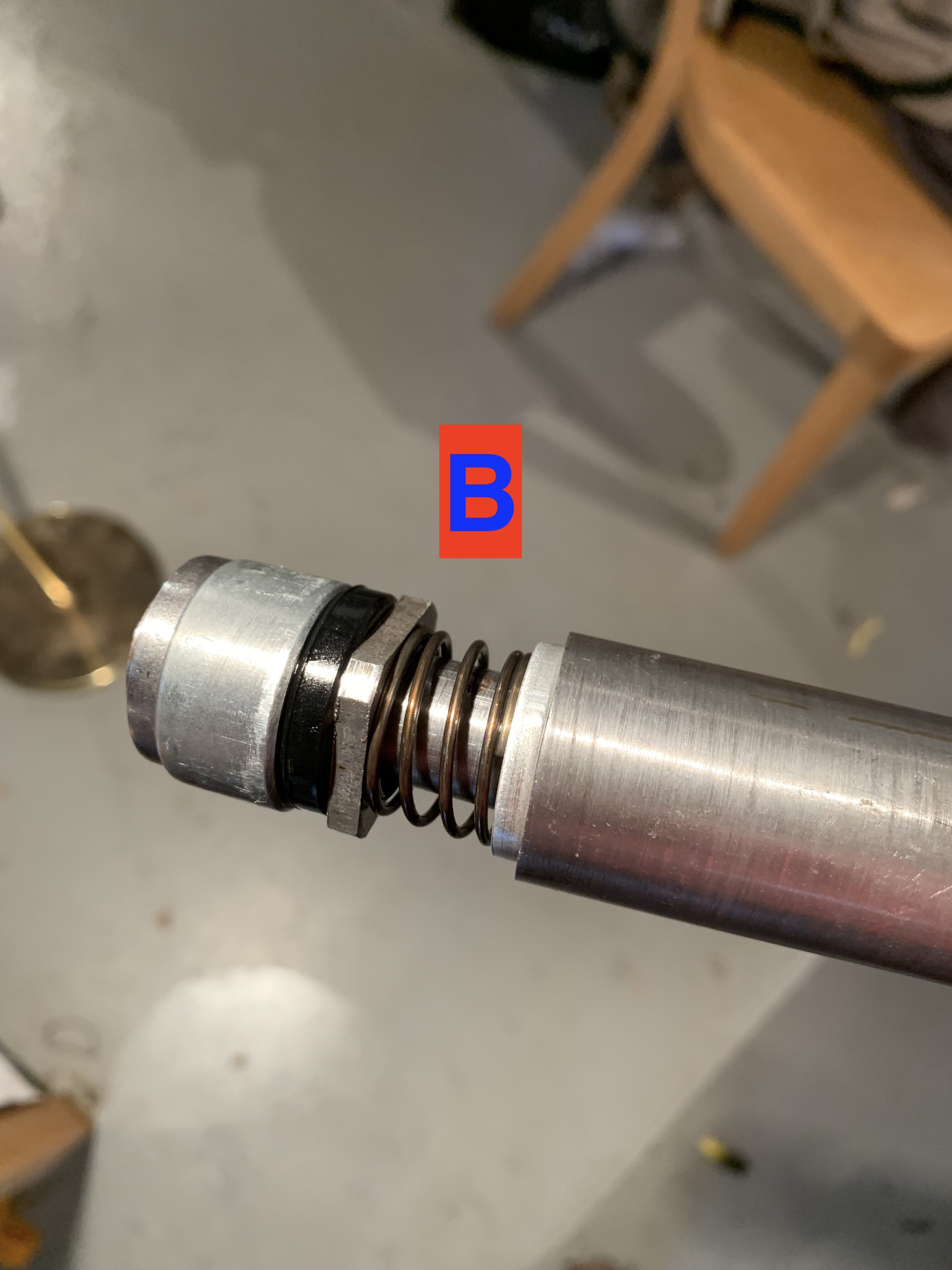

In photo B the internal spacer touches the ring before the spring, and the spring can be compress.
Which is the correct way the internal spacer needs to be mount?
Thanks
