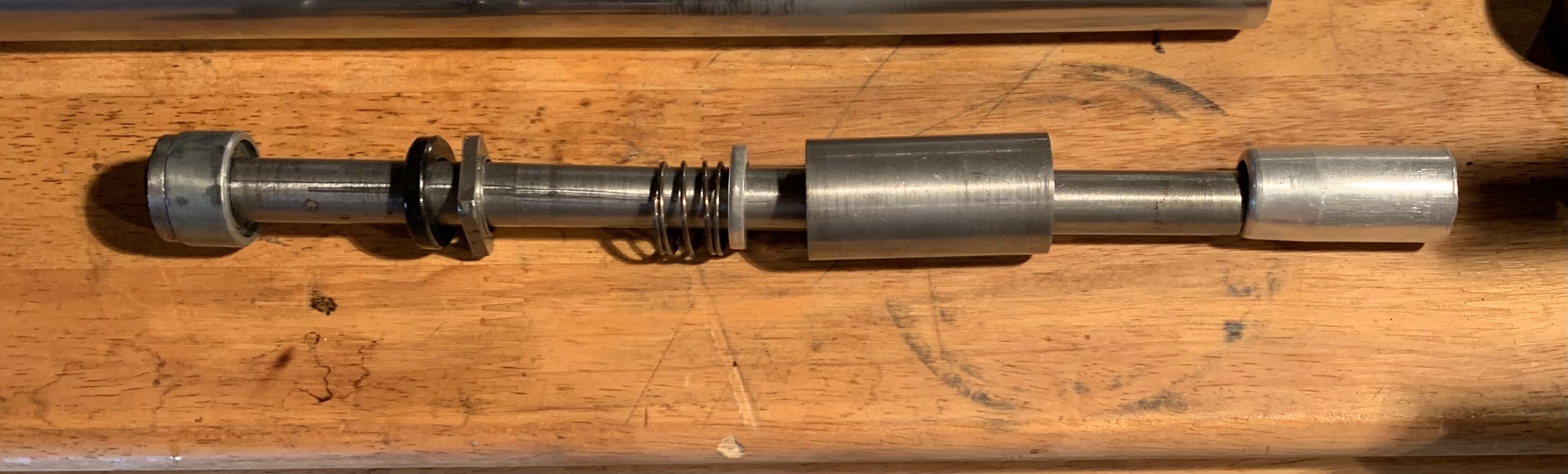

2. This is a photo of the fork damper assembly- can you tell if this damper has the anti-topping spring that prevent the metal to metal impact?

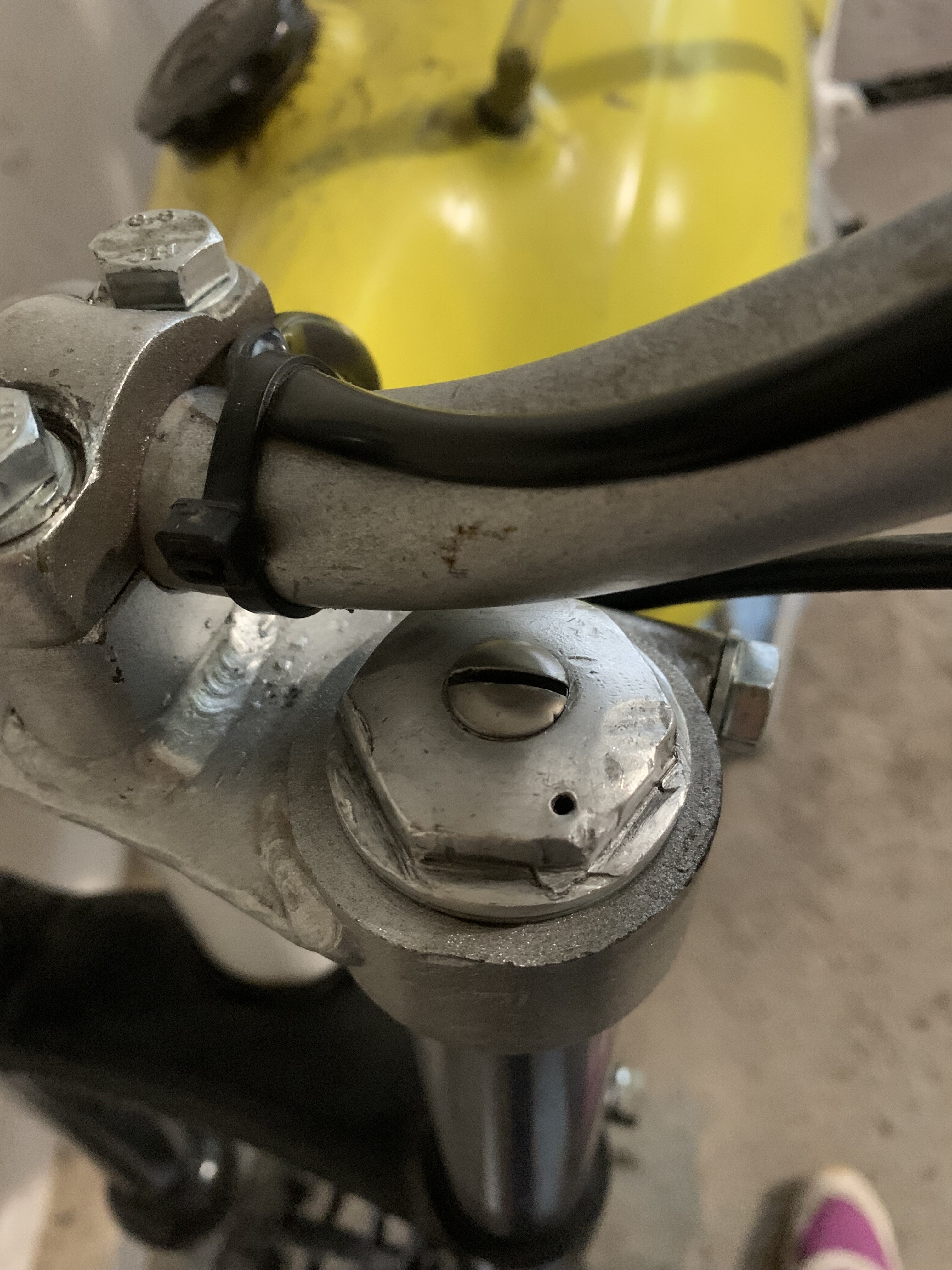

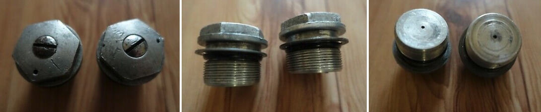

3. This is the fork caps that the bike has. Can you tell if this is the vented type caps that releasing air?

Take a wide guess what the hole in the top is for .........

If that is how your damper rod is assembled then it is correct. The top out spring is the small spring you can see. It doesn't stop the forks topping out if they aren't set correctly with oil but it cushions the impact - you will still hear the metallic bang
If you think the forks aren't working correctly drain all of the oil out and then, with the bike on its wheels, push the forks right to the  bottom. With no oil you should easily be able to do this in a smooth fashion with no binding. If there is resistance one or both tubes could be bent or there could be an incorrect length spacer on the front wheel which is pulling the bottom of the forks together or pushing them apart, which can also cause binding.  Assuming they push to the bottom normally, push them sharply to the bottom and let go. The spring should be strong enough that they rebound quickly and maybe right to the top so that you hear the metallic bang as they top out. It's possible the old springs have lost strength and don't fully extend, if not pull on the bars to check they top out.  This will show whether you have full travel up and down on the forks.

The fork caps letting air out when you compress the forks also affects the rate at which the forks compress. If they don't vent, the air pressure gives extra preload, if they vent it weakens preload - and can also spew oil out as well as air. Personally I think they are not needed and block the holes off to make them solid caps.
