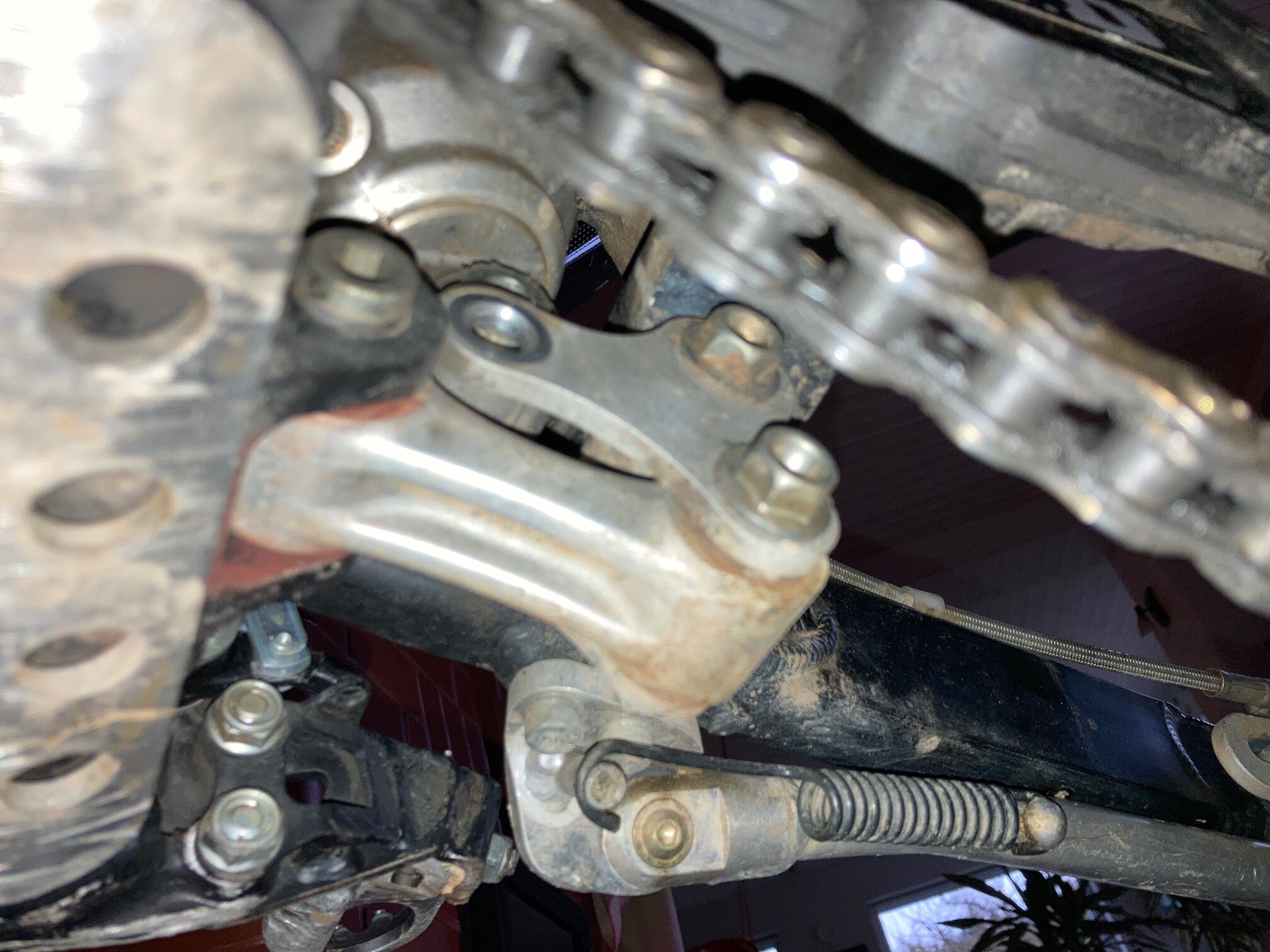

Started to work on it, visually the linkage looks allright:

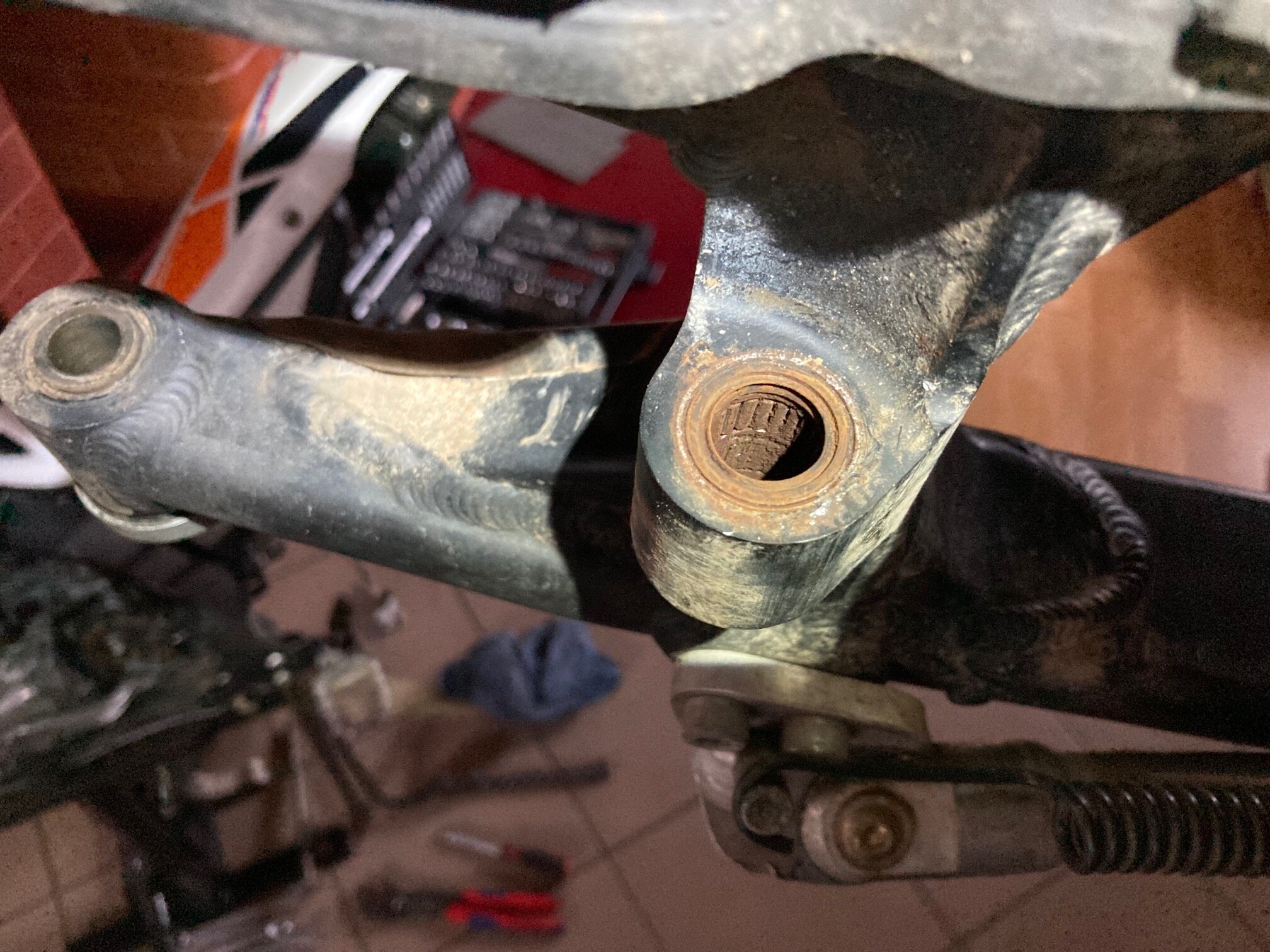

In the end took me couple of hours actually, since they were like crap so I did it properly. See how bad they looked inside - completely dry and done:

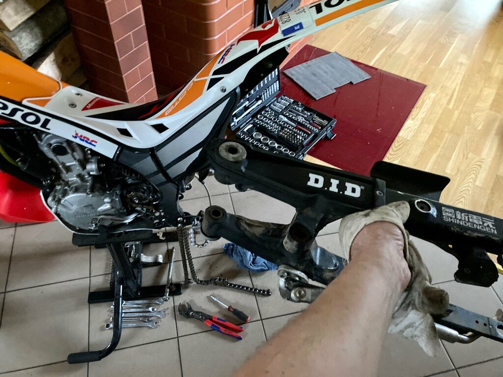

 Cleaned and relubed the swingarm bearings as well, they were allright, smooth and tight, with no slack what so ever:

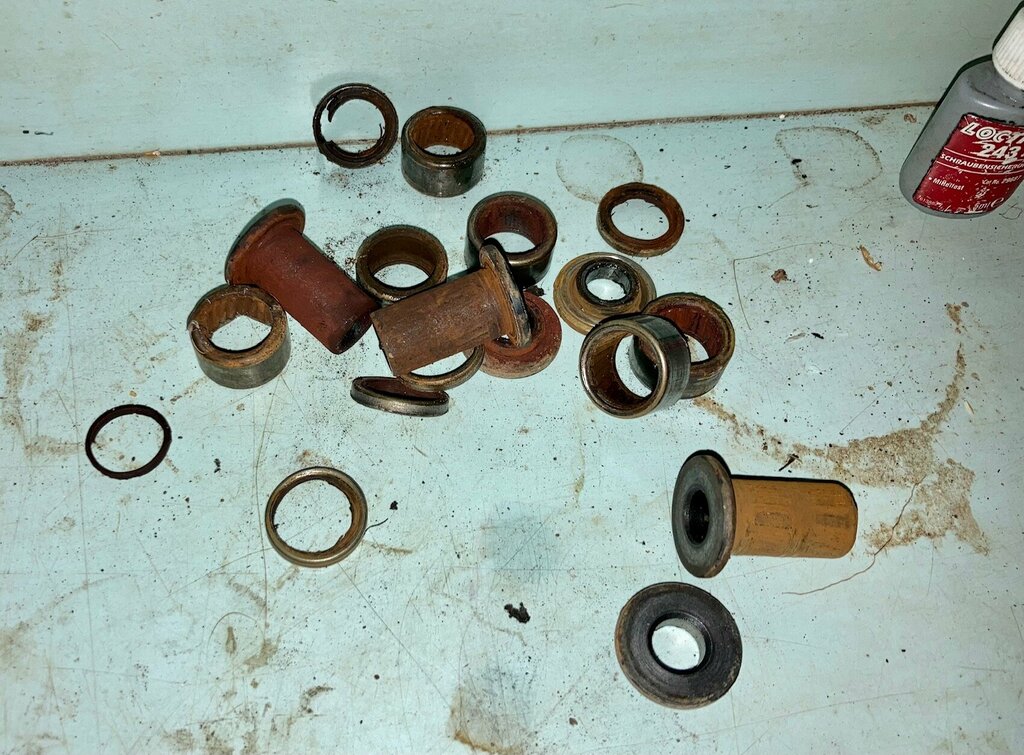

The final collection of old bearings and bushings give a good indication how bad they were:
