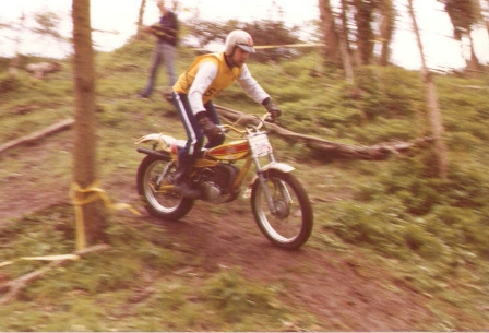

Hey
My dad competed on a yellow/gold majesty quite a few years ago before i was born (well thats i lie he sold it when i was 6 months old). Below ia a picture i have found of the bike, i hope it helps. If you want more just PM me.
Scott
PS im unsure if its the same bike he resprayed but my dad also had a golden one majesty. I also have pics of that one just PM me.

Thanks scott, any majesty related stuff always usefull! :)
Ah brings back some lovely memories of my first bike.
Thanks Heath. Good find, the majesty seems a popular steed over in france. Cheers
The yellow on the swingarm of that bike looks to be near the yellow of the original Majesties
