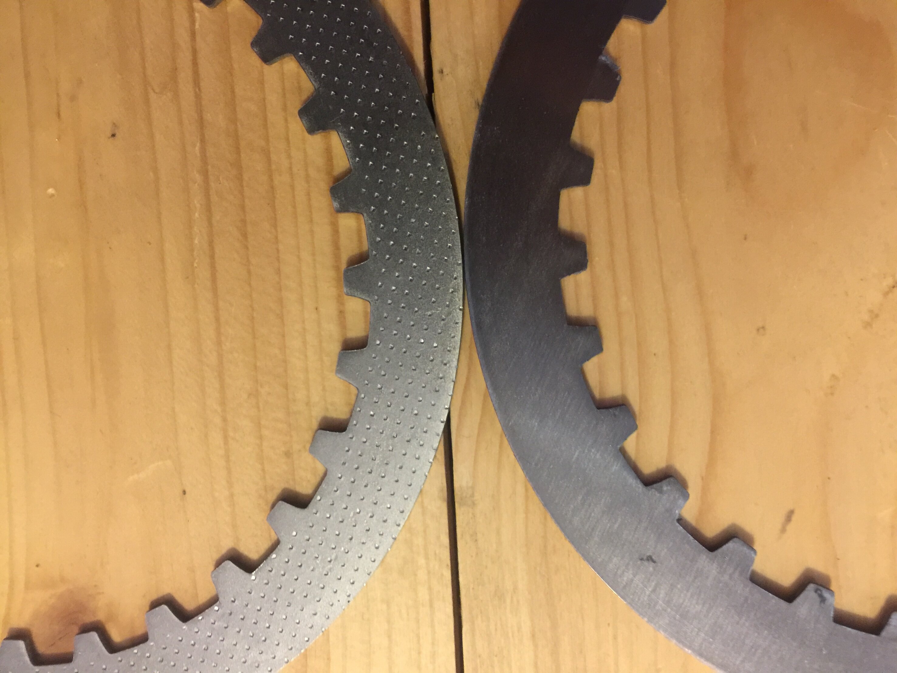

The problem is the original clutch discs,
swap it for the one from Jitsie with a ribbed surface,
there is a better oil film, the clutch disengages better and can be better dosed.
It is easier to find neutral and it is also easier to start the engine in gear.
Is a standard tuning for the 4RT competition drivers. 😉
best regards Bernd
fits for all years of construction up to now and also for the 300RR.
