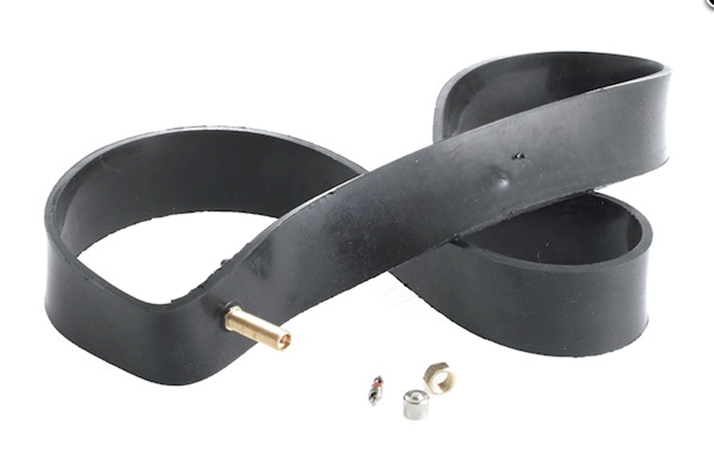

Second problem is the rear tyre. My dealer mounted a new tyre and inner tube, but there is no clamp on the tyre! That really does not make any sense to me. Can anyone advise?

I've run tubes in situation like this before, and not had any problems even at low pressure. I do trialing though not trick riding
