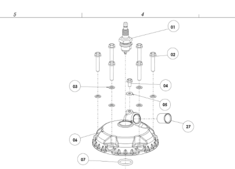

Hello
Have you bled the air out using the bleed bolt in the top of the cylinder head? Item 4 on diagram attached.
I normally part fill and then turn the engine over by hand with the kickstart - not easy unless plug removed. Then top up and bleed at cylinder head. Coolant should be just covering the top of the radiator fins - visible check with a torch if you shine into the fill hole, but I just dip my little finger in to ensure an air gap remains..
If the pump impeller is O.K., it will rotate when you turn the engine over by hand - and can be seen with the impeller cover removed. Assuming no blockages in the coolant path through the hoses and engine, then coolant will circulate.
Hope this helps

Purged the air via the 8mm bolt yes.
I did not kick it over once the coolant was in (nor when it's halfway), except to start it. I'll have to try again.
