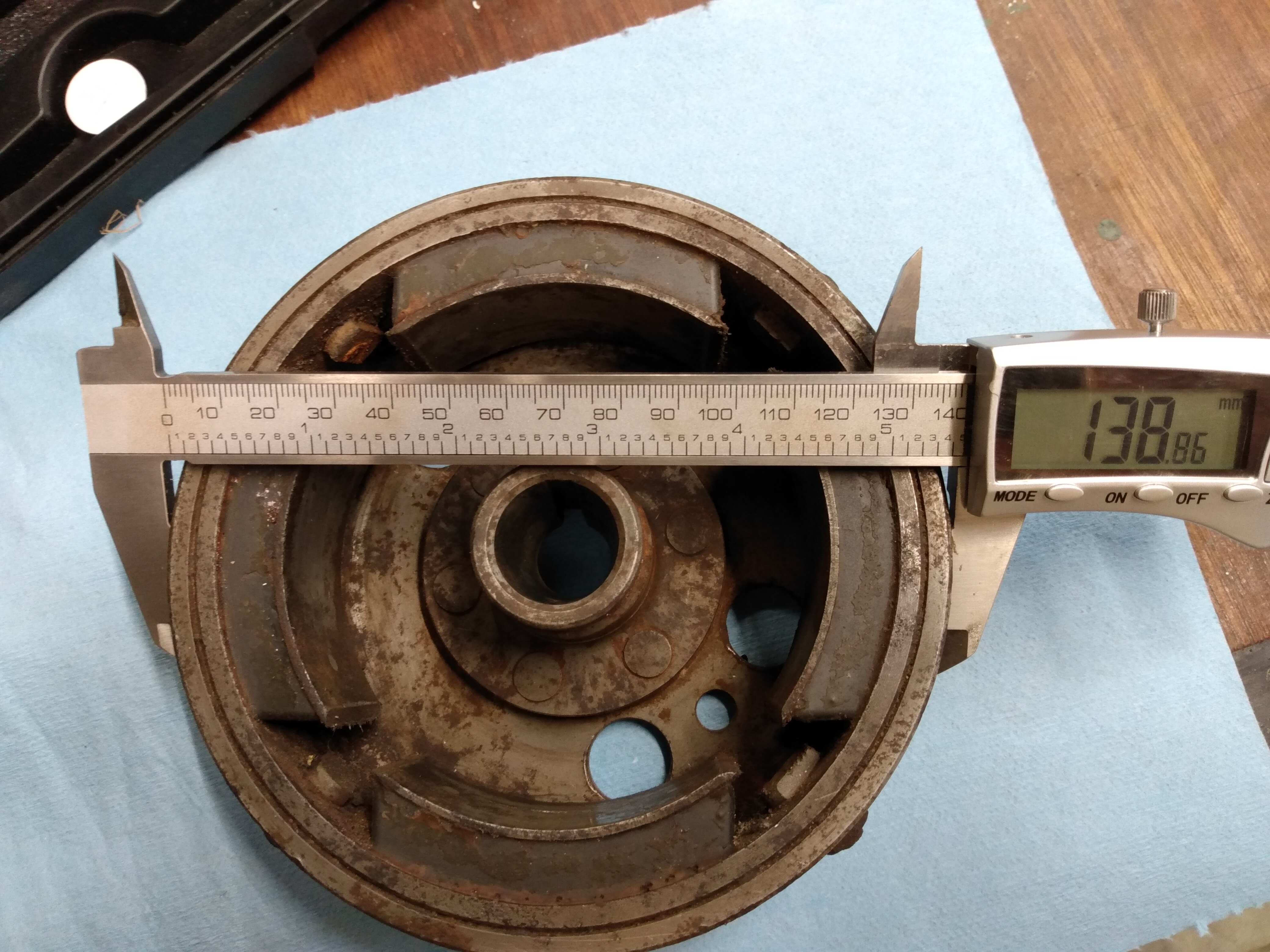

Is there someplace that I might get the actual dimensions and perhaps even the weight?  The one I have is 138.86mm, or 5.467" in diameter. I don't have an accurate scale to check the weight. I guess it really doesn't matter. It seems that as long as it works, it will do. It's just that my son has asked if it is possible to get the original, so I'm trying to verify what is the original. I am having problems getting the pictures from my phone to my computer so I can upload them here. I'll have to try later to down load them again. Thanks.

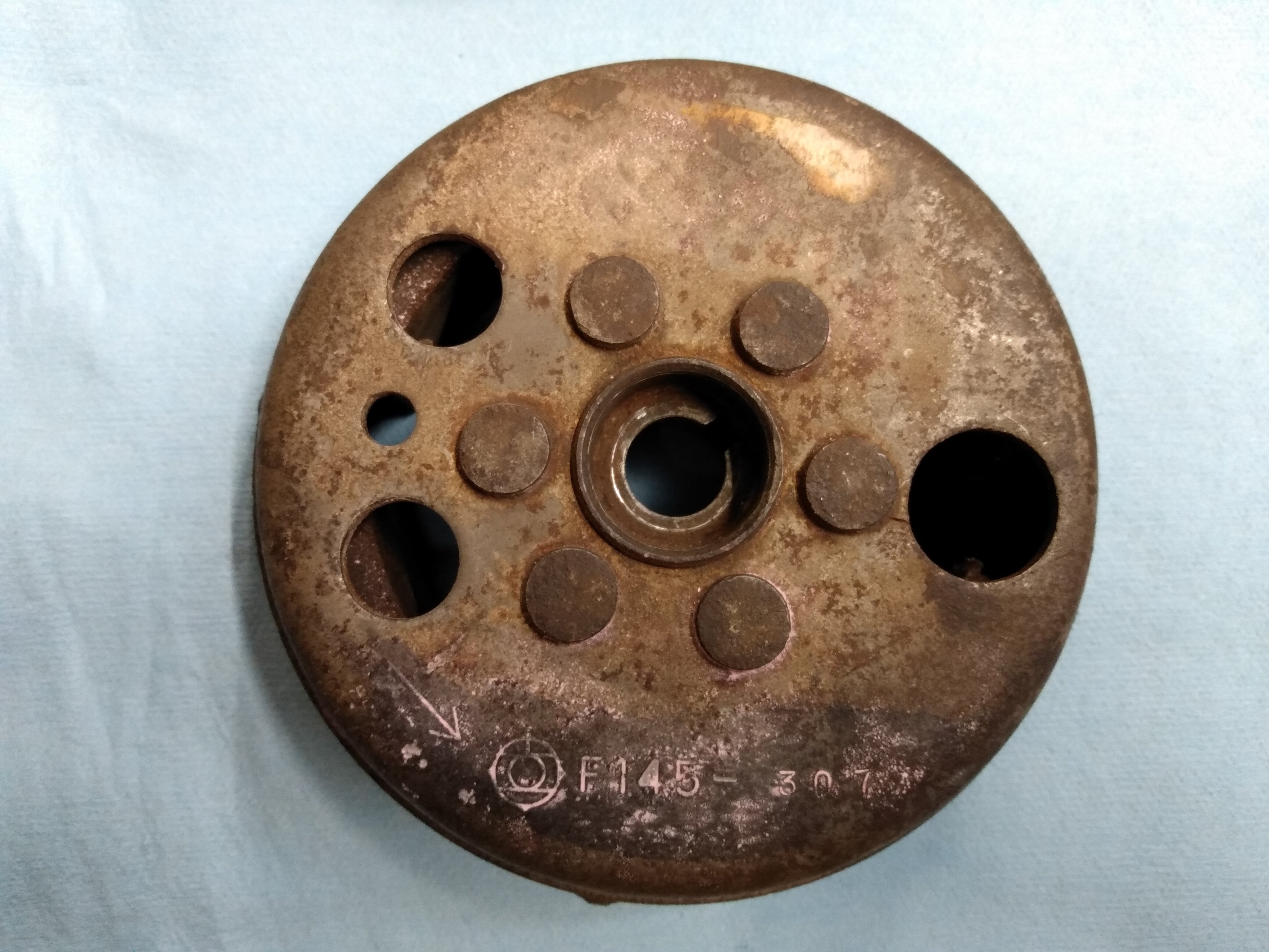

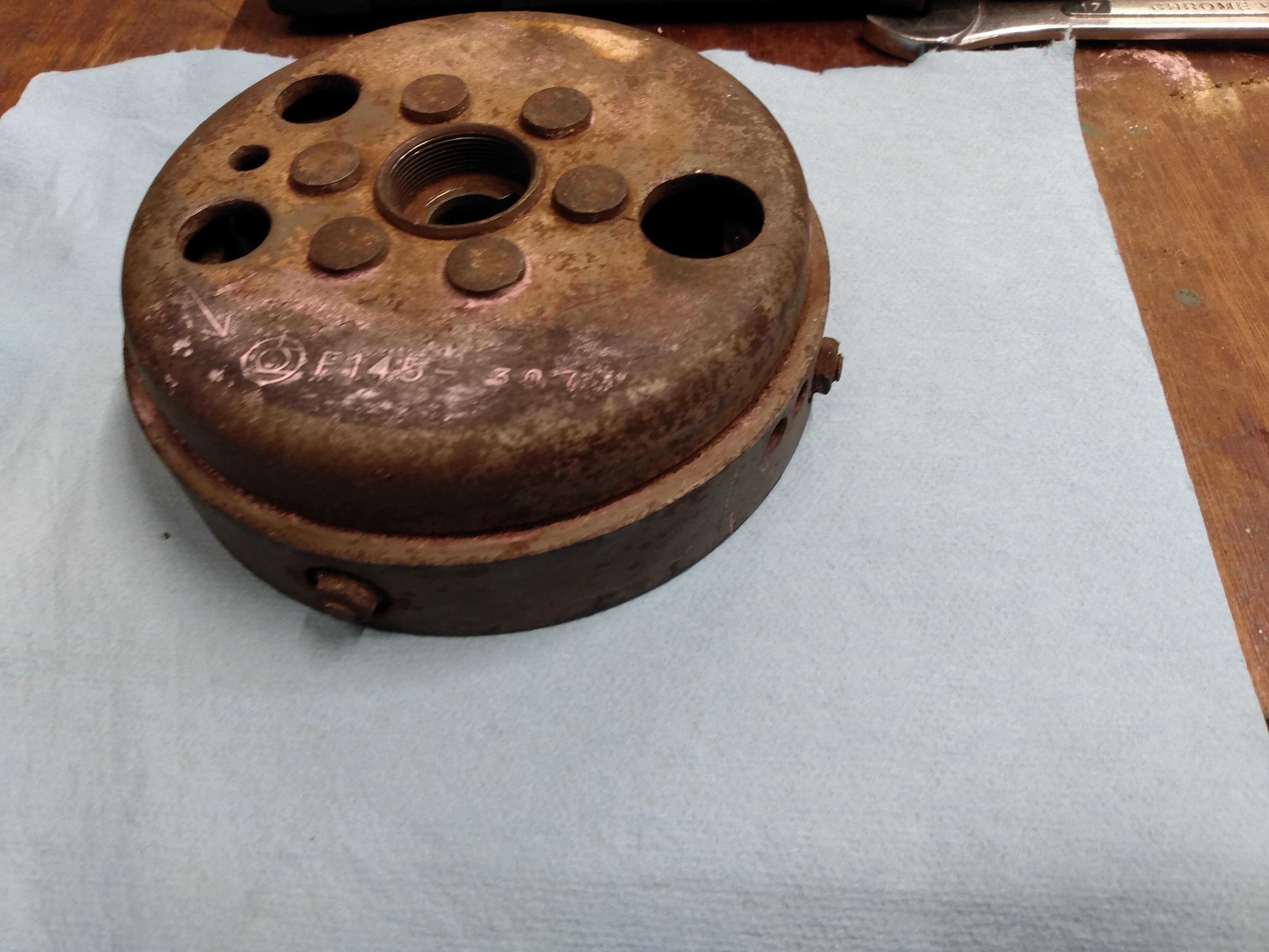

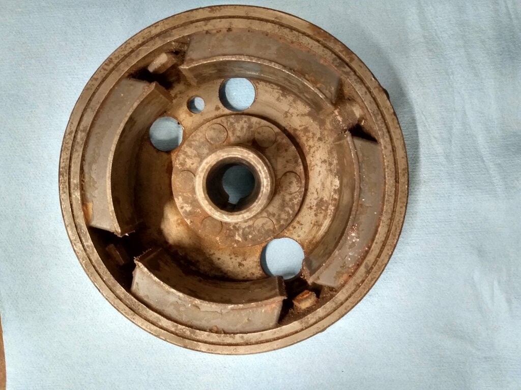

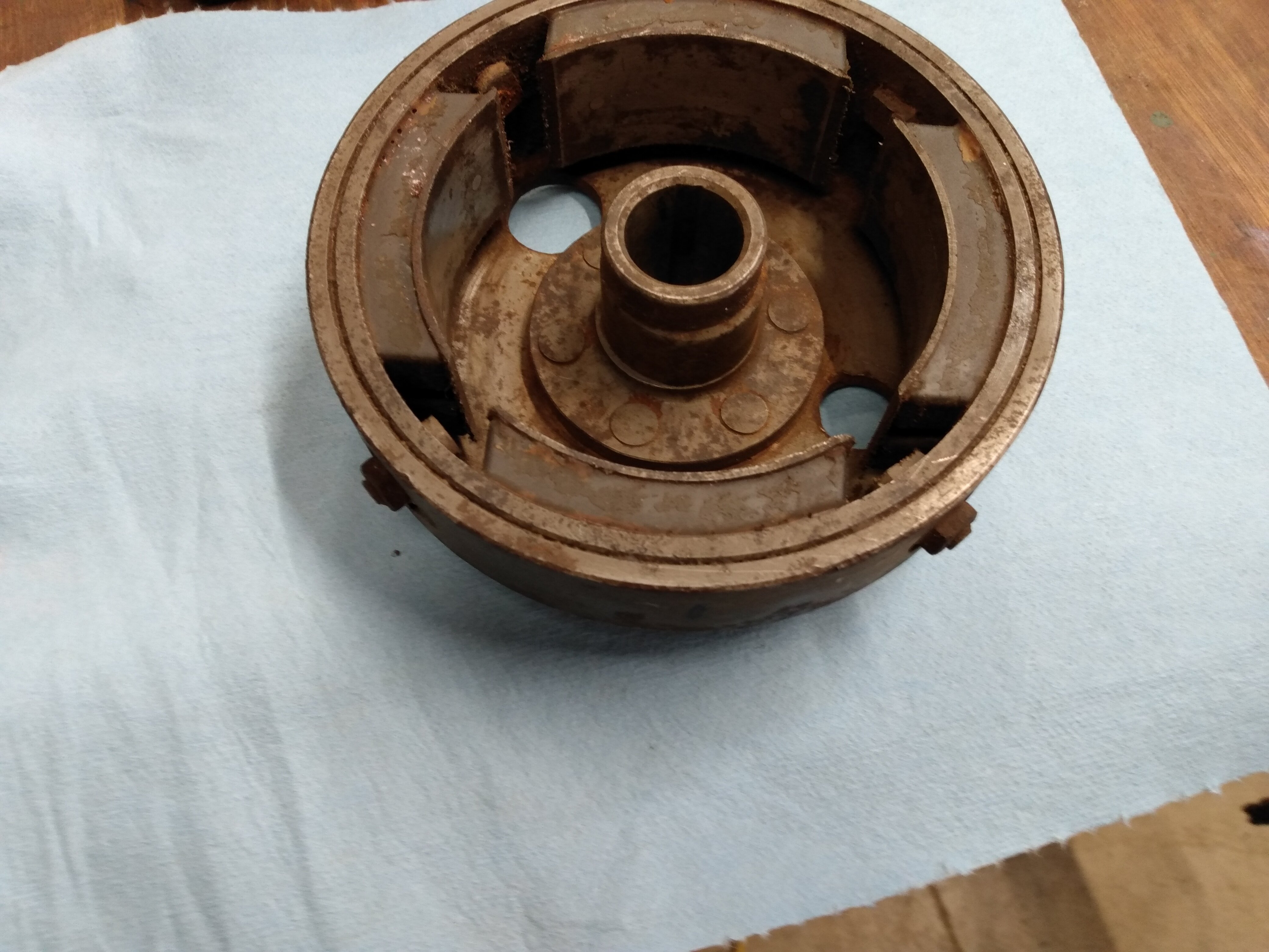

Well after returning from our Thanksgiving celebration, my pictures had arrived from my phone to my laptop. I will post them with to see if any one knows by the diameter if not by looking at it, if it is the correct one for my 493 series TY250.  I think the number on the outside face of the flywheel is F143-3073. I am not sure what that means or refers to. I have found nothing in my research mentioning those numbers.

It's not the original type of flywheel for a TY250D but it will work fine. As expected, it's a TY250A flywheel. Do you still want dimensions or photos of a TY250D flywheel?

 Okay, I can clearly see the Flywheel on the right has a thicker ring on the outside and I can't say for sure but it looks like mine has a thinner outside ring. I guess without weight and O.D. dimensions I have to assume that the flywheel I have is from a TY250A. It'll still work, but my son says he remembers that the bike was easier to ride with the original fly wheel. Thanks for the pictures. Now I guess I'll go with it. Perhaps I should ask, does anyone know of a source for the heavier wheel?

Seems I overlooked this posting. If the dimensions are available they surely would be helpful. The pictures look good. Thanks.

The steel ring on the BCDE flywheel is 27.65 mm wide and 8.6 mm thick. Other dimensions are the same as the A model flywheel
