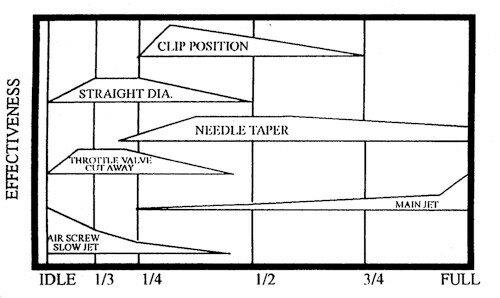

"Carb checked and clean" is where I'd back track. Have you confirmed the correct jet size, needle position? Off idle your looking at the air screw and needle clip position.
