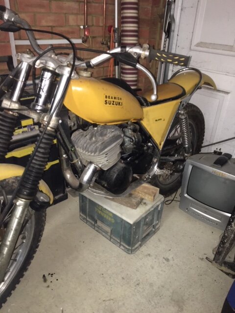

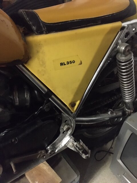

suzyboy Posted January 14, 2023 Share Posted January 14, 2023 Hi all. New to this site and a bit of a techno dummy so lets hope I can use the site okay. So I have an issue with my Suzuki Beamish RL. I have been advised the Beamish was made in two models. The RL250 and the RL325. Problem being my Suzuki Beamish has a period decal either side that looks original, that states it's an RL350. So, does anyone know if the beamish was made as a 350 please. Quote Link to comment Share on other sites More sharing options...
cleanorbust Posted January 15, 2023 Share Posted January 15, 2023 From clear memory of the time I'm sure Beamish never used the title RL350. Their bigger engined bike was the RL325 and always had that capacity Could you post a picture of the whole bike? Quote Link to comment Share on other sites More sharing options...
suzyboy Posted January 15, 2023 Author Share Posted January 15, 2023 Picture should be attached ?? we shall see. Can't get a better picture outside or in decent light just yet but maybe in the week. I can take another angle if you wish Quote Link to comment Share on other sites More sharing options...
cleanorbust Posted January 15, 2023 Share Posted January 15, 2023 Looks like a 250 to me. 325 had "325cc" cast into the barrel between fins. I wonder if someone has bored out a 250 to create a "350". Would be worth whipping the cylinder head off and measuring the bore. 250 was 70mm, 325 was 80mm I believe. Quote Link to comment Share on other sites More sharing options...
suzyboy Posted January 15, 2023 Author Share Posted January 15, 2023 Whipped off the head after clearing exhaust and air box out of my way. The piston measures approx 82mm diameter. Going to carefully clean up piston and see if it has any details stamped into it. I shall report my findings if anything found 1 Quote Link to comment Share on other sites More sharing options...
woody Posted January 15, 2023 Share Posted January 15, 2023 Someone has just made a 350 sticker up. They were 322cc badged as an RL325, 82mm is an oversize piston 1 Quote Link to comment Share on other sites More sharing options...

suzyboy Posted January 16, 2023 Author Share Posted January 16, 2023 12 hours ago, woody said: Someone has just made a 350 sticker up. They were 322cc badged as an RL325, 82mm is an oversize piston Thank you for your thoughts. The badge just looks original so through me. Satisfied now that my Suzy B is a RL325 with a dodgy decal . Quote Link to comment Share on other sites More sharing options...
woody Posted January 17, 2023 Share Posted January 17, 2023 It's just what some people do, the oversize 82mm piston gives about 340cc so someone has made a 350 decal for it. Some do it for the TY250 Yamaha when an oversize 70mm piston is fitted, they have a 270 decal made for it Quote Link to comment Share on other sites More sharing options...
