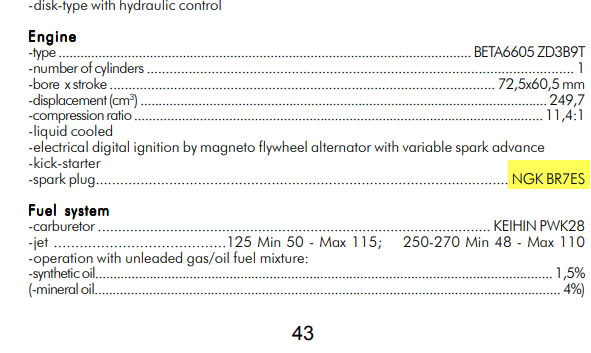

The manual of an '07 Rev calls for a BR7ES. I wonder why they changed. The tip of "P" plug extends into the combustion chamber thus taking up space and raising the compression ratio some. Maybe that was what they wanted.
