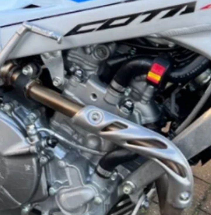

Also where have people repositioned this switch? I seem to constantly knock it into map 2. I think my lanyard is hitting it. I saw one mont where the map switch was neatly mounted on the radiator hose by the kickstart tip

Here is a photo of the switch mounted on a coolant hose. I just wonder if the heat will damage the switch or cause issues1188873285_Screenshot_20230203-0750052.png.6d5a3e05f1ac212e74ea220e555f8749.png
I am on a 2017 Montesa 300 RR, put mine on the coolant hose right from the start and haven't had any issues with damage yet.  I can't recommended following my lead but its working for me and I plan to keep it this way unless something unexpected happens.  Good luck.
PS. I rotated my switch up so it is less likely to get bumped by my leg or a crash.
