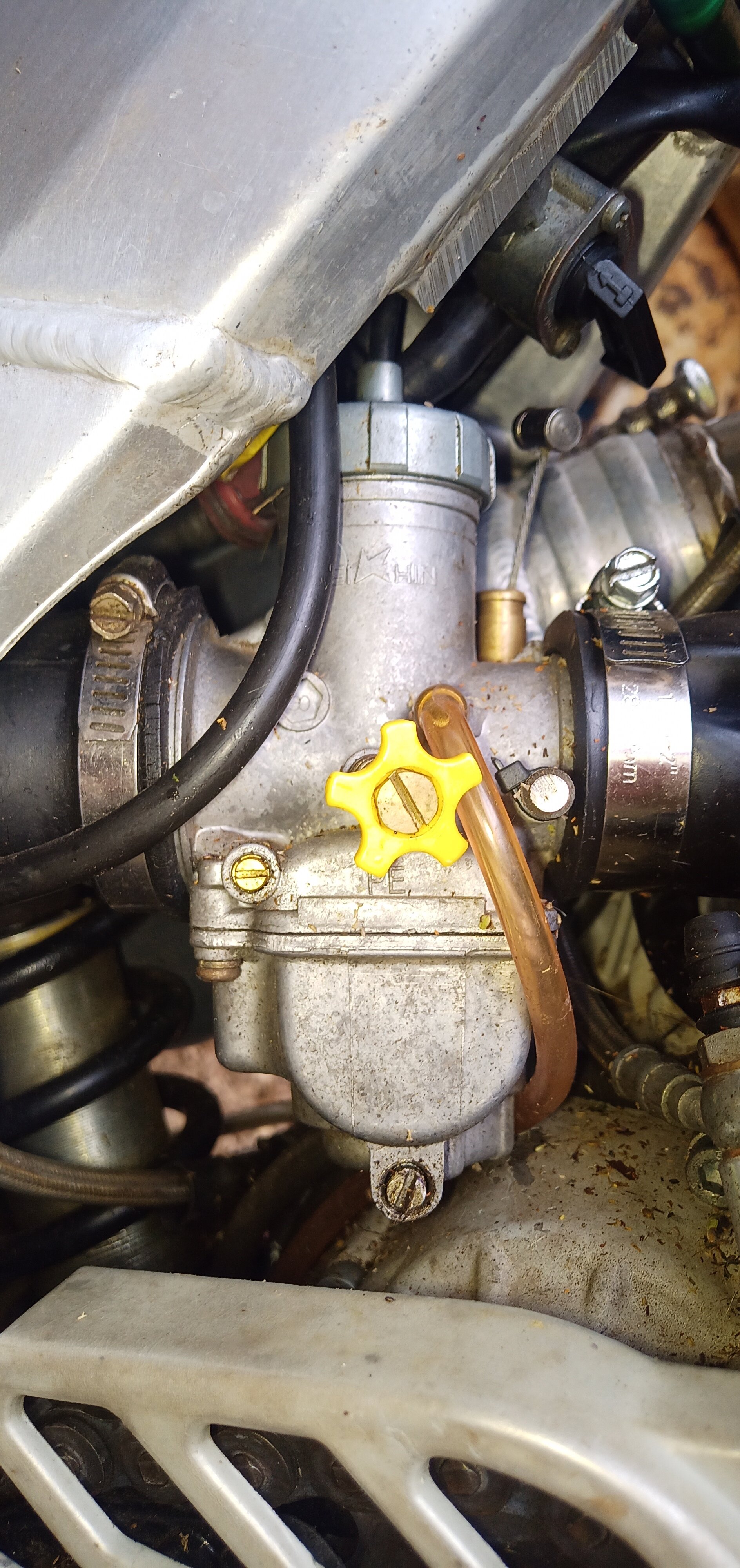

Hey all, I thought I'd send a message on the forum which I've been looking at a lot lately as I've bought an old beta techno trial bike as my first bike. It's been a lot of fun but I've had some issues with the bike and the latest has been chewing up spark plugs and now not starting. It seemed to be a fuel issue and as I was investigating I noticed the carb seems to be not only not the original mikuni vm26 but a cheap Chinese keihin copy. I've sourced the original carb for $670 through beta but that is not what I want to spend. Does anyone know of a better alternative? Thanks for your time

There is a kit from oko Australia that I found out about through Trialtech moto Australia. Does anyone know much about OKO carbs? Cheers
The OKO is a very good carb. I have 3 of them on my 350 Sherpa T`s. Dennis is the bloke who runs TrialTech Moto. Make sure you get the real ones and not the Chinese ones. They are crap!
Just wondering if anyone has successfully mounted a Keihin pwk28 on a techno? Obviously the idle and mix screws are on the exhaust side so a bit of a p.i.t.a but would be great if it worked
