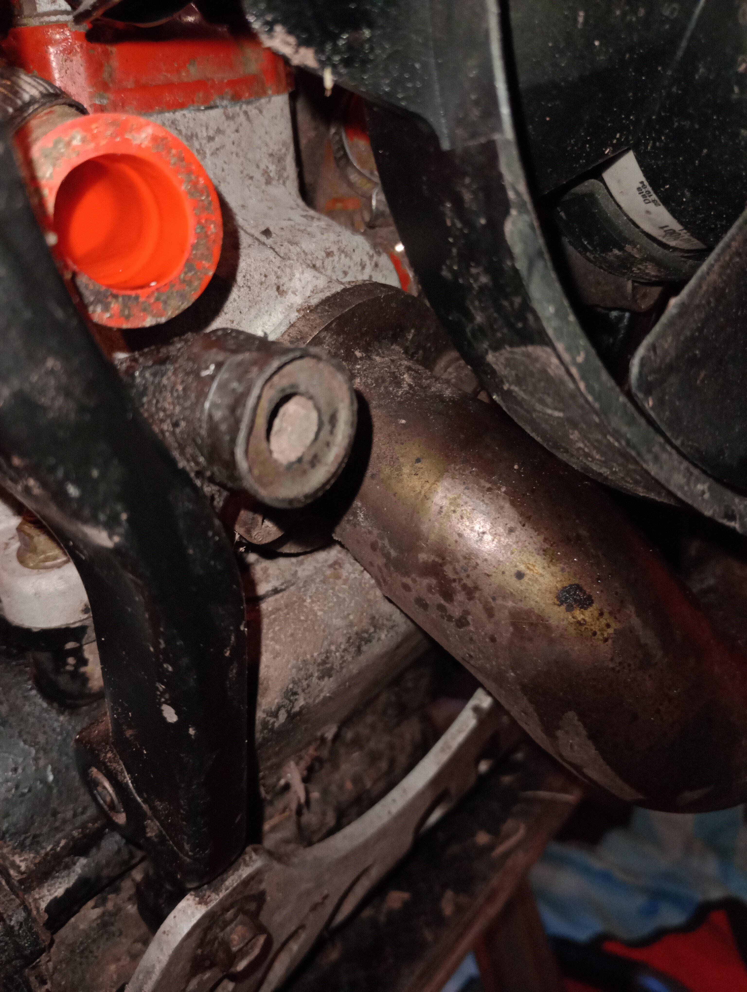

Hi, now I believe that these are held in place at the top with a grommet into the frame. Mine was held by a couple of zip ties I've taken the rad out to find this , see pic. I presume something has snapped off , anyone know.?
Also the lower mounts, how are they attached to the rubber mounts??. Anyone got a clear photo showing this please.

IIRC, there is a hole in the frame that takes a grommet similar to a grommet that protects wires going though sheet metal.  That post on top slips up into the grommet.  See item 12.  I had a 14 model that did not line up well, was hard to get into place and tended to break the grommet over time so I can see why someone would use tie wraps.  After a few replacements the grommet stopped breaking on me.  Bolts go into rubber bottom mounts,
See link.
https://ibb.co/2KfTv3j
Ahh ok, thanks for clearing that up.

yep, it was basically a couple of zip ties and the hoses holding it in place.
