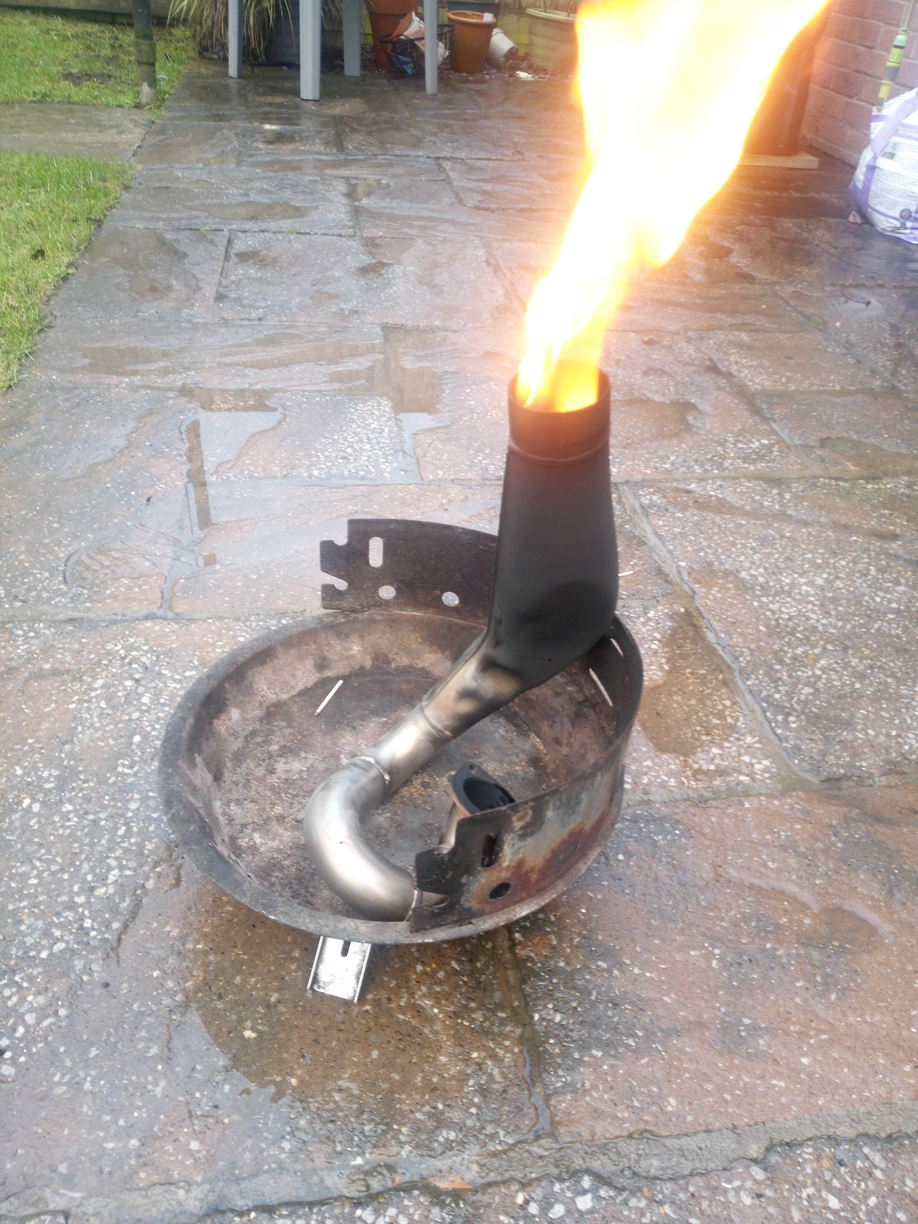

I also burn off the whole exhaust whilst the silencer is off. I just pour petrol down it and let it burn off. Slow running trials engines have coked up exhausts. Don't burn off the alloy silencer though. I just soak that in a good degreaser overnight. The exhaust then polishes up again with some wire wool Brillo pad.
The bike sounds crisp after the repack and burn off of exhaust.

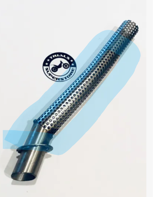

A lot of the packing is inside the end cap too. The steel metal pipe that terminates at the end of the rubber bung inside the end cap has holes in it. Just make sure the packing covers these holes. I put the preformed sheath over the steel tube, then slide the end of the tube into the rubber grommet in the end cap, then push the whole thing into the body of the silencer. I use a long screwdriver to make sure the packing doesn't get stuck when advancing it into the aluminium silencer body.
With that preformed sheath stuff does it go down to the large box part. If it does how do you get the old stuff out.
The preformed sheath only goes on the aerated steel tube. Part of which is housed in the end cap and the rest in the upper body of the silencer. The aerated tube slots into a hole at either end. You can't put it anywhere else. The old packing should be wrapped around the aerated steel tube when you pull it out. It will be a black sooty mess. Any residual bits you can just pick out.
I've added a photo. Packing goes on the highlighted blue but.
Edited by gazzaecowarrior
Ah I get it now. I thought looking at the  shape of it from website shops it went all the way down into the box. Thanks for that.
Just put the packing on the tube first, then into the end cap, then advance into the silencer body. It's really tricky to do it the other way round because of the angled end cap. Your bike will feel like a new bike after. It makes a big difference.
