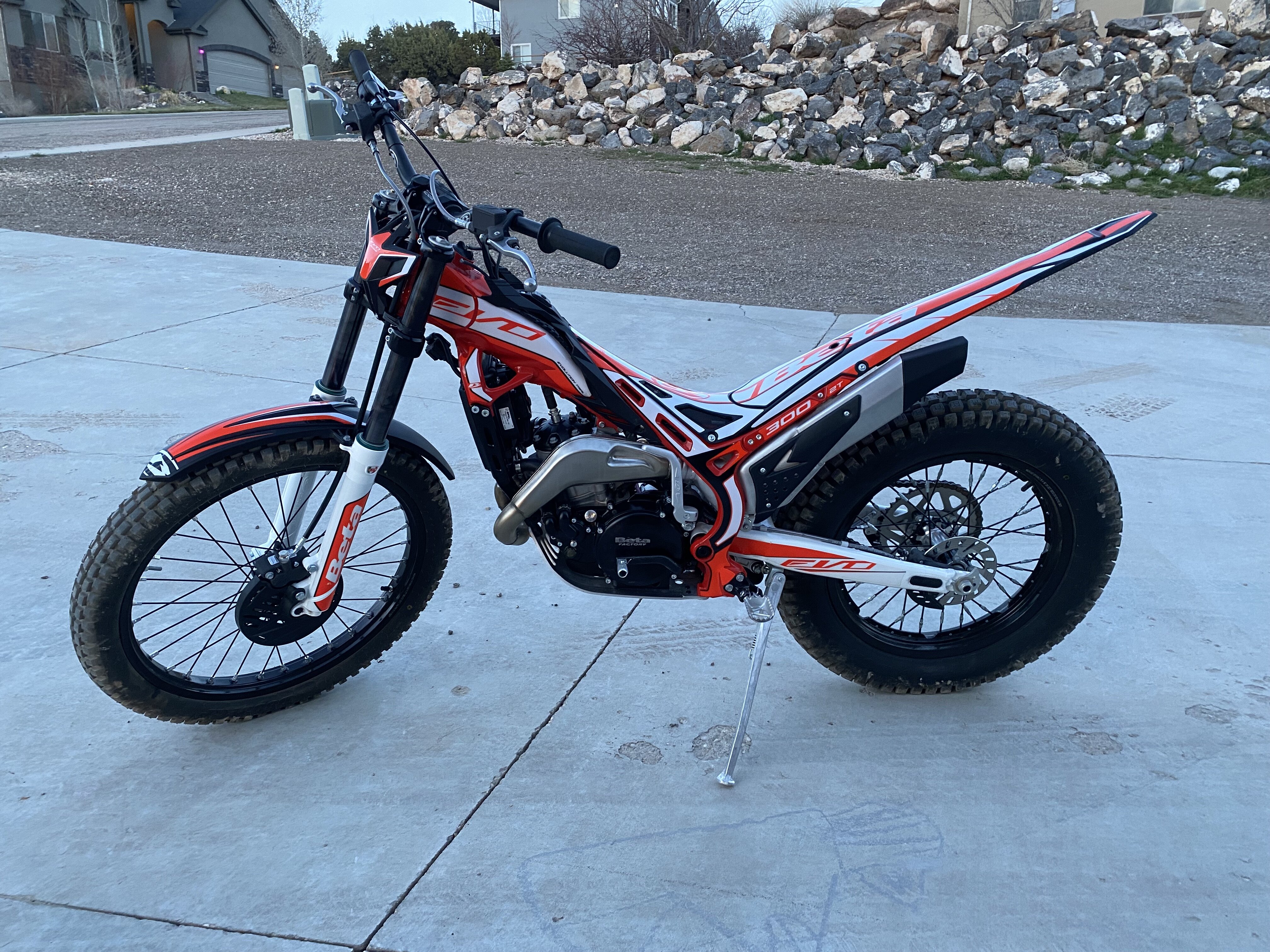

I've got a 2022 Beta Evo 2t with, I'm told, about 6 hours on it.  I just purchased the bike last week.  I noticed the few short rides around the driveway that the cooling fan did not turn on.  The other day after about 30ish minutes of riding around the driveway the bike started to spit coolant as it was over heating.
