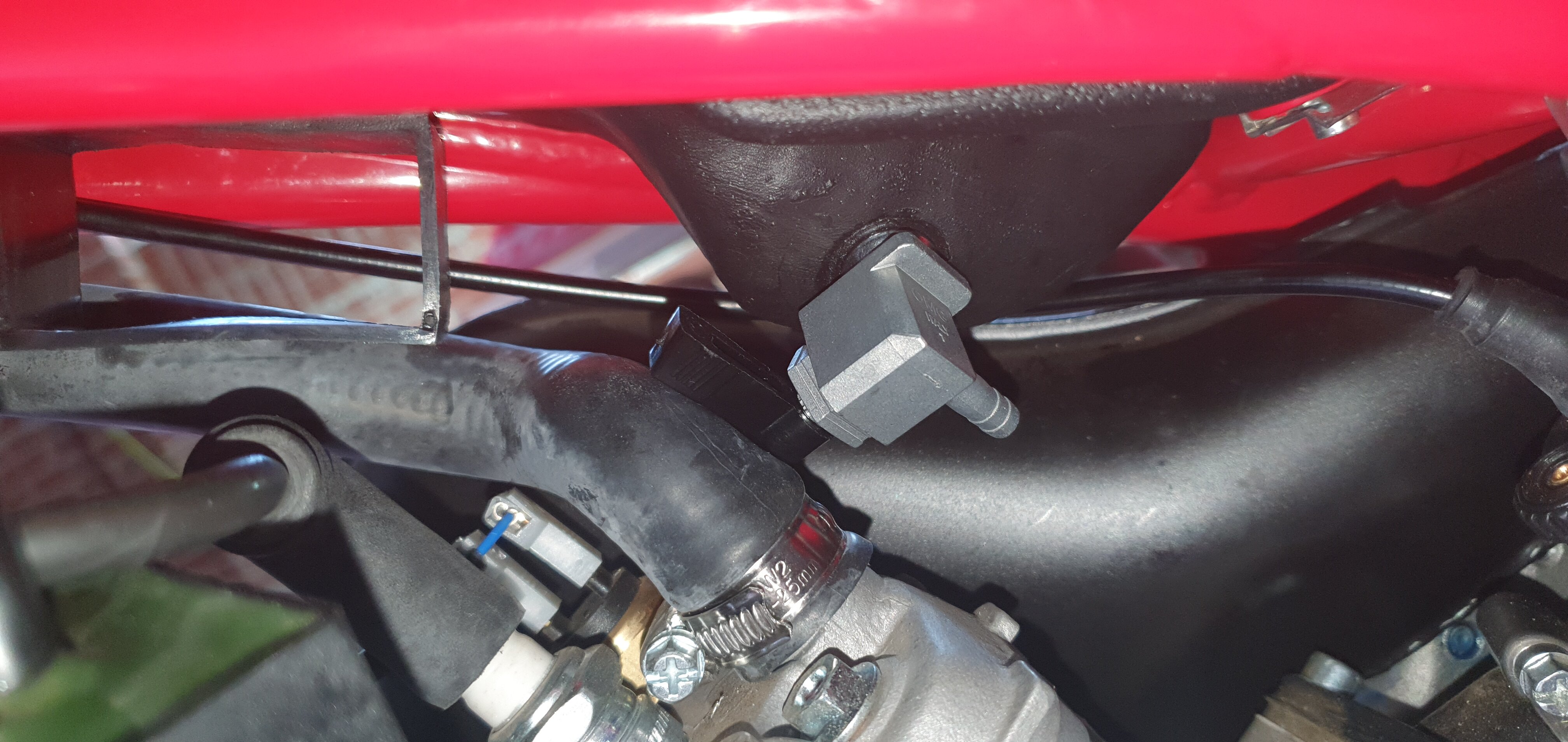

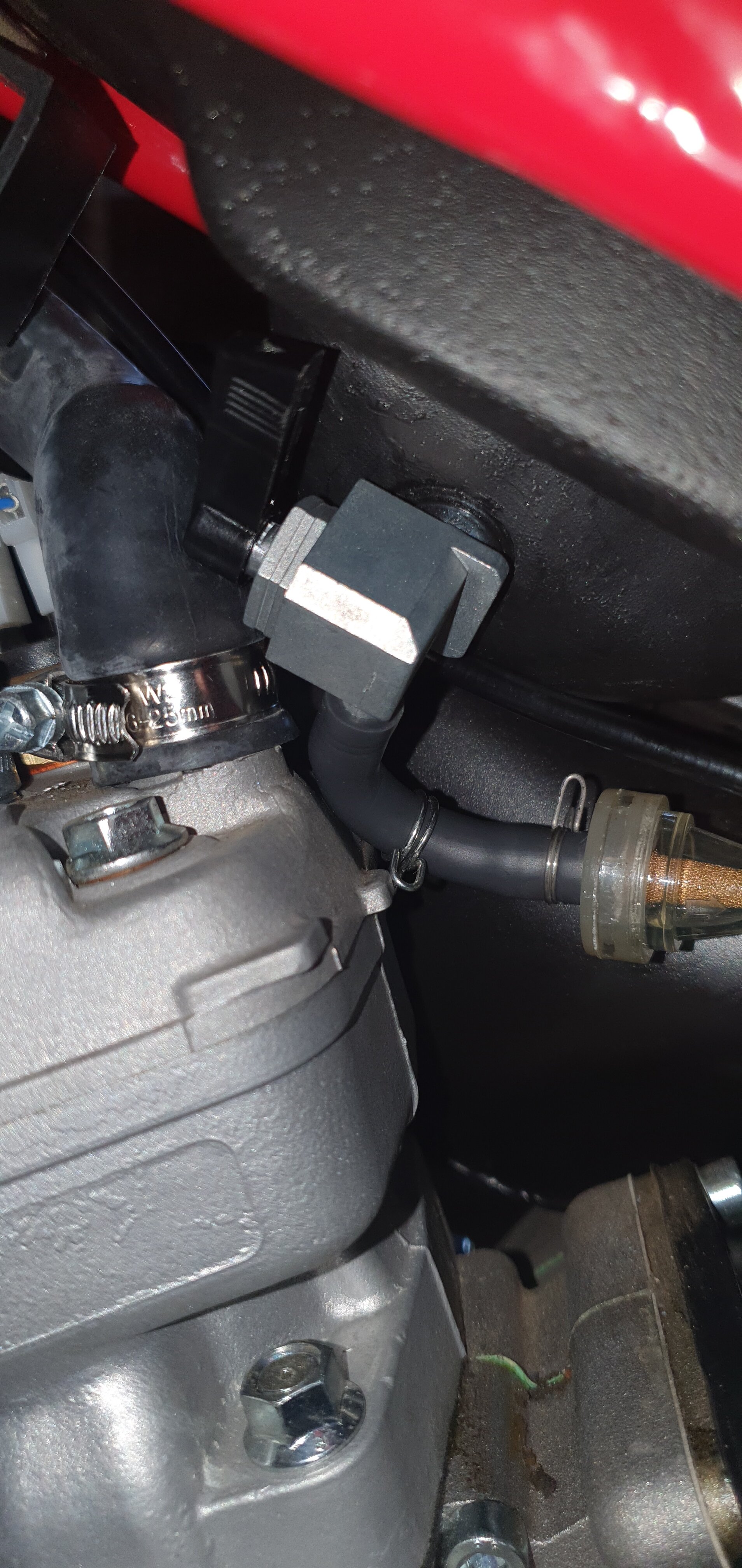

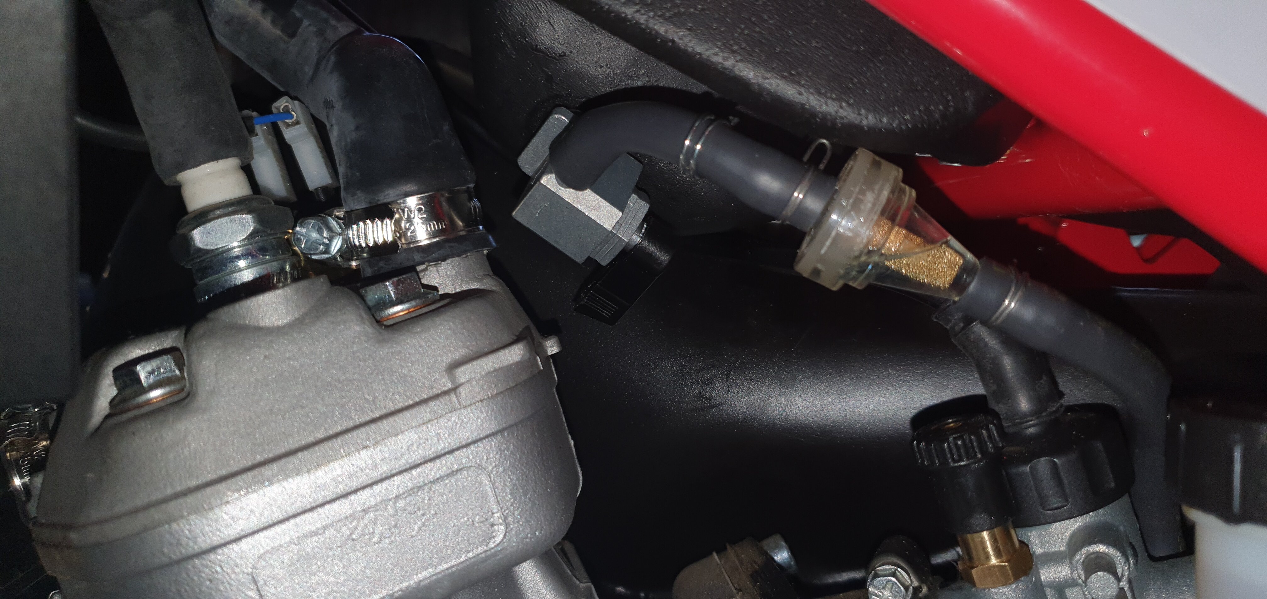

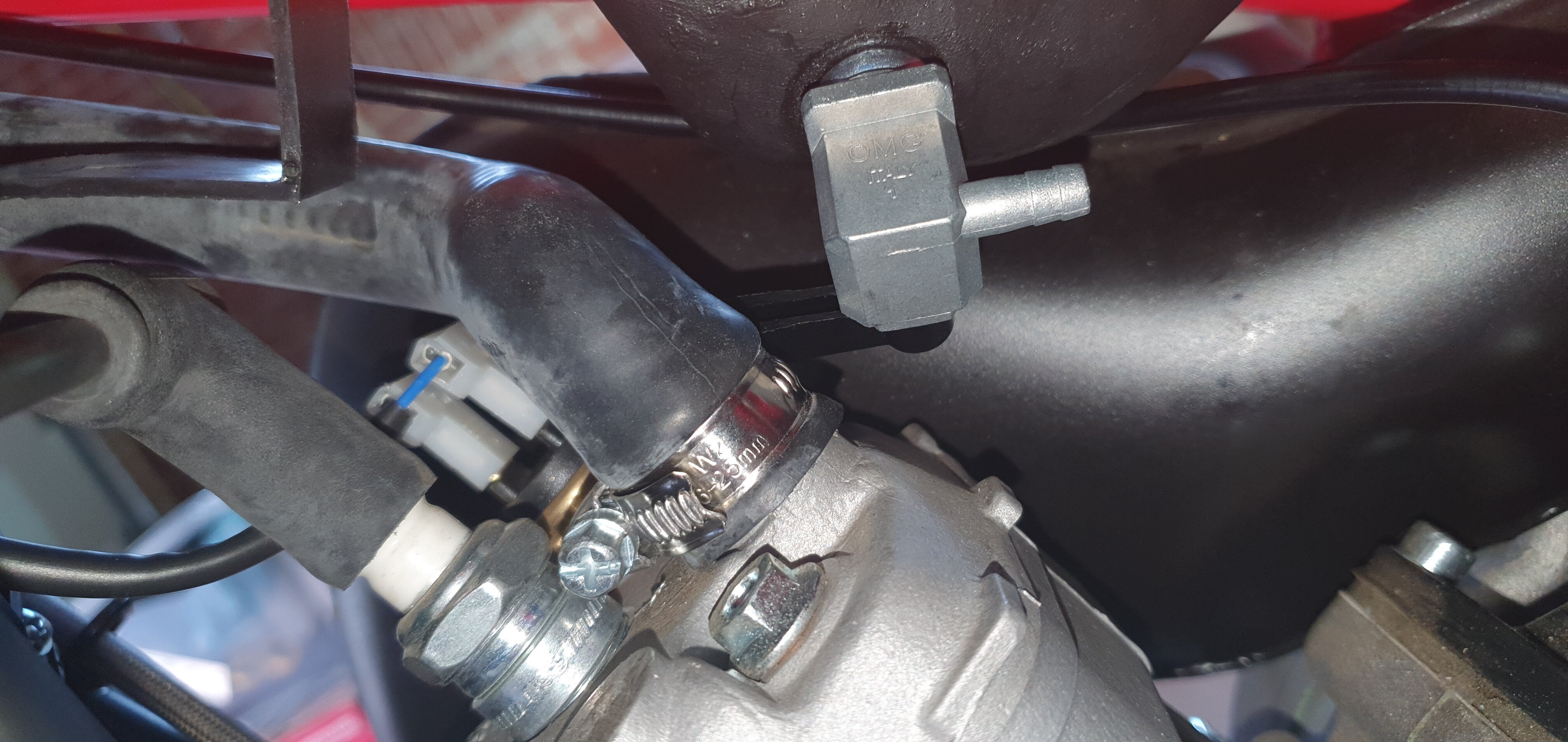

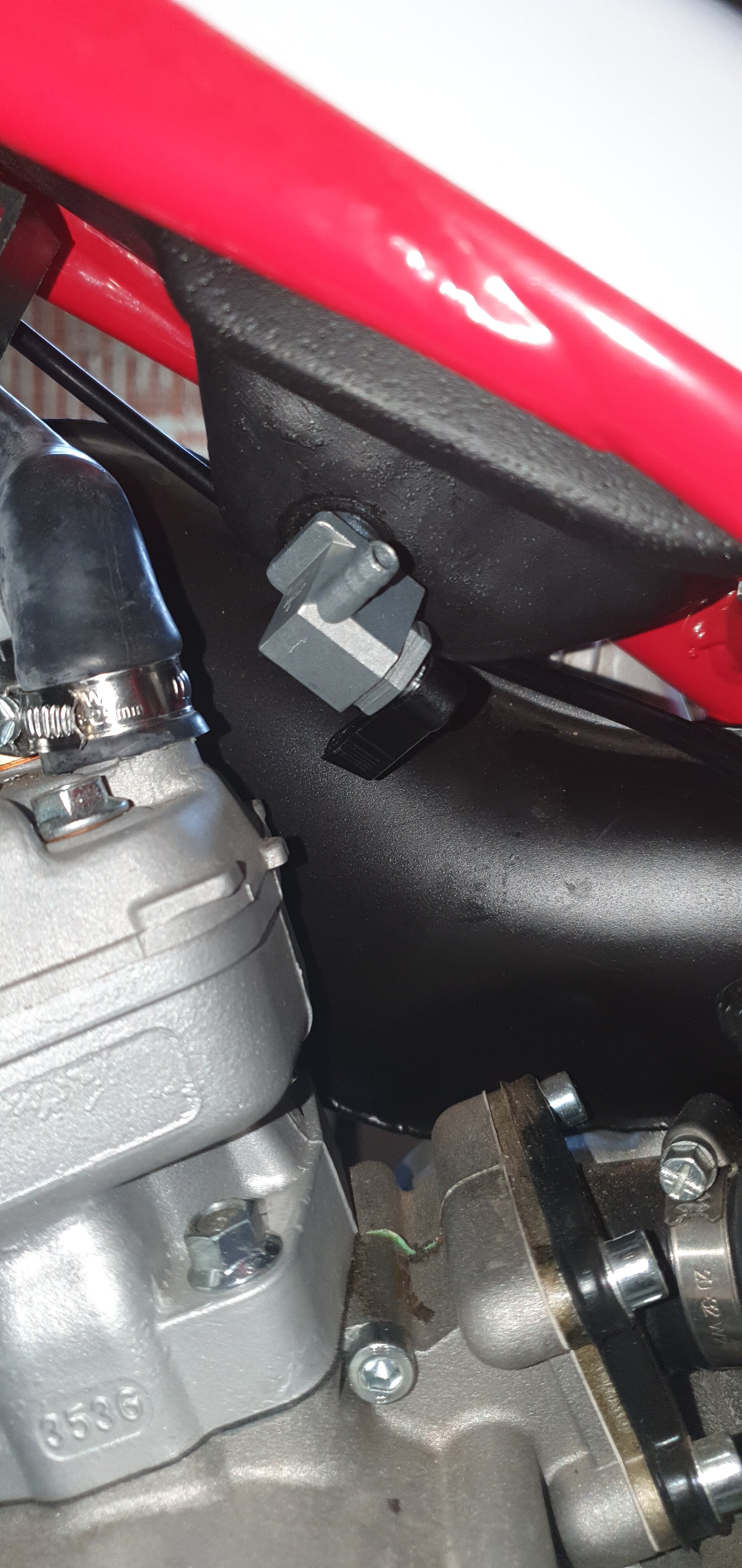

Hello.  Thank you for this.  This is the same tap I had, but I couldn't find a position where it didn't conflict with the other components of the bike.  I see how fibre washers may help tighten it down into a specific rotational position, but to me it seemed as though there was no suitable position at all.  I had the tank off and was there for hours mucking about trying to orient it so it would both function and not kink the hose.
I don't want to impose, but would it be at all possible for you to take a photo of your installation, so I can have a look.  I've taken a bunch of photos to supply to Jitsie in case they ask, so I would be most interested to compare.
Photo's of various positions I tried, to no avail.  I was trying to keep the fuel outlet oriented downwards as the system is gravity fed, but even so, it was very tight in there.  I wasn't the only one who looked at this either! lol

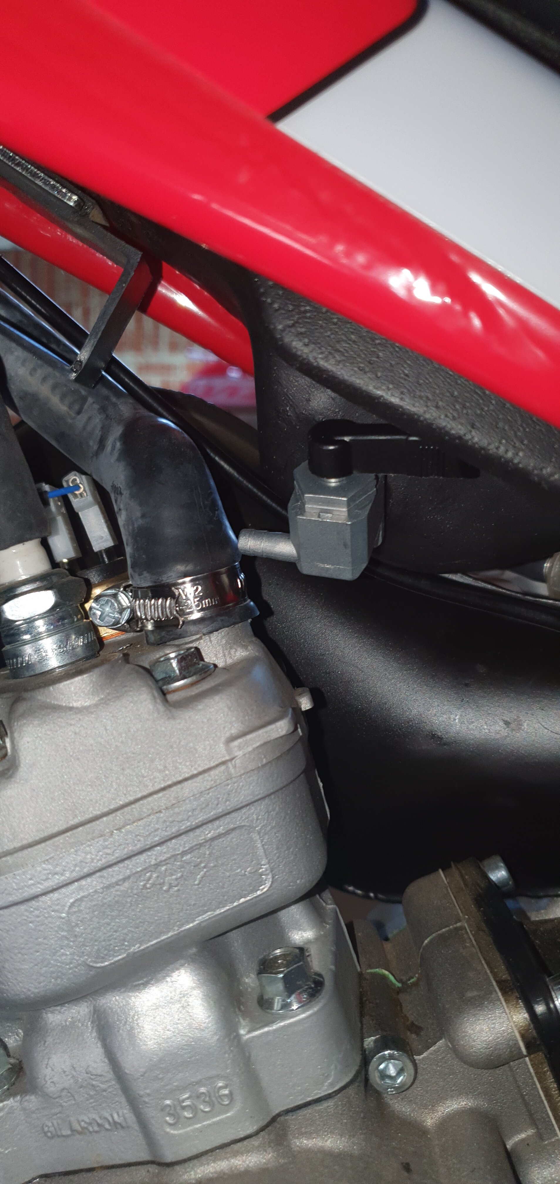

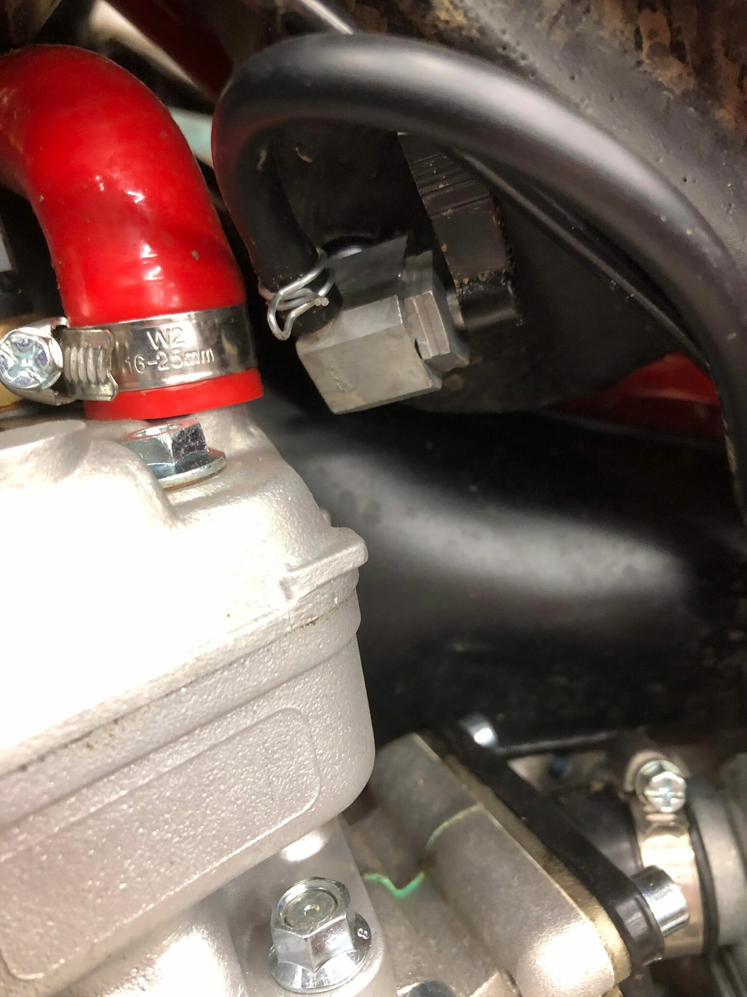

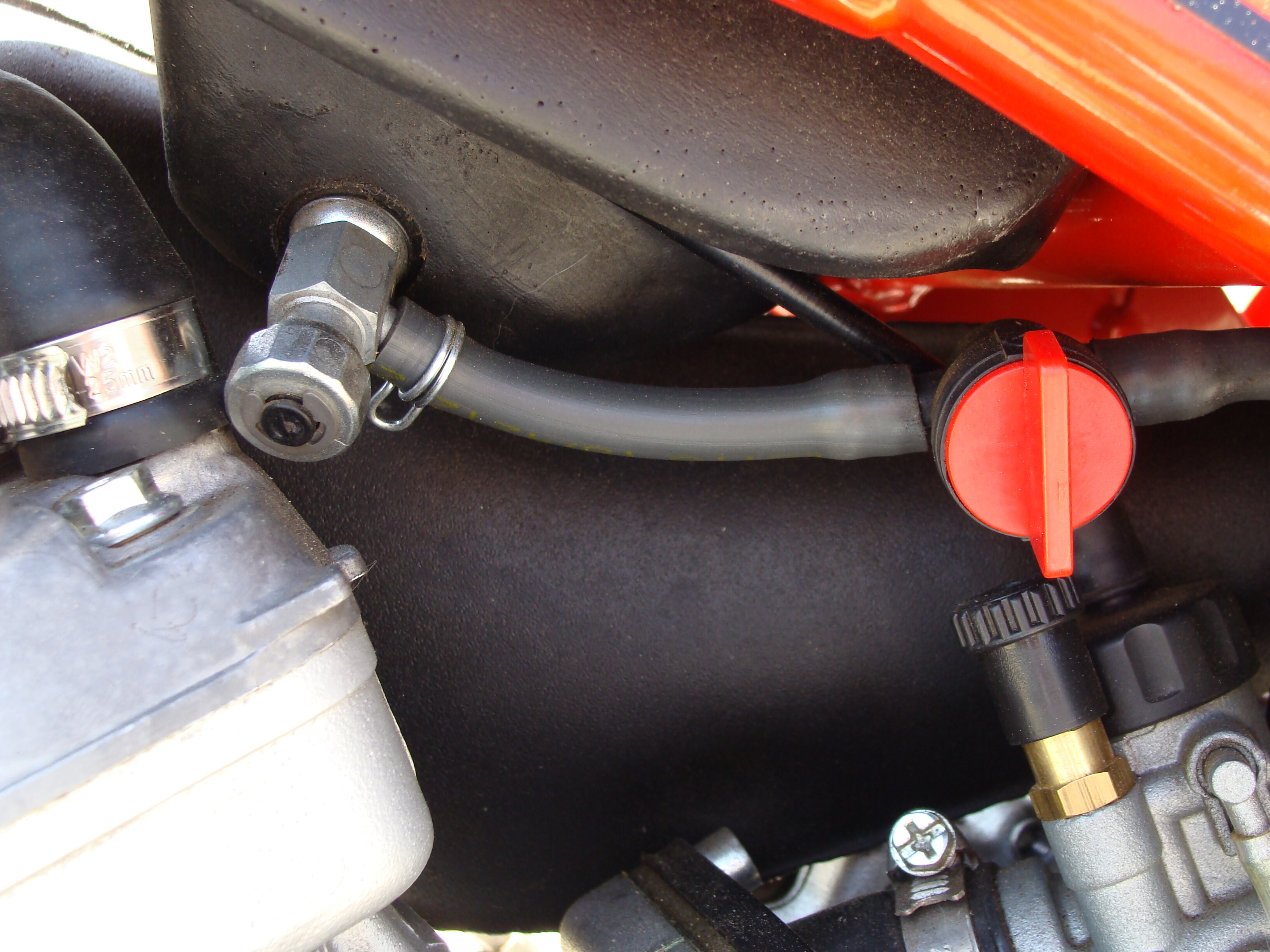

Just to close this off and in case anyone else has the issue in the future.
I emailed Jitsie customer services.  They have been excellent, going so far as to find a photo of the petcock (Jitsie Part: FTSHERCO3638) installed on a Beta Dealers sons' bike!  Can't really ask for more than that can you?
Photo attached.  The fuel does appear to run against gravity in the example and needs a longer hose, so I'd never personally have installed it that way without knowing for certain it would not affect the fuelling, but apparently it works just fine.
Cheers
