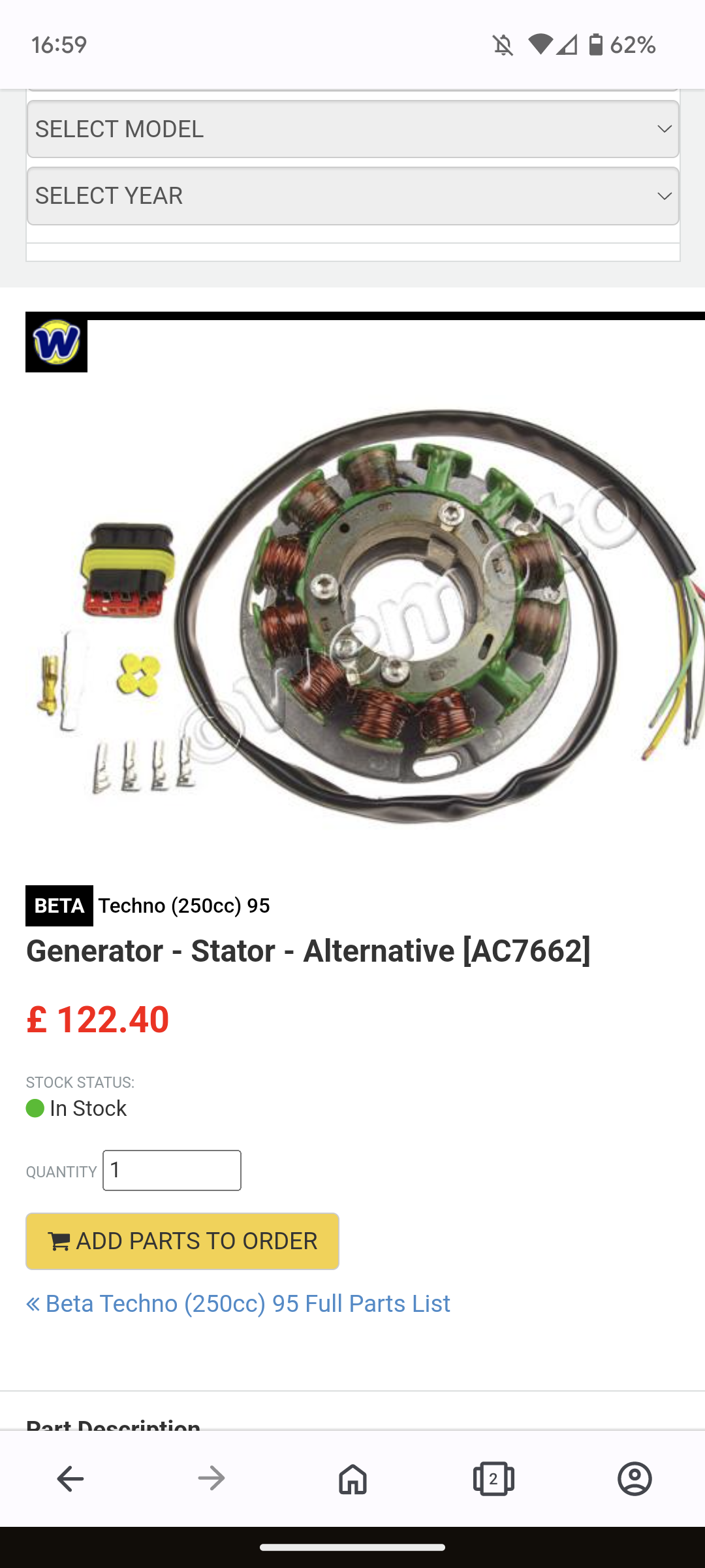

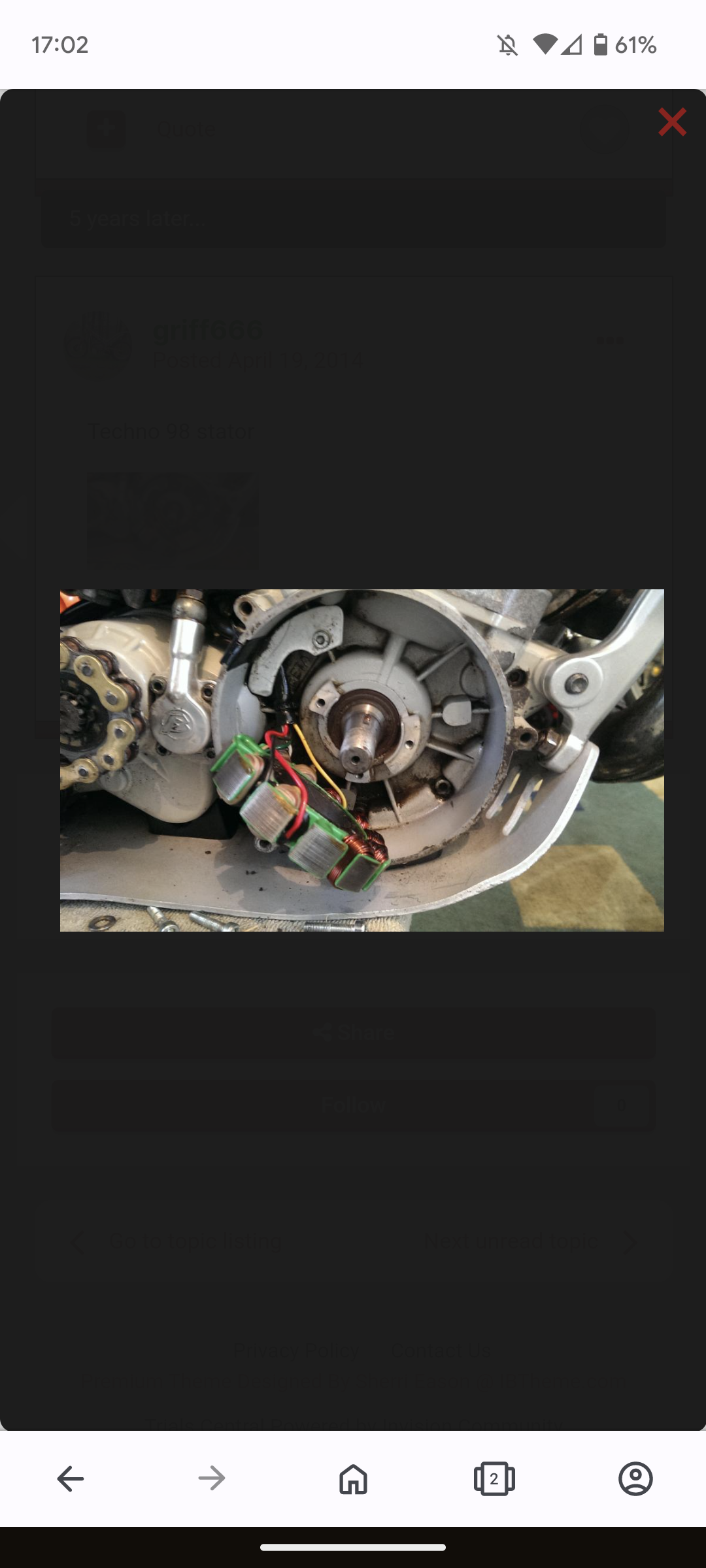

Im running the Ducati type ignition and my stator is mounted directly to the engine with no backplate or way of adjusting timing. Should this have a backplate? There's lots of photos of replacement items that all have a back plate with them.

I've attached a photo of what's to be found online and also the set up on mine (with stator removed)
Answering my own question here. Apparently back plate is '99 techno and rev models. Anything before that didn't have the castings or threads for the back plate so it's fixed. It also coincides with the 99 onwards having an upgraded CDI etc.
So it's not timing as timing is fixed on these. Well...not manually adjustable anyway.
