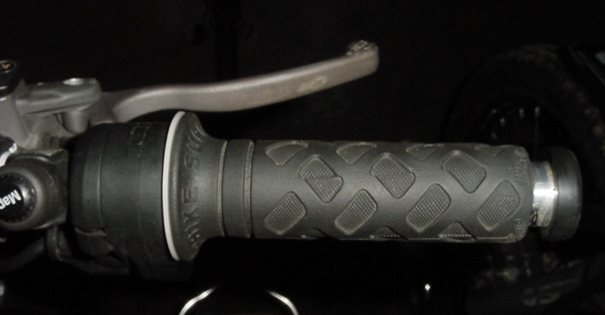

A stuck throttle is a safety concern on all motorcycles.  The photo illustrates three things I do to pretty much all my bikes.
White plastic "doughnut" between grip and throttle housing.  Grip cut well back so as not to interfere with my very robust homemade bar-end slider.
And a fourth: there's a dry graphite-based lubricant between the bar and the throttle tube.  And even a fifth: frequent testing to assure easy self-closing action.
