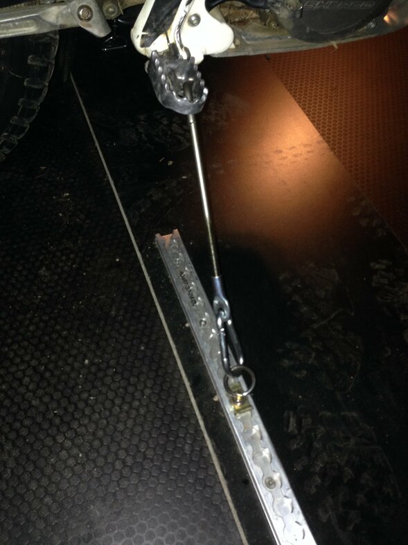

htrdoug Posted July 25, 2023 Share Posted July 25, 2023 I just use some J hooks anchored to the floor. Lean bike to center of van, hook one side, lean back the other way and hook the other side. Strap on front break lever. Different length j hooks for vintage and modern. 1 Quote Link to comment Share on other sites More sharing options...
Reffus Posted July 27, 2023 Share Posted July 27, 2023 I bought a Pro-works quick load and its rubbish for my bikes (4RT and Beta ALP) - just doesn't lock them down securely as I think the pegs are too low compared to MX/enduro bikes. I really like your set up @htrdoug - any chance of a bit more detail? Whats the rail on the floor and where did the solid rod come from? A quick Amazon search on J hooks doesnt bring up anything rod-like. Cheers! P. Quote Link to comment Share on other sites More sharing options...
BenFranklin Posted July 27, 2023 Author Share Posted July 27, 2023 As @Reffus says wouldn't mind a bit more detail on your setup @htrdoug. Looks like a good solution. Any links to where you got the components from would be much appreciated. I'll hold off on the quickload for now and see if I can get any more info, sounds like they might not be the greatest thing for trials bikes. Quote Link to comment Share on other sites More sharing options...
htrdoug Posted July 28, 2023 Share Posted July 28, 2023 (edited) I did this about 8 years ago so may not be totally accurate, you may need different lengths and sizes but my system works for trials bikes, very quick to load. Steel J-Hook Anchor for Wet Concrete, 3/8" Diameter, 8" Long (not positive on the length you will need, I bought multiple lengths to accommodate both vintage, modern, and whatever I wanted to haul)https://www.mcmaster.com/91588A111 Quick-Adjust Load-Securing Track, 6 Feet Long(commonly referred to as L-Track) https://www.mcmaster.com/39695T41 Eye Nut-Style Hangers, 3/8"-16 Thread, 2" Long https://www.mcmaster.com/91705A600 1000 lbs. Capacity Tie-Down Ring for Quick-Adjust Load-Securing Track https://www.mcmaster.com/39695T51 Zinc-Plated Steel Carabiner - Not for Lifting, 300 lbs. Capacity, 5/16" Thick, 1/2" Narrow-End Inside Width https://www.mcmaster.com/3933T14 As a added bonus Moto- Cinch also works on the L-track, but Moto-Cinch I have won’t quite hold a trials bike down securely enough and the securing pin won’t fit through all Footpegs. I do see Moto Cinch does have a shorter model now. And I don’t run the hooks through the pegs anymore, just catch them over the top. Edited July 28, 2023 by htrdoug Quote Link to comment Share on other sites More sharing options...
