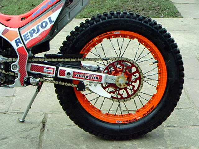

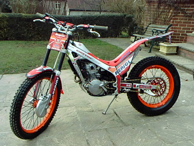

Quality pics mate, looks like top notch stuff, any problems with scuffing/scratching?
Also, where did you get your frame boot protector from for the sherco?
Cheers
Andy
The polished edges soon buff back up if they scuff, the powder coated rims will chip if they get a very hard knock but the colour touches in fine. Go on Andy give em a try!! you`ll love em!
regards
Howard
Obviously being a man of experience, which do you recommend, anodising or powder coating?
Cheers
Andy
Sorry Andy forgot to mention the frame boots, its just Technosel Carbon cut carefully and it goes on a treat with a bit of heat applied to the frame. It looks better than the standard factory patches which only tend to catch and tear.
The colour realy determines which route you go down Andy, some of the colours such as the repsol orange only look right when powder coated. I suppose anodising is a more practical finnish it will scratch rather than chip if the situation arose, they all look stunning and very personnel.
