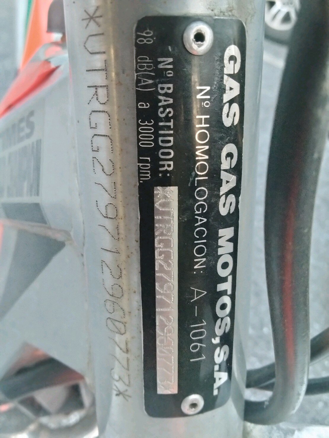

Newbe here,
I’m interested in buying my first real trials bike. I’m 64, and been dirt riding for 54 years. I raced scrambles in ‘72 and ‘73… but competing in that form wasn’t my cup of tea, I preferred finding a difficult gulley or steep gravel pit walls to learn technically challenging skills instead of all that fast stuff. Did all that stuff on run-of-the-mill dirt bikes,
now I have a chance to buy this machine, and want to learn as much about it before I do, ,,,
so tp start off, what does the serial number tell me about this machine

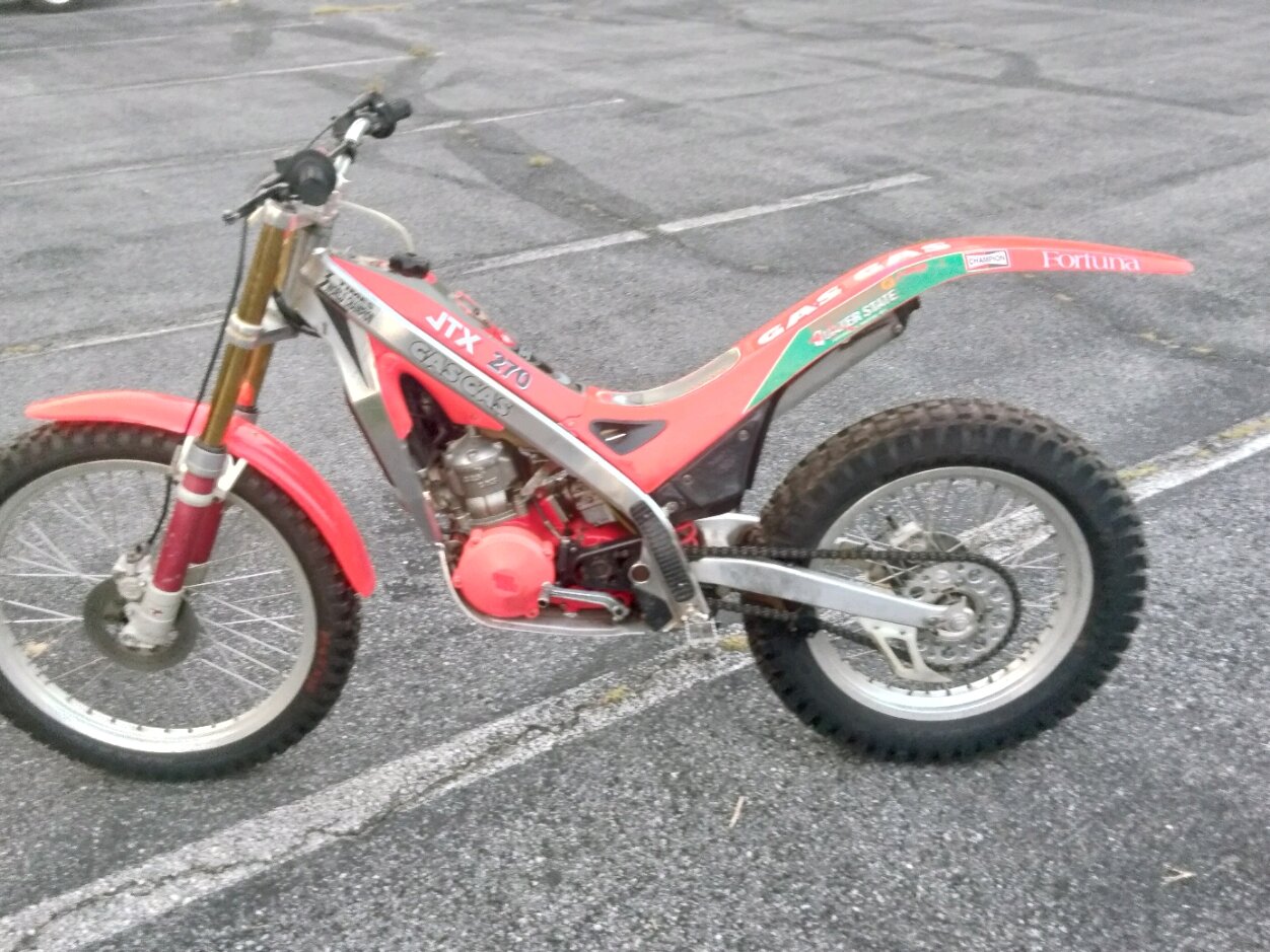

I bet it's a JTX270 from 1997 but you could tell a lot more if you could see the rest of it, front brake is candidate for upgrade, does it start easy and run good 👍 that's the main thing.  Compression test is always a good way to start evaluating an engines condition if that is an option.
If the compression is poor are the parts still available for freshening up the top end? And where do I learn about upgrading the front brake
Ok, thanks,two answers for 1997. I see 97 in the serial number.

First off we have no idea what part of the world you live in so your availability to procure old gasgas parts is difficult to predict.
Your front disc brake has 2 pistons, after Y2K 4 piston brakes became the industry standard and 4 pots offer noticeably better performance.
Top end is part of it but from what I've seen with gasgas over the years, the main bearing seals are another item that may well require replacement.
As previously; how easy does the bike cold or hot start?  <- That is possibly the most important indicator of the bikes current health and worth.
Most parts are out there, they are not getting any easier to find. Some parts are shared with other bikes or common bearings/seals to other things. Compression should be around 150psi.
If you are worried about finding a piston for it call around and see if there are pistons available for it. I suspect a piston will be one of the easiest parts to find, plastics may be some of the harder stuff to source.
Few years ago I had an 02 edition, always found what I needed eventually, sometimes a bit pricey. It's more of a hobby once you're chasing parts.
BTW I think that's a good looking bike, I like the frame and the graphics!
