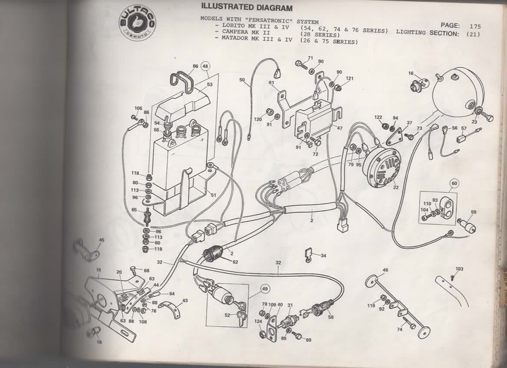

You're welcome.  Here's a scan from the parts book that includes your model.  It appears that the rectifier is mounted under the fuel tank, but consistency often varied, and your bike may be different. Scan_20230930.thumb.png.a82a8c714881d0804cbc85a854021670.png
Thanks again.  I do have that parts book, but my last Lobito had the coil mounted under the tank, but now I'm wondering if it had been relocated by a prior owner.
