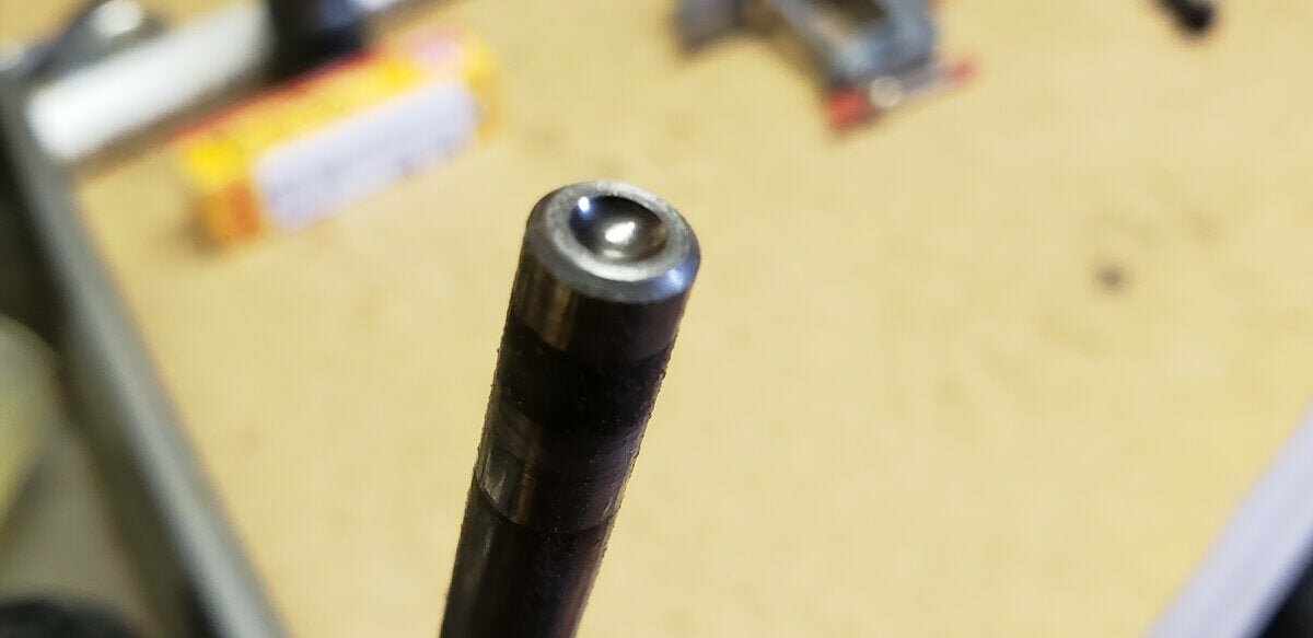

My clutch push rod has been misplaced and before I order a new one I wonder if someone might have one handy and they ability to get an accurate measurement? 270CC model.

Not sure of the length but I know ends are heat treated for wear if u end up making your own rod ....remember the ball bearing that drops in first from slave cylinder side

There's also a dmple on the end that conforms to the ball bearing if I'm not mistaken.

I ended up getting really lucky and finding the original piece which is no longer available. It does have a slight divot as stevec mentioned. The chain rub block isn't available anymore so I drew it up and a local trials buddy is printing a nylon replacement,
