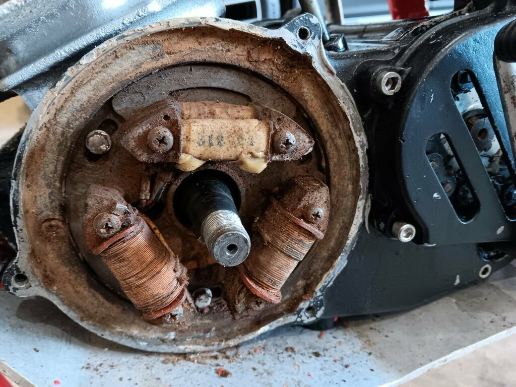

I am trying to get to see the ignition system to see if it is set correctly, which leads to me next question. How do you set it??

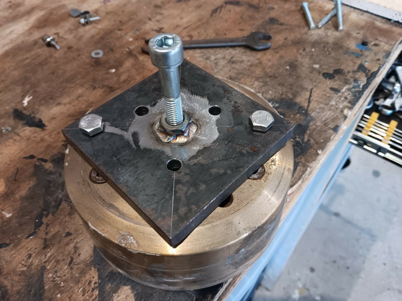

So I am going to make up a removal plate with centre bolt to remover the flywheel.
When I manage to start the bike it is blowing back through the carb, which makes me believe the timing needs adjusting. Not sure if it needs to be advanced or retarded. It may even be some form of pre ignition. It could also be a faulty CGI box. The list is endless. I will check the Suzuki system, should I need to replace the existing.
As for using a strobe, would I not need to find some timing marks on the flywheel?

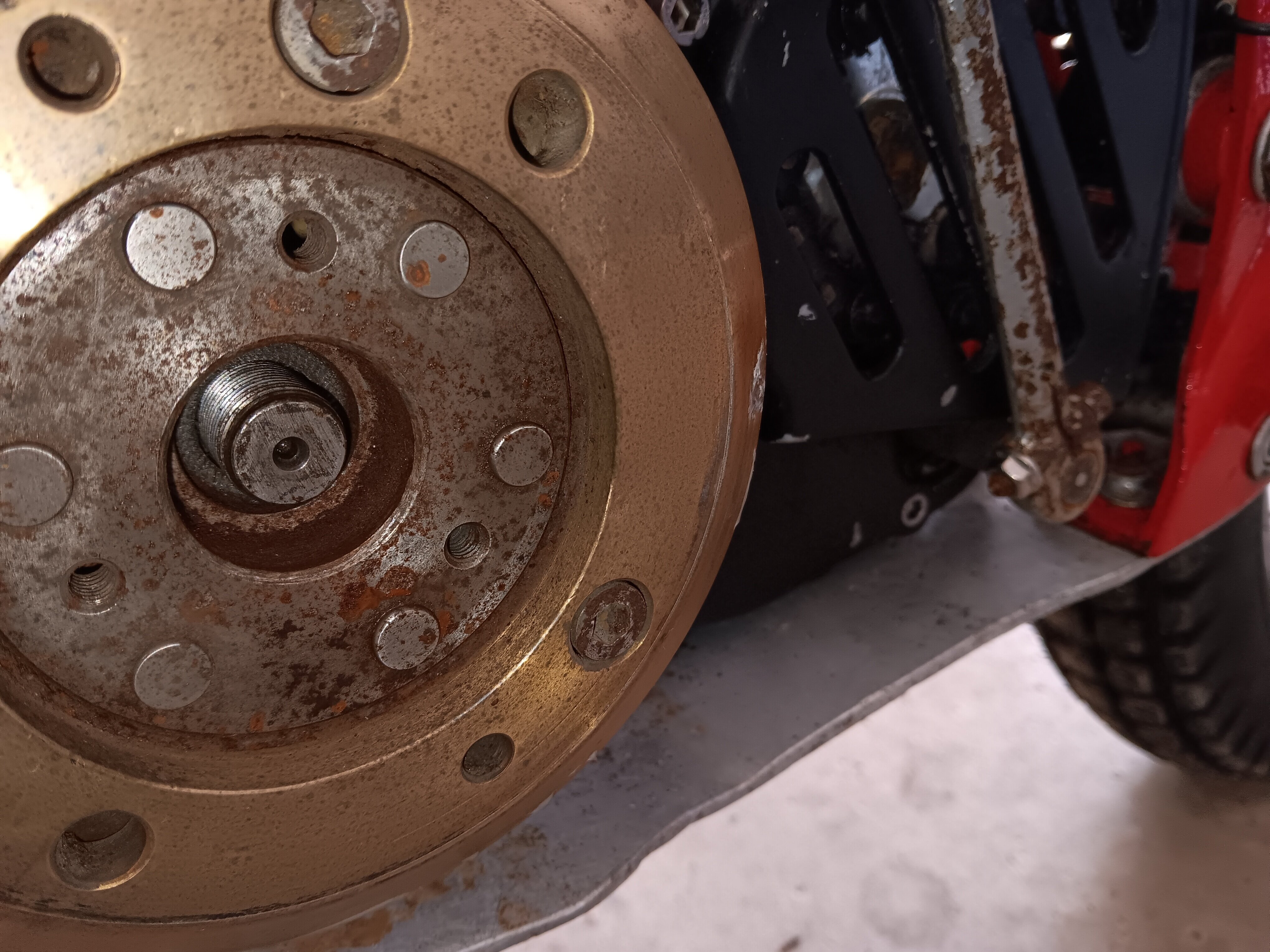

I just spoke to Sammy on the phone, and he seems to think that the flywheel has an inner threaded section for a screw-in type puller.
Will check tomorrow to see if the Maestro is correct.
If it is a Suzuki part that is exactly how it is done, there is an inside thread immediately around the perimeter of the locking nut and that should be visible on close inspection.
No such luck !
I can only assume that I need to make a flat plate puller, drill with 3 holes to match the threaded holes in the flywheel. Then drill a centre hole, weld on a nut, then ues a bolt to push to flywheel off. This maybe easier said than done.

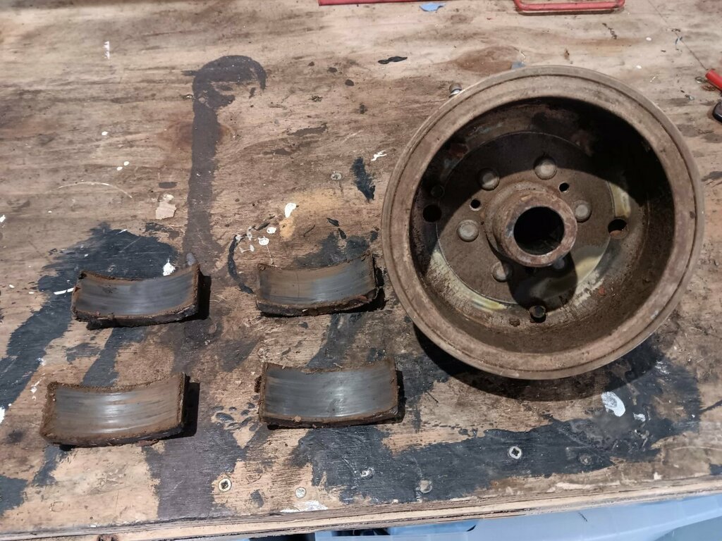

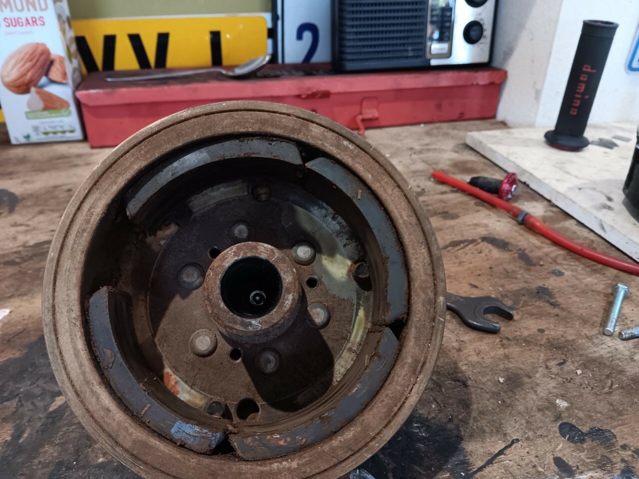

So, I managed to get the flywheel off with my homemade puller, only to be met with a corroded and dirty set of electrics, but even worse are the loose set of magnets. They have all shuffled around, not leaving a gap in between.
The corrosion has obviously weakened the original glue. Simple to clean and re-glue, if you know where to glue them.
I guess they are to be equi-spaced around the inside of the flywheel, but where? I would think they have to be correctly positioned in relation to say the keyway.
Does it make a difference if you just simply set them equi-spaced. Maybe not.
There does seem to be a mark where one magnet may have been, so if they are equi-spaced, I can position the other three. Bit of a risk, as you only get one chance to get it right!
Does anyone have a picture of said flywheel with magnets installed, or any advice. Maybe put them in with some good double sided tape or silicon. Once I find the correct position, glue them in properly.

they do appear to be equi-spaced. I think you will have to check timing after fixing them. You will need a dti to find top dead centre and then the required firing point so that you can mark the flywheel if it isn't already. The copper coloured coils are just for lighting and should be removed if you are not thinking of adding lights
What a mess!  I don't envy that job at all.  When reinstalling the magnets you must alternate North and South poles around the perimeter like this: N-S-N-S.  You can check it with a compass.  I don't think it matters if an N or an S goes by the keyway.  But to be safe, maybe teamferret could check his?
No, it does not matter, have rotated one on its centre and randomly put one on a villiers engine
Hi Guys,
It worked perfectly. I did a temporary "sticky tape" test and the engine started 2nd kick.
I will now use the permanent glue.
