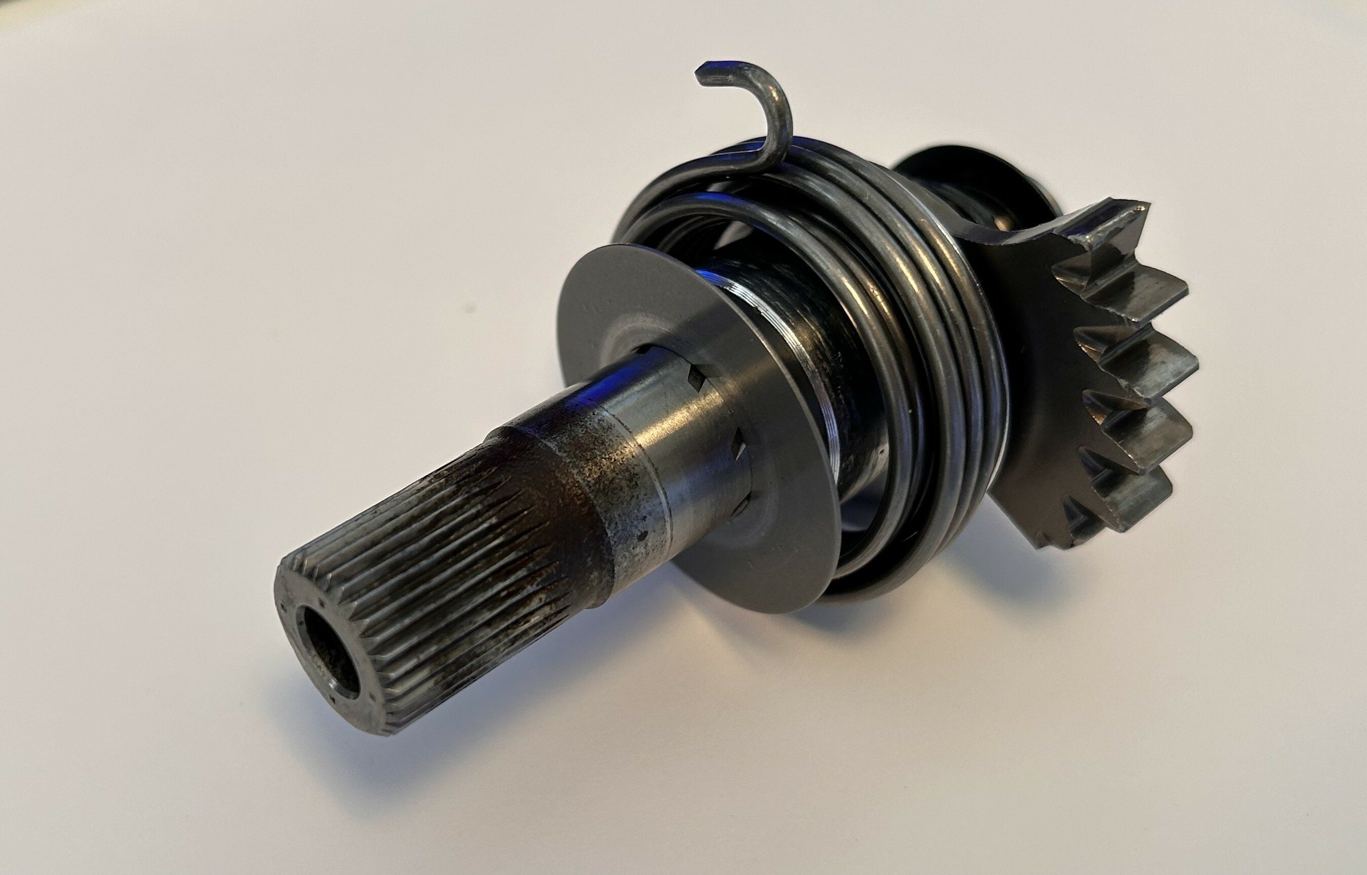

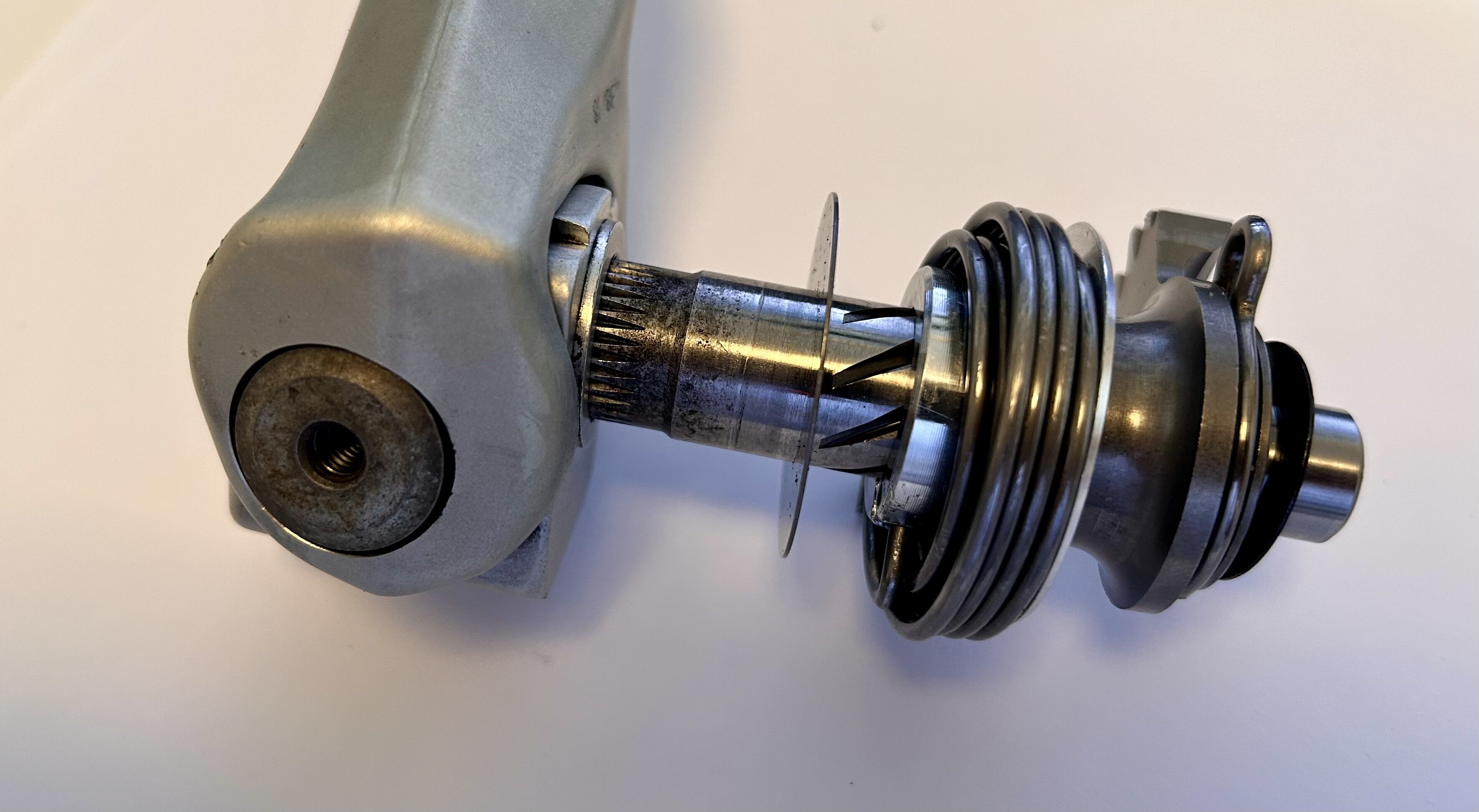

Seabag Posted July 17, 2025 Report Share Posted July 17, 2025 Is this kickstart shaft the same as V-0231 – KICKSTART SHAFT? I'm having trouble getting the parts to fit together properly. My bike is a 2019 Vertigo Vertical Combat 250cc, and I'm using the original Vertigo kickstart lever. However, I can't seem to get it to fit correctly onto the shaft. I was expecting there to be a groove or slot in the shaft for the cross bolt on the lever to lock into, but it doesn't seem to be there. Quote Link to comment Share on other sites More sharing options...
Tr1AL Posted July 17, 2025 Report Share Posted July 17, 2025 @Seabag The kick pedal slides on the splines and then a allen bolt goes through a tophat washer and is screwed into the hole in the center of the shaft thus holding the pedal on the shaft , its best to use medium thread lock on the bolt or it can sometimes loosen off if it has been overtightened in the past. Check the parts book exploded view drawings to see how things are put together. Best wishes Alan. 1 Quote Link to comment Share on other sites More sharing options...

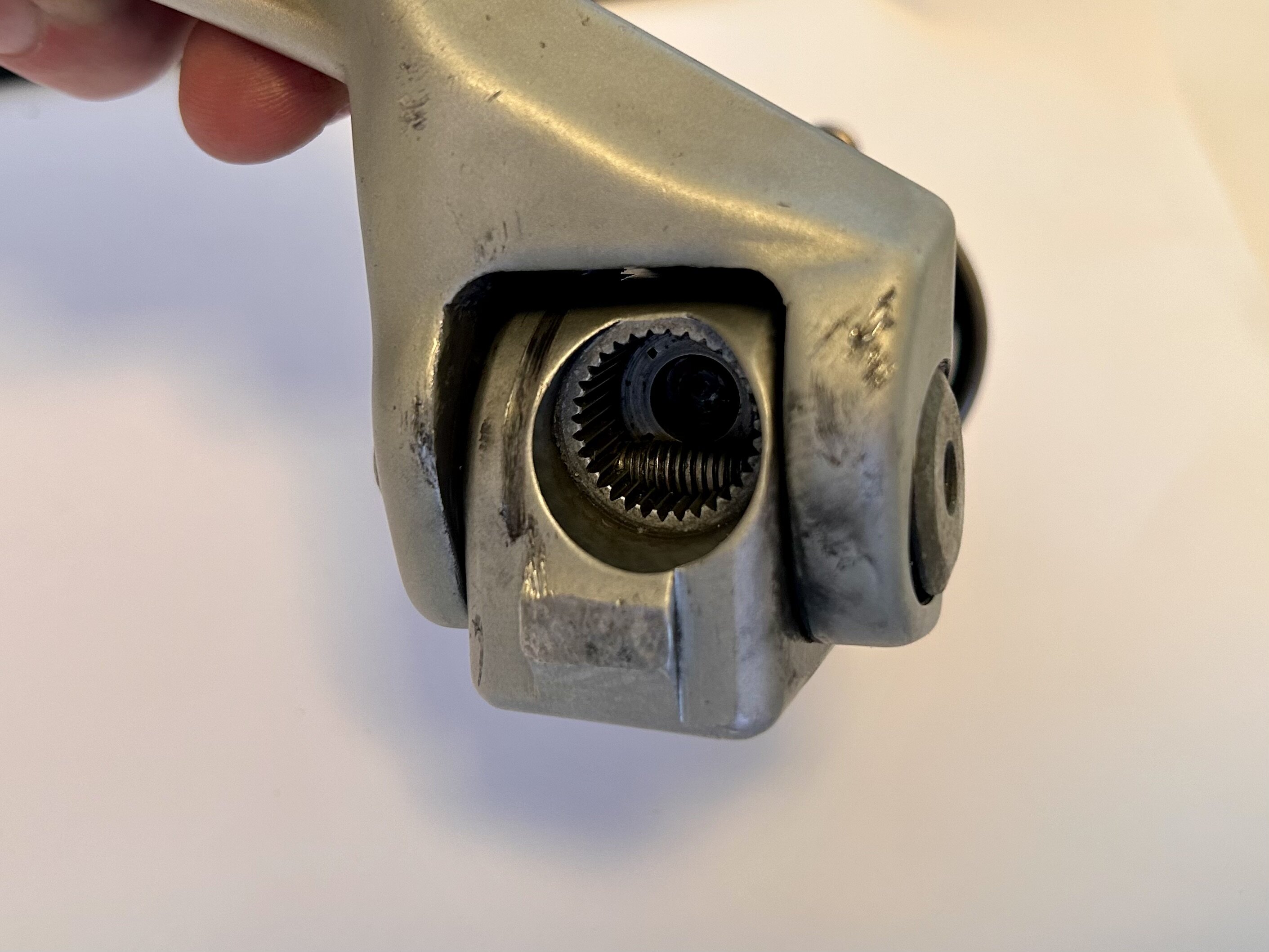

Seabag Posted July 17, 2025 Author Report Share Posted July 17, 2025 (edited) Mine can't slide all the way. It's stopping about 1 cm short and seems to be blocked by the Allen bolt. — I guess thats normal? Edited July 17, 2025 by Seabag Quote Link to comment Share on other sites More sharing options...
Tr1AL Posted July 17, 2025 Report Share Posted July 17, 2025 @Seabag Yep that is as far as it will go on . 1 Quote Link to comment Share on other sites More sharing options...
