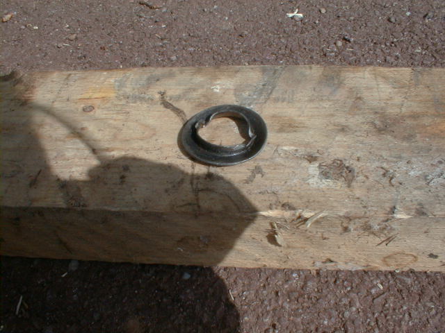

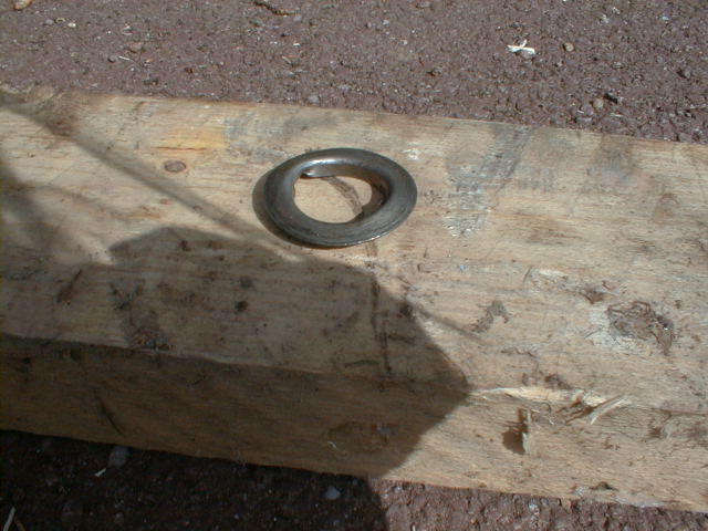

here are pictures of the dish shape spacer (damaged) for 1995 gas gas which fits somewhere on rear wheel bearing/ hub spacer but do not know where in relation to bearings or which side of wheel. any help appreciated.
Does this washer fit over the central spacer? If so its to help keep things lined up to make it easier to push the spindle through. Looks like its had a hard life whatever it is!
