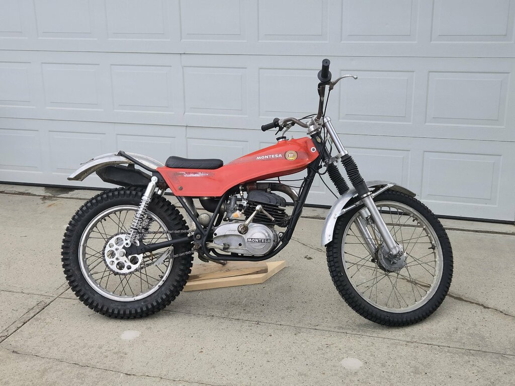

1977 Montesa Cota Ulf Karlson 247cc Rebuild
Well I am finally done round 1.  The Montesa is back together and running.  I tore it down to the frame, painted and rebuilt it.  New rear shocks, tires, seat and 1 new lower fork.  It took me 1.5 weeks to get the forks off and now I can rebuild the front end in 30 minutes. Fun and a lot of learning.
