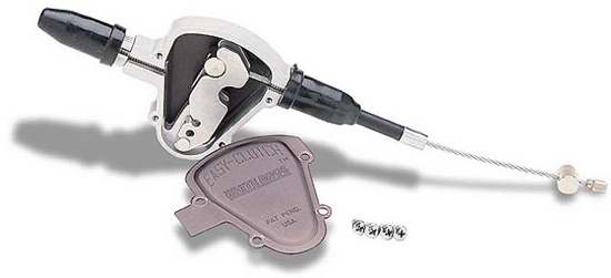

I've got a 74 TY250 if that's what you are refering to. Cable pull clutch. It was stiff, even after the new cable, so I put on an "easy clutch". There's a few companies that make them. Mine was made by O-neal. It goes between the cable and the lever perch. It's a small triangular mechanism that gives more mechanical advantage via a small internal lever. It's small not too expensive ( I think mine was $39 U.S.) and it really works. You can put them on any bike that has a cable type clutch. My buddy has one on his daughters Amigo and it really helps. The clutch on my 47 TY is a one finger pull now just about as good as the hydraulic clutches. I've included a pic of one.
