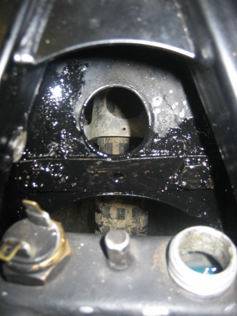

Here is the strengthening plate welded in postion:

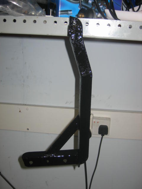

Here is the subframe I have made:

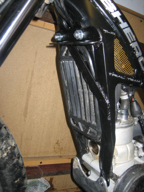

Here it is fitted to the bike:
Detail of the lower fitting to the engine bolt and sump guard bolt:
