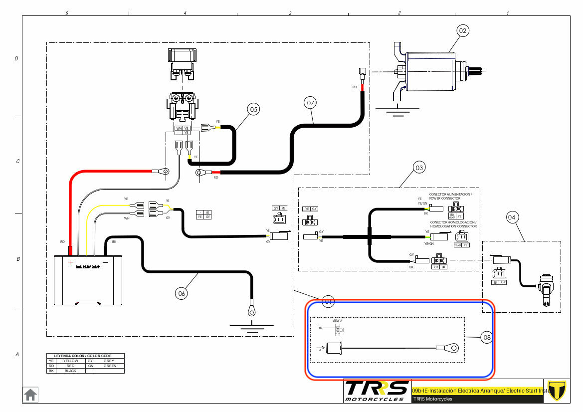

    Hi everyone. Here is some help just in case you need to recharge the TRS Battery Pack with a charger. This is the official battery manual to do so. You will need the TRS ADAPTER CHARGER BATTERY ELECTRIC START. Part no. 09016TR100 (No. 8 in the part diagram) Charger type: Use only a ferric lithium-ion charger. See charger description “LiFePO4” TRS Motorcycles do not sell full size bike chargers. You can check all your parts numbers, manuals, racing parts and accessories here: https://trsmotorcycles.com/Descargas See wiring diagrams and charging manual pdf. Any more questions, please contact your local TRS dealer, or importer or write to info@trsmotorcycles.com World wide TRS importers and dealers https://trsmotorcycles.com/Distribuidores Thanks to all. Carlos Echavarría S. TRS Motorcycles Colombia Charging TRS Battery.pdf

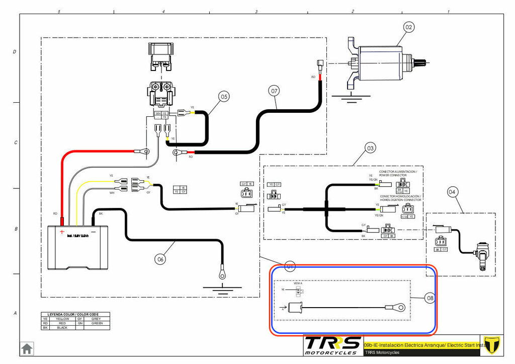

    Charging TRS Battery.pdfHi everyone. Here is some help just in case you need to recharge the TRS Battery Pack with a charger. This is the official battery manual to do so. You will need the TRS ADAPTER CHARGER BATTERY ELECTRIC START. Part no. 09016TR100 (No. 8 in the part diagram) Charger type: Use only a ferric lithium-ion charger. See charger description “LiFePO4” You can check all your parts numbers, manuals, racing parts and accessories here: https://trsmotorcycles.com/Descargas See attached wiring diagram and charging manual pdf. Any more questions, please contact your local dealer, importer or write to info@trsmotorcycles.com Thanks to all. Carlos Echavarría S. Charging TRS Battery.pdf
