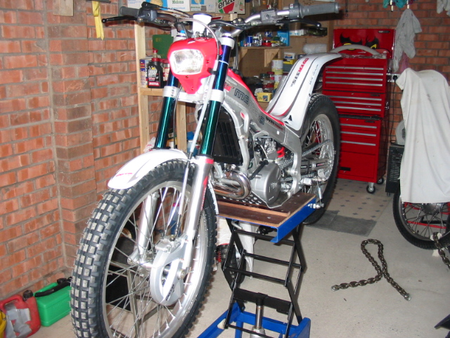

After the talk on here.............I went yesterday and bought a small clear one.............so to start off from day 1, on a new bike (only picked bike up Saturday).
Like Charlie says............it is possible..............but it is a tight squeeze on a 315R...........but can be done...........with a bit of forward planning........
The tubes don't get pinched.
On another note...............these modern Trials bikes are tight to work on.................removing the lighting kit and loom from the new 315R was a real performance.................
