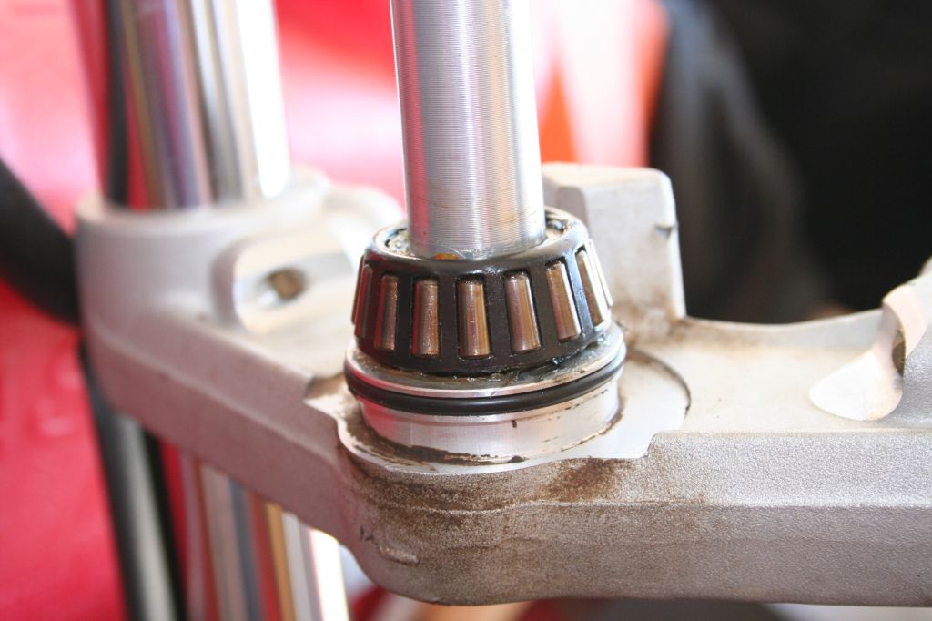

October 27, 200619 yr Author Alan, here's a pic of the bearing. Can you post a pic or link to the type of puller that you use to remove this bearing? Thanks!
October 27, 200619 yr http://www.grainger.com/industrial-supplie...ators1A807.html Napa should have one on the shelf, Not sure if it is in the Autozone loan a tool program. I think I got my OTC (Ottawanna Tool Company) one from Carquest? There are 2 common sizes available, you want the "small" although I do not remember how they actually class them. My big one is the harbor freight cheapie, although when I break it, I will probably spring for the extra money and buy an OTC or other quality product. This also works real well for bottom end bearing's on the crank. Hope that helps.
