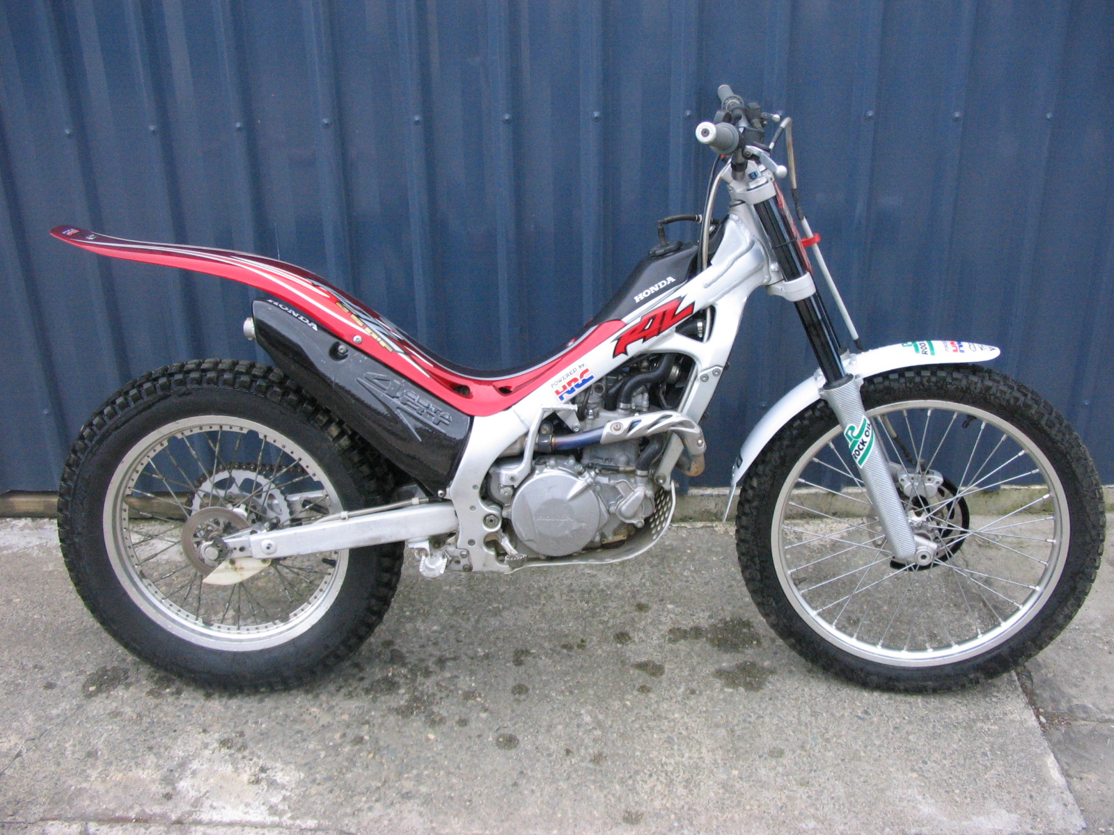

I just went with the RTL fender & painted the tank to make it look smaller ,
side view , Till I can get a Flat Tank ,??????

I've showed pictures of this before, last time with white plastic. I changed it back to the RTL plastic for a trials demo.

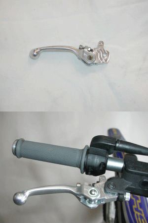

How do you find the ASV levers? I'm thinking of fitting a pair to my Montesa. They look good and I like the fold back and don't break aspect of their construction. Do you recommend them?
Ross
Hi
Ross
I got asked that a lot. Since the front brake master cylinder was changed to a Nissin it is the same front brake lever as you would get for a Honda CRF, that one was easy. For the clutch I had a old beaten up (but not bent) ARC folding lever off my sons old bike. ARC makes levers that fit trials bikes
So I got a generic ASV lever and cut off just the lever part. I then put that lever onto the base (the part that connects to the master cylinder) of the ARC. It took much drilling and filing, but I got it to fit. A lot of time and work just to have matching red levers.
I would highly recommend the ARC levers. My son broke levers all the time, I have saved a lot of money getting him folding levers.
Edited by sirhc
Thanks. Great advice. I've only seen ASV levers on MXers before. Also USD$70 a lever for one ASV buys a few more standard ARC levers.
I like the way the way that dude has done the frame with technosel, very nice bike!
Its the black frame sticker set made by Mitani.
