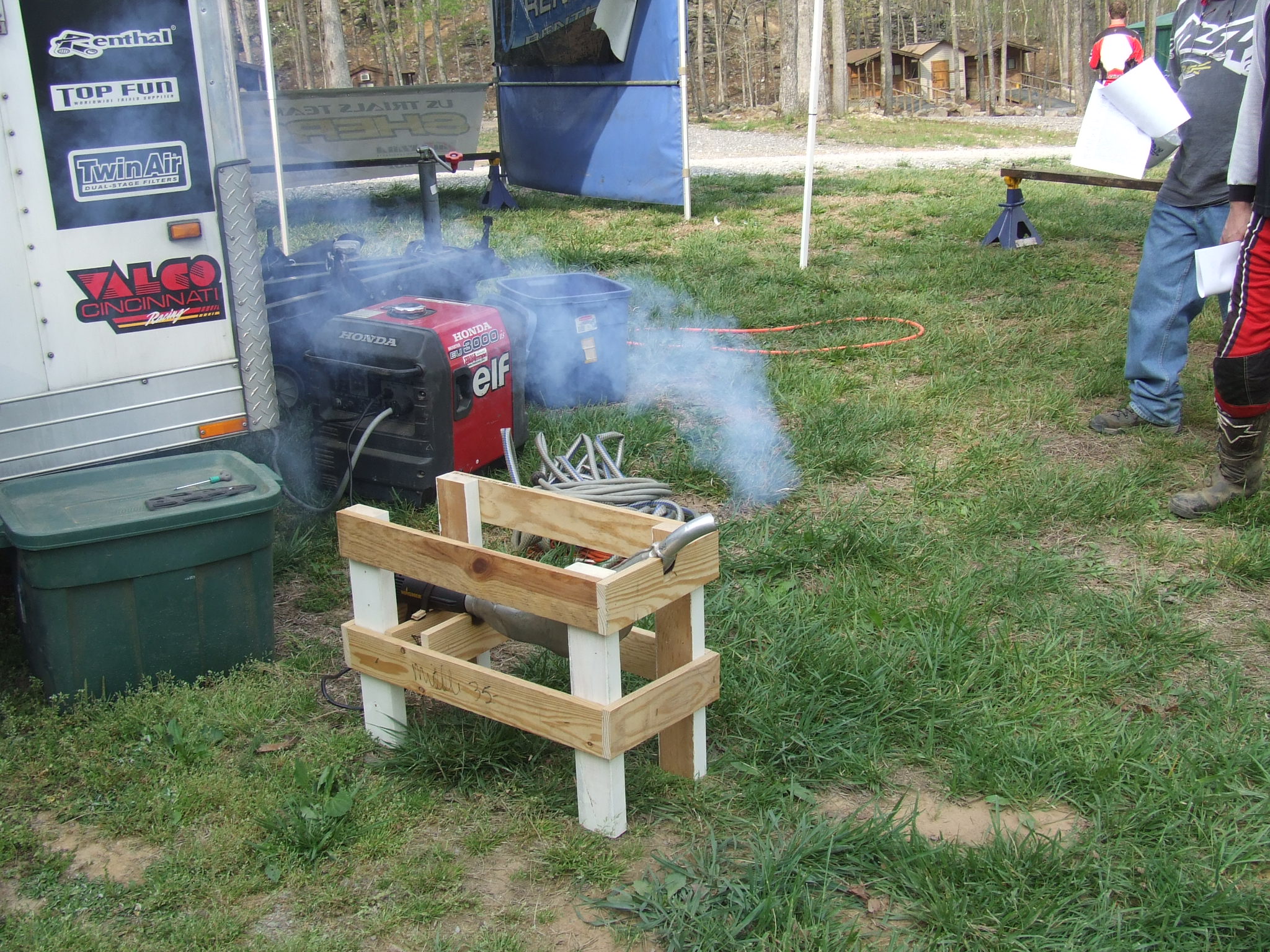

copemech Posted October 10, 2008 Share Posted October 10, 2008 (edited) I'll have to sort you muppets on this, soon as I find the piccies! Here we go! You will need an industrial heat gun that has a selectable switch, fan, off, heat! Most of these seem to well fit the Sherco muff inlet! Some scrap lumber can build you a rack to fit it! Edited October 10, 2008 by copemech Quote Link to comment Share on other sites More sharing options...
copemech Posted October 10, 2008 Share Posted October 10, 2008 (edited) After you turn on the heat, it may smoke for awile as in previous pic. If buildup is signifigant and enough to support combustion, it will ignite! This may take some time. You will see flame at the tip! Time to cut off the heat and just let the fan run to provide air to feed the flame! Edited October 10, 2008 by copemech Quote Link to comment Share on other sites More sharing options...
copemech Posted October 10, 2008 Share Posted October 10, 2008 If your muff is Soooo loaded up with fuel and oily residue that it continues to burn too long, there will be excessive heat buildup! This excessive build up and burn time can cause irreperable damage and a sinking feeling in the gut similar to tying a rubber band around your dangly parts and them falling off! Logic tells me that a pre-flush with solvents to remove as much residue as possible, as per BS, may help prevent an overheat condition, yet you would want to well vent it first to remove any residual HC vapors. Normally I would say they should self extinguish within a minute or so. Additional cooling for the ali, via water or ice pack may be an option and well advised. Keep the ali COOL! If you total it, you probably needed a new one anyway! Don't blame me. None of this is approved for general use and extreme caution should be used at all times as personal injury may result! You have been advised! Quote Link to comment Share on other sites More sharing options...
