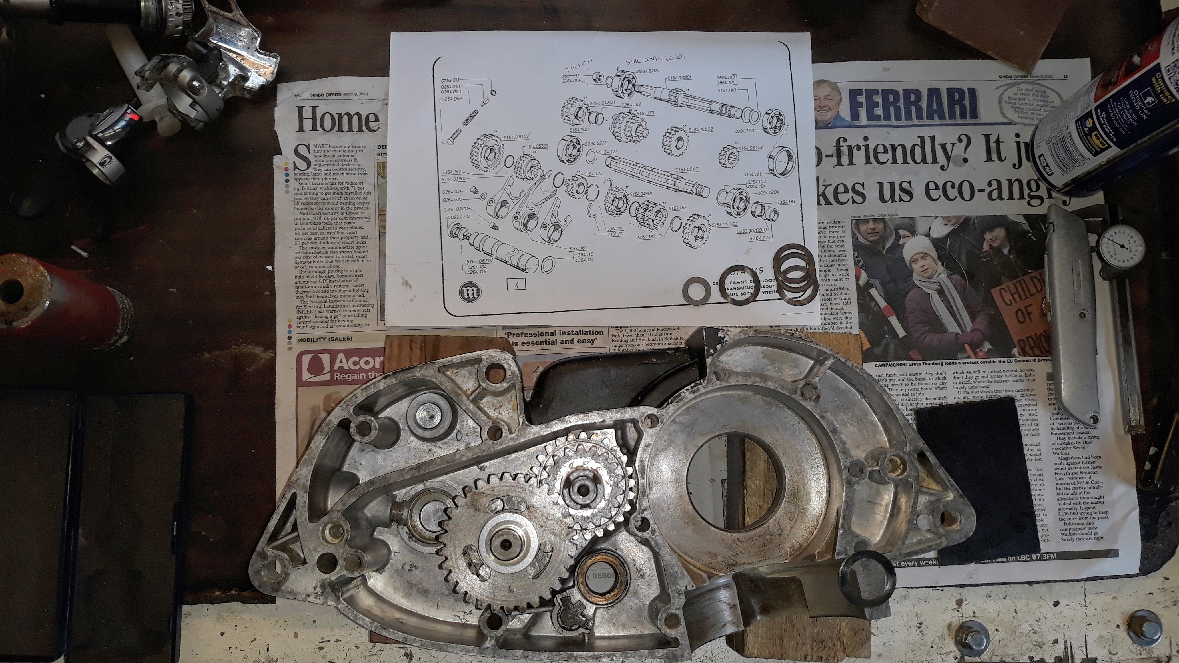

Well for various reasons I still have a 349 engine in many pieces after all this time, but it's now come to the front of the queue yay!
But I have no idea where to start with the gearbox shims, any clues?  Do I centre the shafts or is one side the "reference" and you shim the opposite side to take out the play, or what?
And should I assemble in the right case?  I recall reading that somewhere.
Thanks for any pointers.
