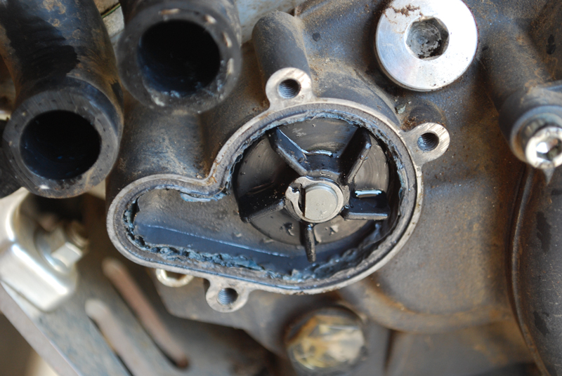

Out for a long ride today and the water pump started leaking. I took it apart and this is what is there - http://www.ebizviewer.com/2008BetaRev3.jpg .
Can it be saved or should I be getting a new internal clutch cover? It looks like the corrosion has prevented the o-ring to be held in place.
I think the part no is 12-62663-0-67.

That looks buggered. On the plus side the new cases are made out of different stuff and aren't supposed to corrode. It's also an easy job. Make sure you use a good quality coolant premix as well.

My '04 Rev3-250 and my '06 Rev3-200 did the same thing. Both bikes were used, I replaced the clutch side case, seals and bearings. I use Honda coolant and replace it often. NEVER dilute with water! The Beta dealer should sell you the parts at costs. Seems to be a common problem.

It's a very common trouble on Beta's. The cause is that the cover is made in magnesium, and magnesium is one of the most easy materials to be corroded, especially if it's in contact with other metals. It's a problem of erosion-corrosion.

Thanks for the info. Should I be replacing all of the seals and bearings at the same time as the case or can they be popped out easily enough?
You need to remove the bearing and seal from the pump to mount it on the new cover. You will need a new seal. If the bearing is damaged, replace it too.

I found the same thing on the used 2003 Rev3 I purchased recently and had to replace the cover. I was told to check for it as it is very common problem with the magnesium. I found it just in time before it ate its way into the engine cavity. To my surprise the worst of it was behind the impeller. It's an easy fix with the new cover and you'll know what needs replacing once you remove it. Mine looked worse than yours and I only needed to replace the seal behind the impeller in addition to the cover. When you replace it stay away from glycol based coolants. I was told a couple brands to use and ended up going with Silkolene ProCool. Also if the bike goes into storage for a long period of time drain it to be safe.

you could try removing the the bit of inner lip thats left with a small file, then when its flat use thick, oil resistant gasket paper and make your own gasket.
I know this is it a bit '' bodge it and scarper'' but if doesn,t work, well it was buggered anyway...
If nothing else it might just get you to winter.
