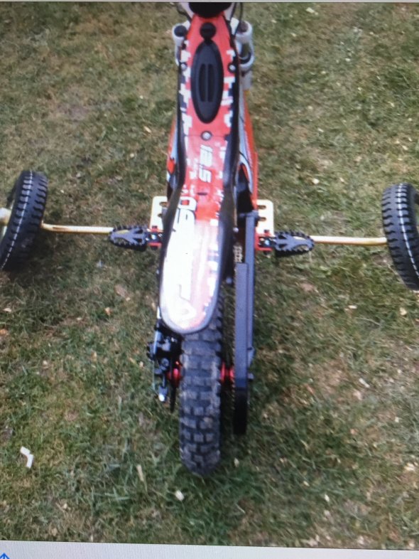

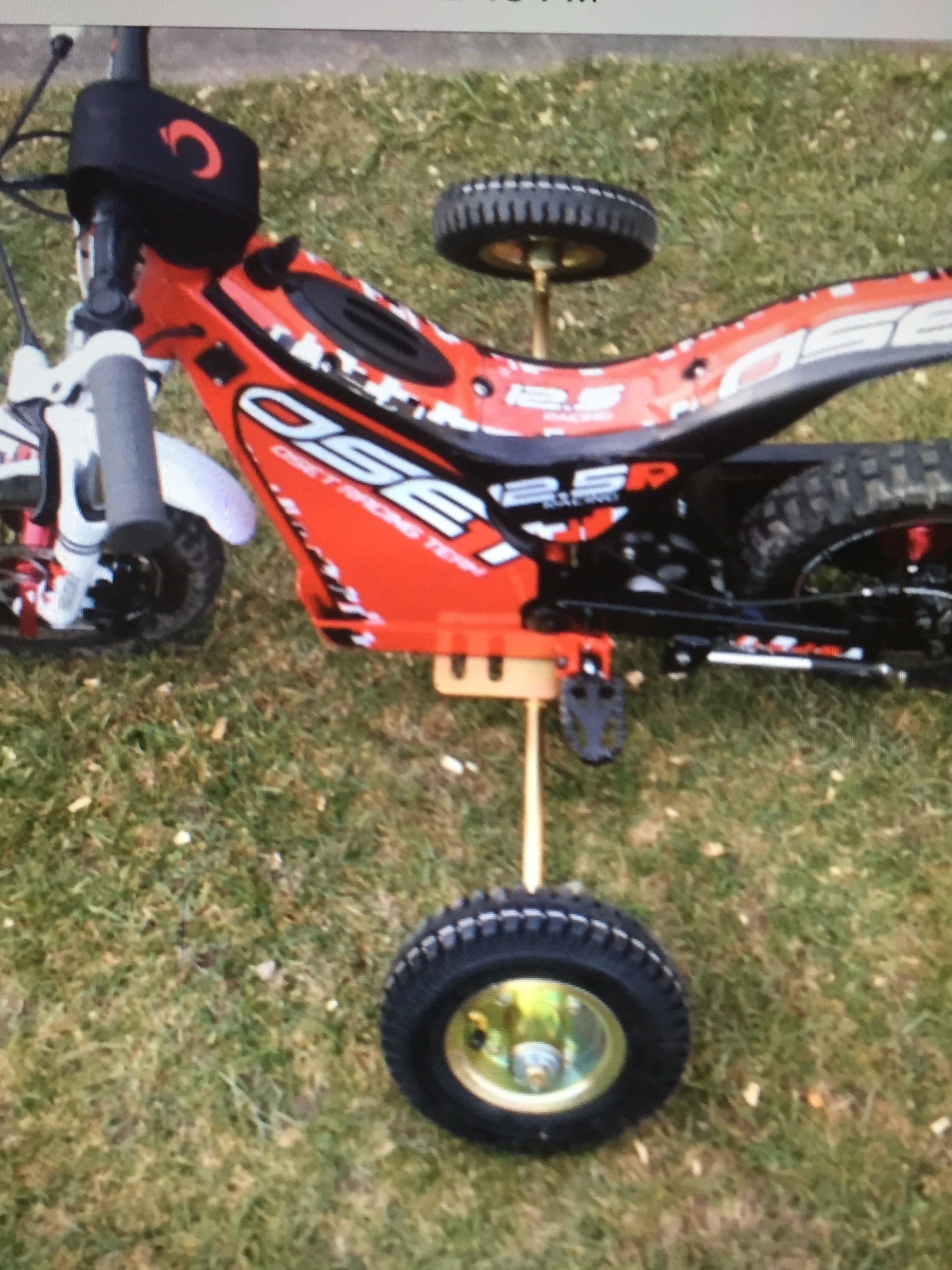

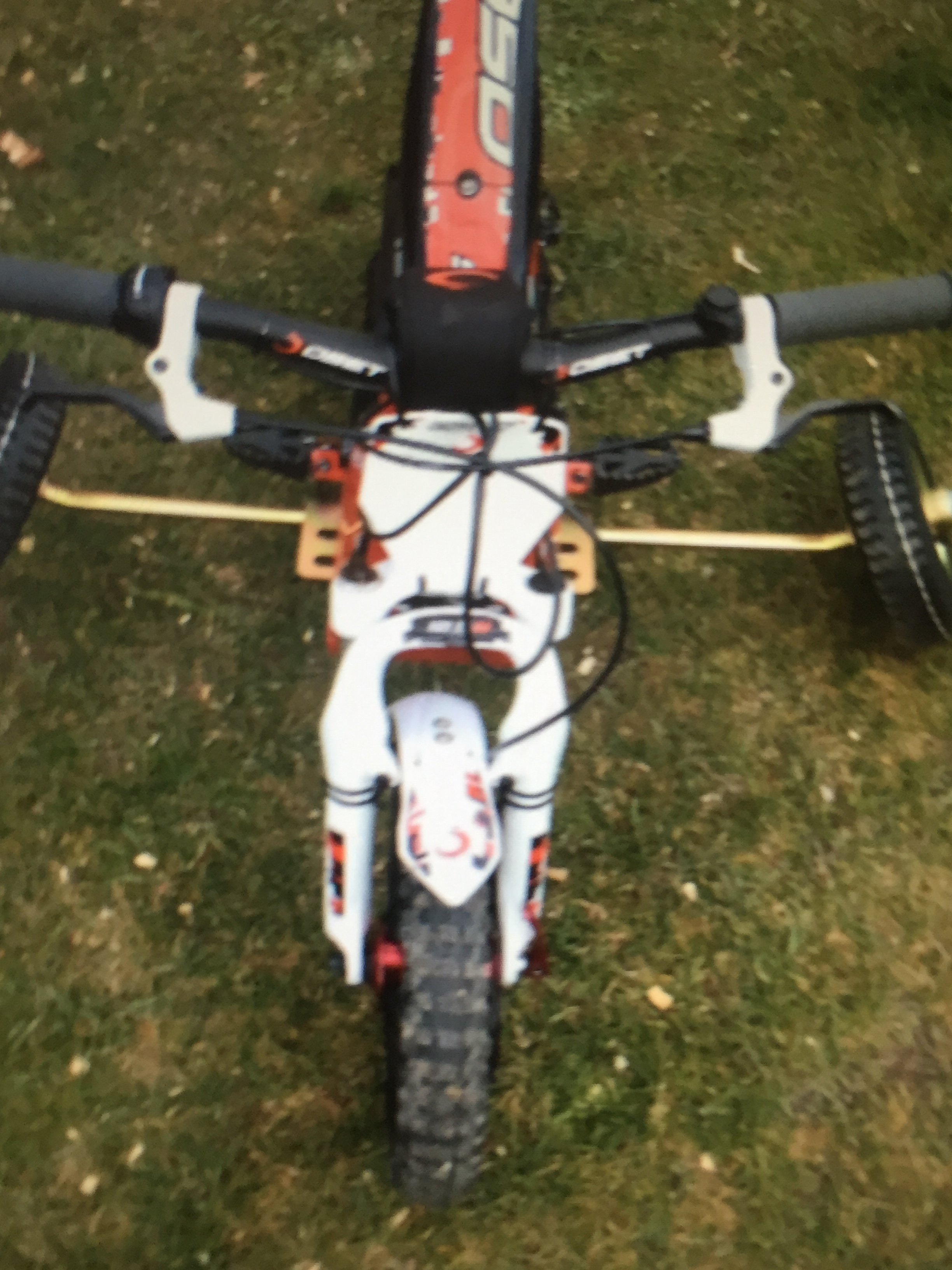

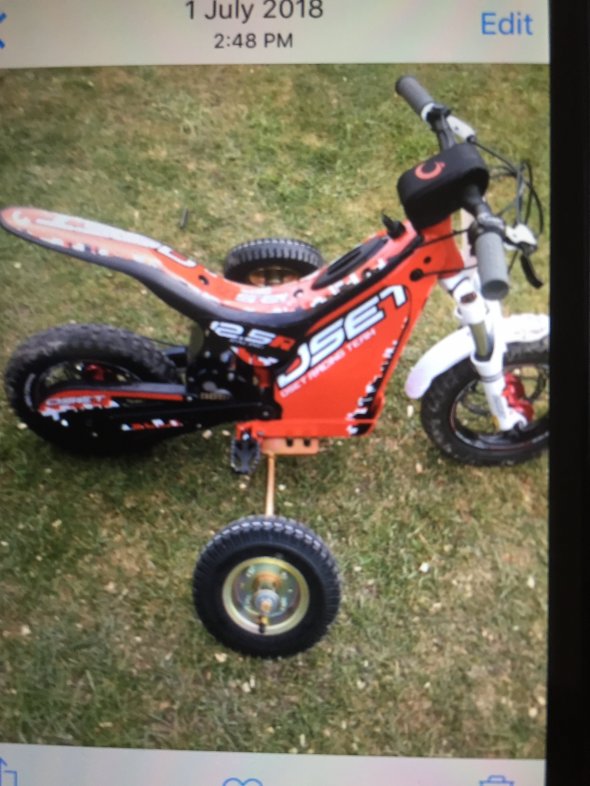

March 29, 20206 yr On 10/24/2009 at 9:27 PM, pete_scorpa3 said: I've been using rear mounted ones on my four year old daughters 12.5 Oset. She can ride without them on larger open areas but still uses them in the tight confines of my small back garden. Modelled here by her younger sister. Hi, these just look like regular bicycle ones? Just tried fitting a cheapo pair and they started bending with just the weight of my hand on the bike so removed them.
March 29, 20206 yr 13 hours ago, Lukeinlondon said: Hi, these just look like regular bicycle ones? Just tried fitting a cheapo pair and they started bending with just the weight of my hand on the bike so removed them.
