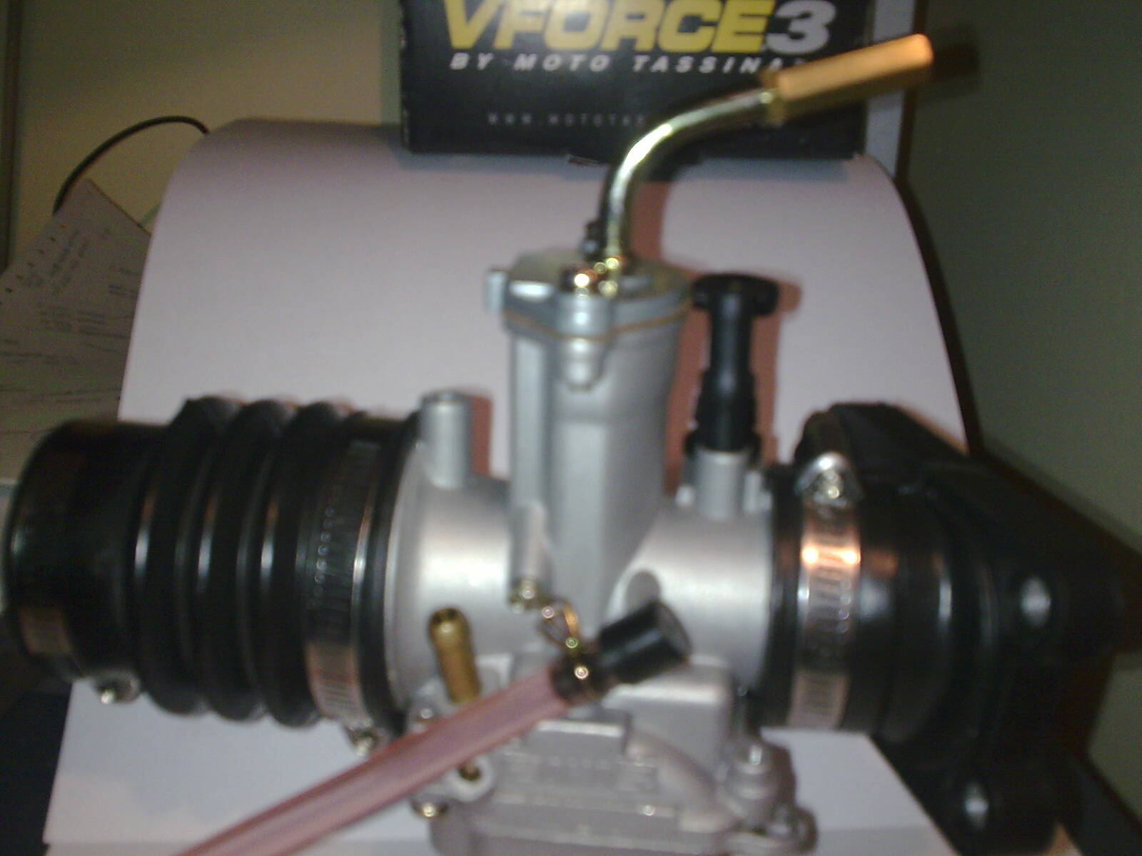

Must be my birthday, carb & manifolds arrived today with spare JJF needle & #42,45 pilot jets & #122,125 main jets to fine tune jetting. ^_^
The carb top has an right angled top with the instructions saying the standard dellorto cable guide screws in if needed, this should be of use to those guys who have one with the straight upward threaded adjuster

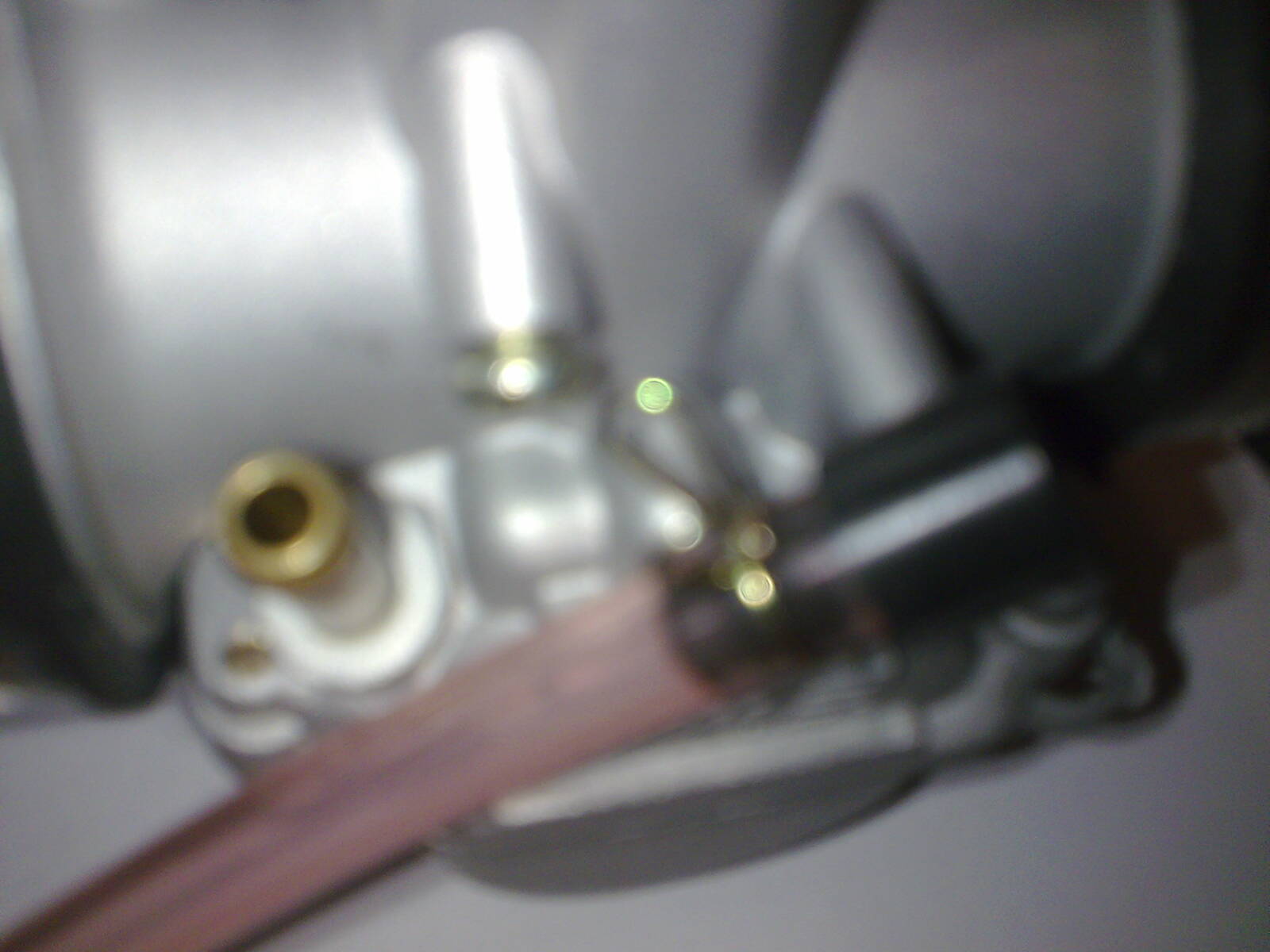

Quick play after work tonight, material is black acetyl which I had lying around
Hole is 3mm like the vent & hose is located for 10mm, drilled 5mm until broken into vent diameter. Pushes onto original vent & can be turned to run hose where ever suits, shouldn't touch the muffler as its no wider than the float bowl
I may remake it at a later date so that it locates further onto the vent
Sorry for the lack of clarity, sent from phone to email which loses detail. Will see what happens if I use the usb cable
Edited by tony27

That'll be the mark 2 version if it turns out the hose is needed. The hole for fitting over the vent will have to be either stepped or a electrode made with matching taper

Can you work out if the fitting will push onto the vent, trim the extra off so the start of the bend is at the end of the vent & you'll have something very similar to what I made. Best thing with thin wall plastic is that generally it will stretch
Good news guys, I've just removed the adjuster from my dellorto & screwed it into the oko-same thread luckily. The original cable fits with maybe 1mm of extra freeplay
