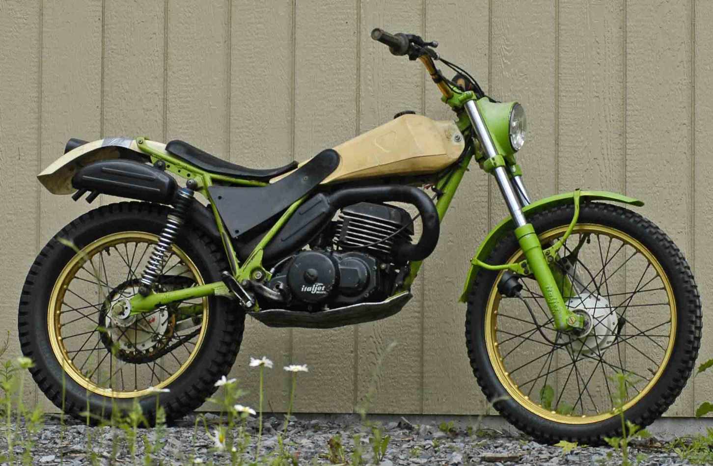

Well, I guess I should have my head examined but I just purchased a 83' Italjet 350T Piuma. The bike was left back here in the States after a world round. It is complete with the scrutineers marks on both hubs, engine and steering head. The paint dabs are scribed with the number 26 (Rider No, 26). I need a few bits and larger pieces to bring it back to being respectable. The mud guards, white tank, side stand and factory kick lever. During the round, the rider broke the kicker shaft as everone is well aware was a huge problem with these bikes. The shaft has been replaced which is a mirical in itself thanks for a doner Italjet being parted out on ...."the bay." So if you know of anyone with the elusive "kermitt" parts, I'd be forever greatful.

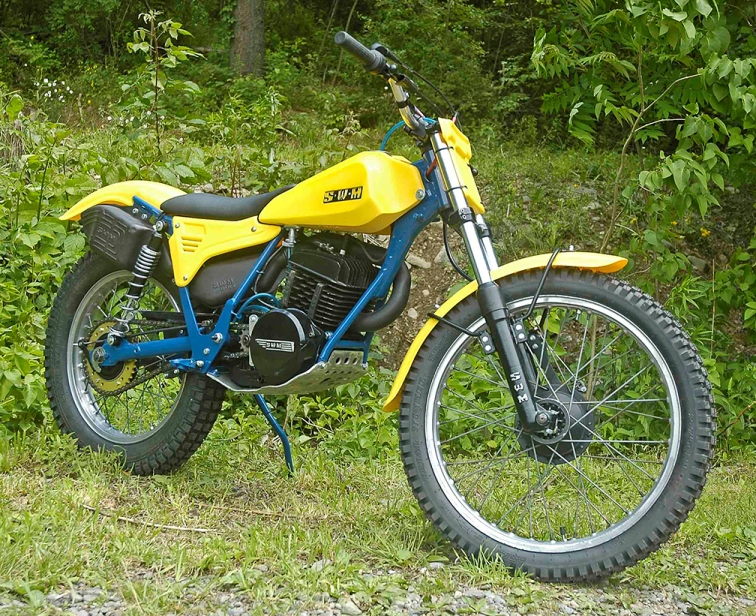

The good news...the SWM is in fantastic shape! Here are a few photo's.

Some interesting colour schemes! Nice bikes though, thanks for sharing.

The tank has gone yellow due to the fuel effectively vapourising through the plastic! That is why yamaha genuine decals have a foil backing to stop the decals bubbling and peeling off.
Not many Italjets around in one piece nowadays, most have been parted out as you call it states-side!
The SWM looks neat!

Thanks Steve and BigJohn. It seems like "parting-out" is all you see anymore back here in the States. I guess everyone figures that the parts are worth more than the bike. You are correct regarding the tank. The problem that I have besides the yellowing, the plastic has broken down and is seeping through. The tank is not damaged or split it's just no longer sound. I have been researching and hoping to find a sealent of sorts. I have had some luck in the past with sanding the tanks and then heating and polishing them. This tank is to far gone. I have tracked down a green one from an earlier year but I'd like to stay with the white.

I did see that, sounds like a good a plan as any, except with the addition of the Blue Lightning. The common problem I read about is people who don't line the tank have problems with fumes leaking through and bubbling the paint. I have also read that you can use a hot air gun on the tank after you have sanded it.
