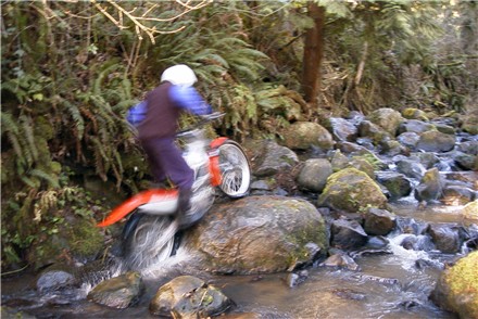

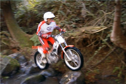

The bike was spot on, shame I couldn't say the same for the bugger taking the photo's, out of 13 pictures these where the best two.

We where riding slippery streams, banks, and rock sections all about the level I would ride in club competition, I did ride the bike like it was my own and wasn't nervous about scratching it or falling over.
Thanks to Dennis Sweeten, pictured below, owner of Apex sports, for letting me come along and give the bike more than a parking lot test ride, I didn't even have a bike to wash when I got home :)
