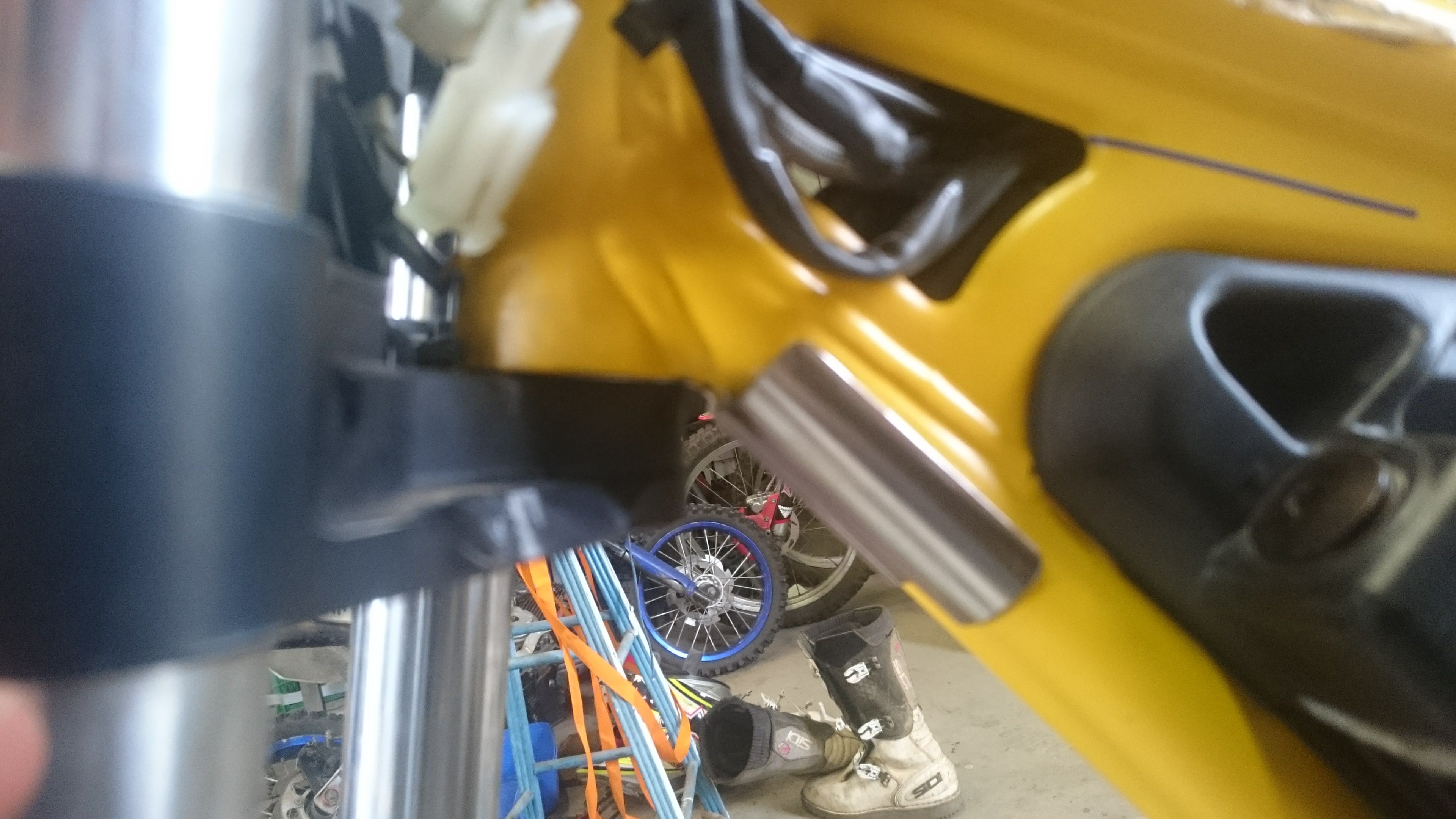

May 29, 20188 yr Dragging up an old topic, but seemed better to keep this all together rather than starting a new one. My 2013 Sherco has the factory installed plastic stops and the chamfered lower fork clamp - and still got a dent in the frame. The plastic stops are OK for the minor damage from turning to full lock, but not for bigger offs. The fork chamfer doesn't quite match the angle of the frame, so still a point contact, at least until the frame dents to match , it also seems to have the effect of pushing the plastic stop up and out of the way in a hard impact. I have removed the rather useless plastic "paint protector" and replaced it with 2 inches of half section 1" stainless tube siliconed to the frame. Using silicone allowed me to sit the tube so it aligns with the chamfer on the fork to spread the load, and provides some clearance for the stainless to dent a little (and absorb some energy) in a big crash without damaging the frame beneath. Not much time on it yet so still to be proven, but I'm optimistic. I think it has increased the turning lock very slightly and I reckon it looks pretty good too. Sorry about the blurry photo, didn't notice it was blurry until uploading it here. Edited May 29, 20188 yr by bikerpet

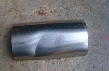

October 16, 20188 yr An update on my homemade stainless frame protector/stops. I sent the bike for a fairly significant un-piloted flight today - got off lightly with a dented tank and forks needing a re-alignment. The protector/stop in the photo above now looks like this: The frame underneath it looks to have sustained no damage (there was a small dent from when it had the useless factory plastic stops, but it looks the same to me). I had a couple of mm of silicone holding it on and acting as padding, that was split and peeled under the impact area. Only a few minutes to peel the old stainless off and silicone on another, this time I think I've done a better job getting the stainless sitting squarely on the fork clamp chamfer (as you can see this one still got hit hard by the sharp bottom edge of the clamp) hopefully should work even better next time. Edited October 16, 20188 yr by bikerpet fixed the photo
