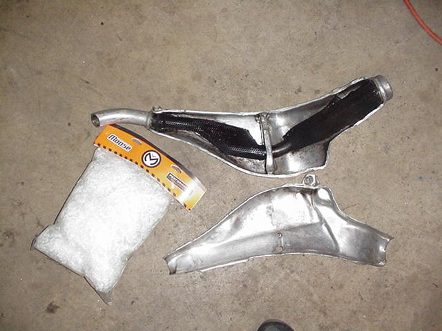

January 25, 200521 yr dabberI've took some pic's for you and put them up on trialstalk if you want to have a look Click here Hope this helps Chris Tasty weld.

September 26, 200521 yr Anyone cut and repacked their silencer without making it look like a dog's breakfast?pictures? <{POST_SNAPBACK}> See my post : The french Sherco exhaust repacker --> Patoche

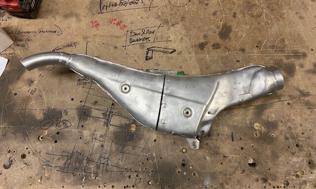

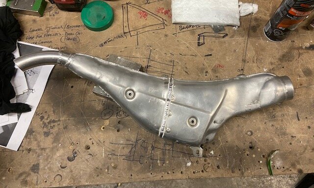

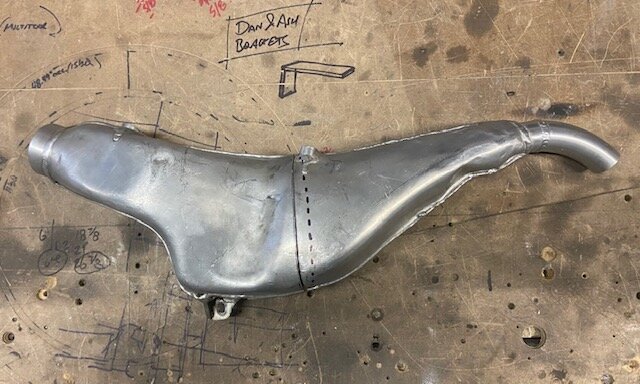

February 18, 20233 yr I hate bringing back a thread that's what, 18 years old now? I really appreciate the detailed pics to give me the confidence to cut this piece of unobtanium in half. Cheers Chris! Here's my attempt on a 2005 0.8 exhaust. I drew a dotted line in Sharpie where I should have cut, as I managed to catch the flanged lip of the baffle, separating the two halves. I tacked the baffle back in place before welding the two halves back together. I honestly thought I took more pics, for those who still own these old Sherco's, but suffered a bit of a brake cleaner induced brain fart while in the process. I used some high temp. ceramic insulation for the repack, and it seems to have quieted the exhaust a little. It is a definite improvement over the oil soaked remains of the old insulation. Edited February 18, 20233 yr by diagnosis Misspellings and other errors.
