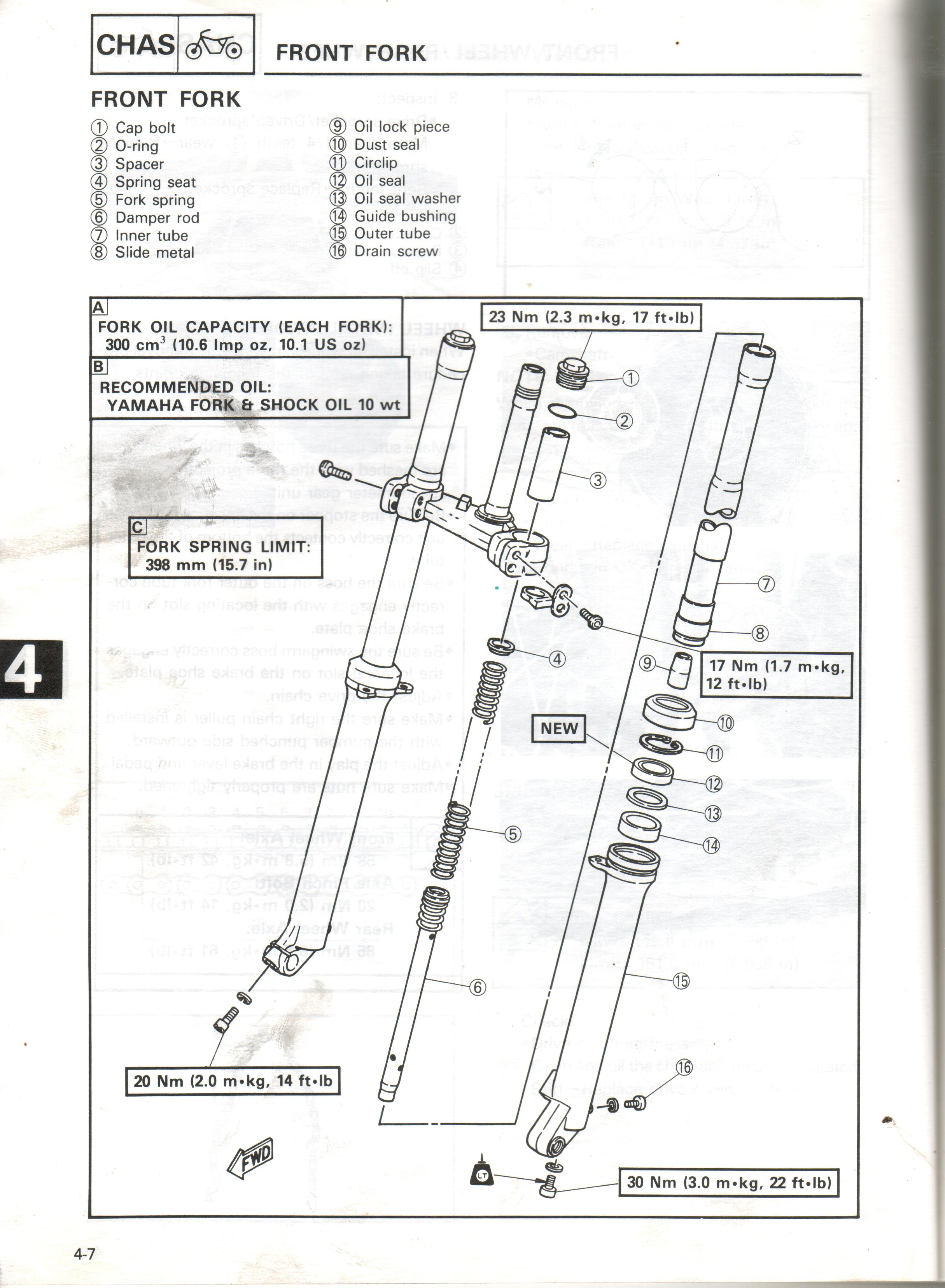

Diagram of front forks :biggrinsanta:

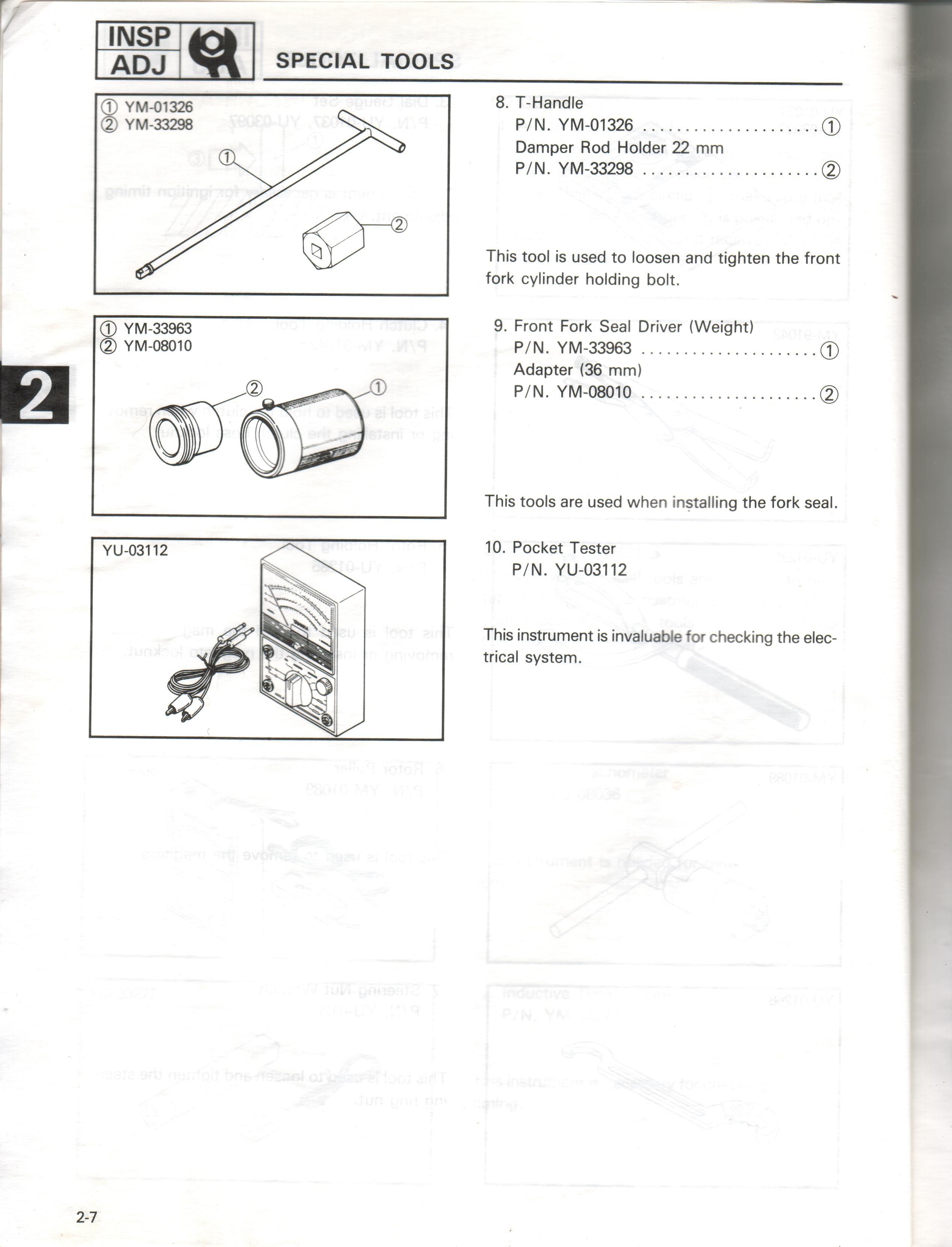

I think this is the holding tool :frosty:

Actually i'm swaping a damaged chrome stantion for a better one but all the postings have been helpful. I have an air wrench so will start with that but am thinking of making up a tool. I assume the reference to 22mm is across flats?
