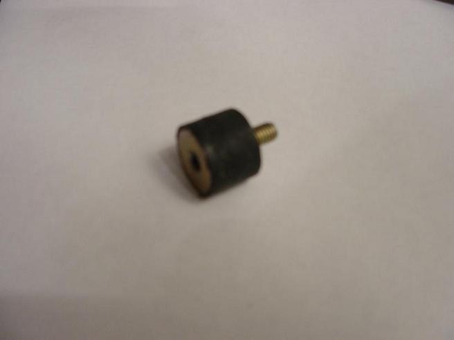

bob...I THINK the rubber mounts your on about are the same as the one on the rear silencer mount Rev3
On the rear silencer mount, this rubber thing with bolt on one end, is called the "silent block"
I will try to check tommorow, if they are the same item on the radiator, and if so I'll also try and post a picture of a new one I have in the house here.
Yippee....I'm right...that dont happen much! :( ...now if only I could get my riding right!
I'll try and post a picture of the silent block later bob :D
COOL ..now I know the real name..always thought SILENT BLOCK was a bit weird..but BOB..if you order one from a dealer..it MIGHT be usefull to say silent block since that is the name on the Beta parts diagrams.
Anyway..it might not help much..'cause its not a great picture..but here is a metalastick!!

bob..sorry I missed this post for a couple of days. Cant help you with advice on the header pipe either sorry...but I can say that you'll have to telephone BVM to complete an order, and the silent block, isnt on their website..so just give em a call...they usually have some in stock.
